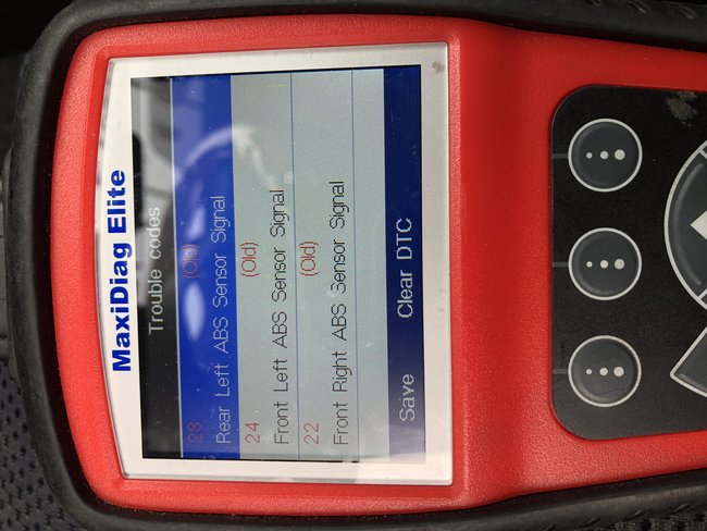

Bought the car listed above sti model, which has ABS and brake lights on, has these codes. Is it possible all are bad and were just ignored?

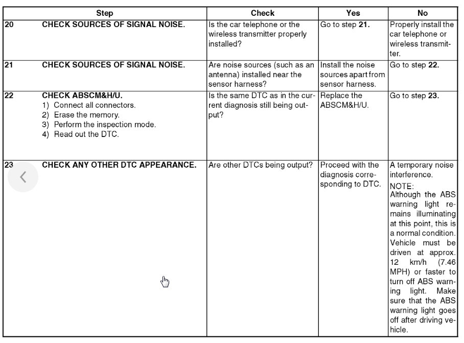

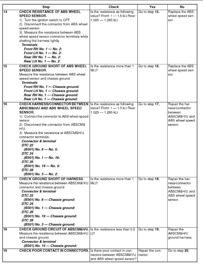

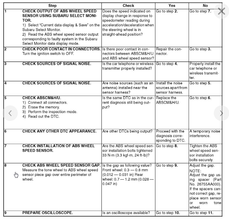

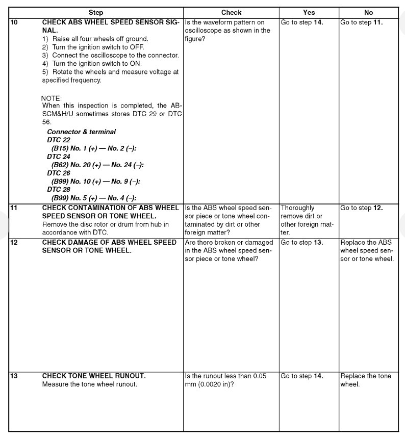

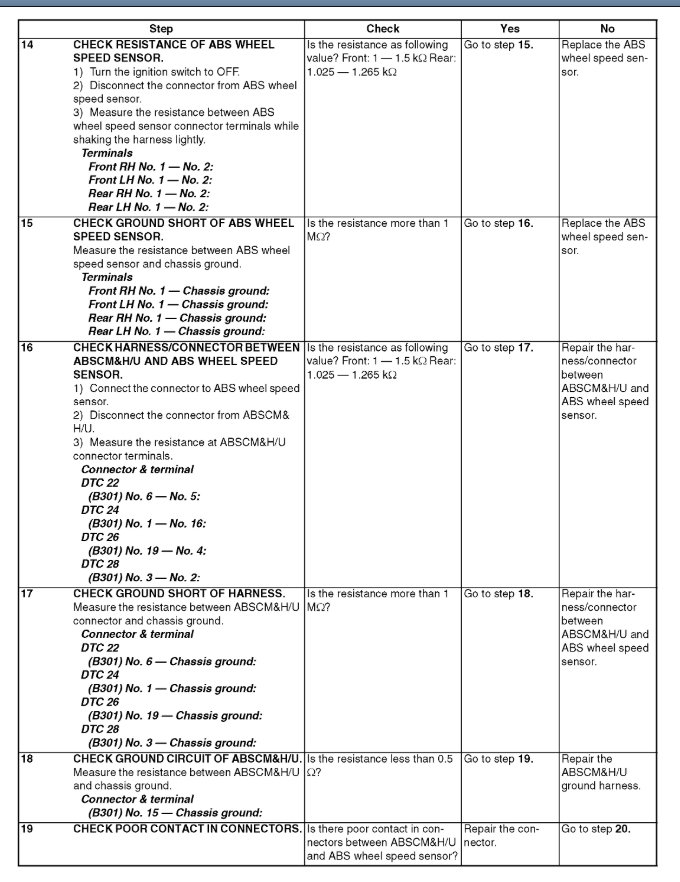

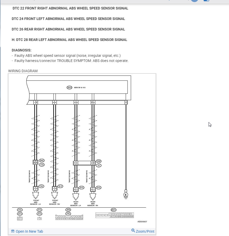

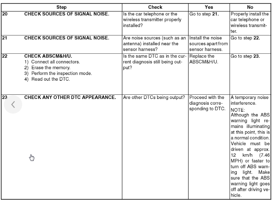

Normally not. Normally this is indicative of an ABS module issue. However, they are all related and the OEM has included them in one test which I attached.
We need to run through the test just to confirm the issue. Clearly there are other issues and possibly each one has failed but again, highly unlikely. I fully expect you will find one issue causing all these codes.

They talk about gap adjusting. is that using the spark plug gap? Because i saw a couple of them in the glove box.

Yeah. The wheels will not effect this because the wheel speed sensors run off a sensor to a tone wheel.
The gaping does matter but you would not use a spark plug gap tool because it is a different style gaping. You would actually use spacers/washers on the base of the sensor to increase or decrease the gap.

I just got a chance to drive it and live data shows rear ones showing speed while fronts are not.
Apr 20, 2020 at 10:11 AM
Interesting. It is unlikely that both would fail but it is possible especially if this vehicle is new to you. They probably did not fail at the same time. They were just never fixed.

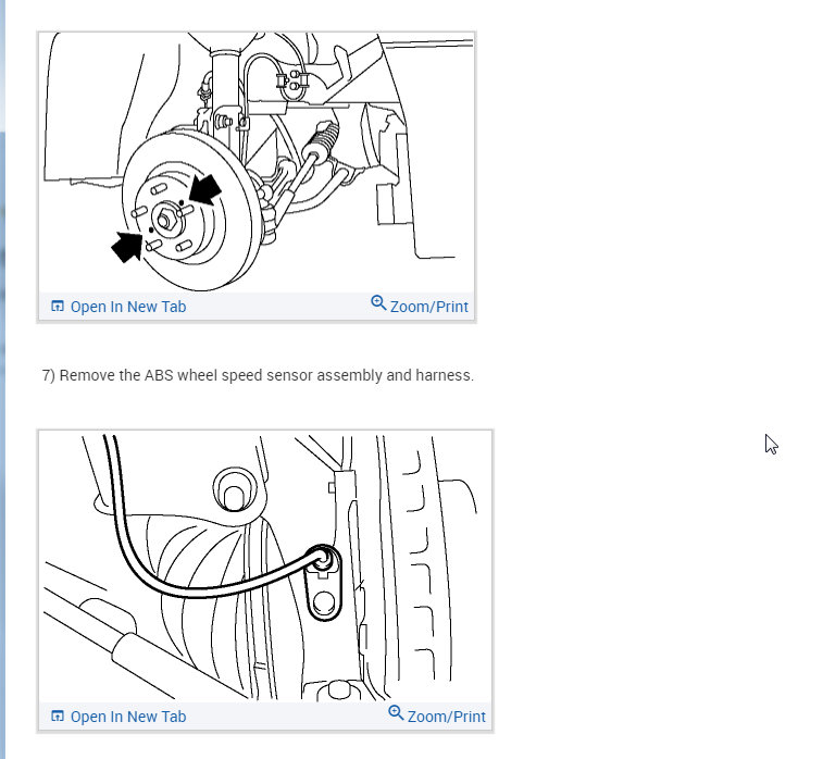

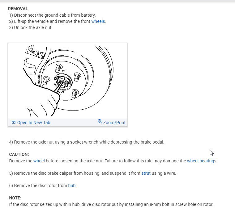

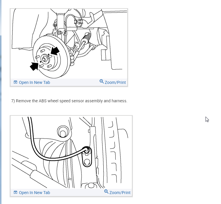

I attached the process but I doubt you need to remove much as you should be able to see the speed sensor on the hub and remove it with just taking the tire off.
Clearly I would inspect the sensor first to make sure they are there and connected. If they are replace them and retest.
