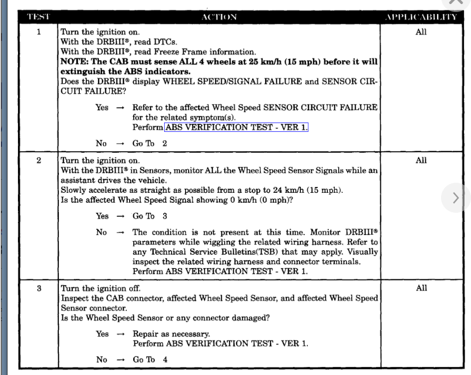

This morning the Amber ABS light came on. I checked with my INNOVA 3160 w/ ABS-SRS.
The actual codes read:
06
1) Crash Zone Sensor
2) Left Rear Wheel Speed/ Signal Failure
First, my scan tool is limited. By Crash Zone Sensor could it be referring to one of the front L+R (bumper) frame sensors? If so, aren't they part of the SRS system? I have no SRS codes. I cleaned and reseated all the pertinent connectors. With my scan tool, I can clear the codes, but between 5-10 MPH, the ABS light comes on again. My tool doesn't show B, P, or C codes. Turning the ignition key on/off 3 times shows no code. Any ideas??? And thank you!

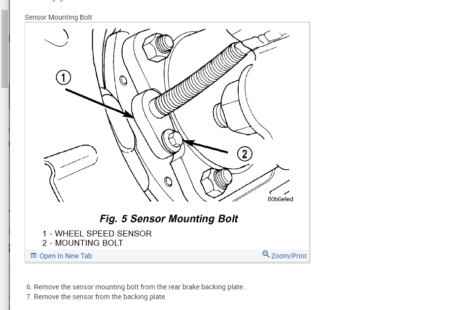

I think you are exactly correct. I would not worry about the crash zone sensor issue because that is not going to turn the ABS light on. You have a separate SRS light so if that is not on then I would suspect that this is a scan tool issue.
Here are a number of testing and guides that will help with wheel speed sensor issues:
https://www.2carpros.com/articles/abs-wheel-speed-sensor-test
https://www.2carpros.com/articles/how-to-replace-an-abs-wheel-speed-sensor
https://youtu.be/rTtAnsOlZU4

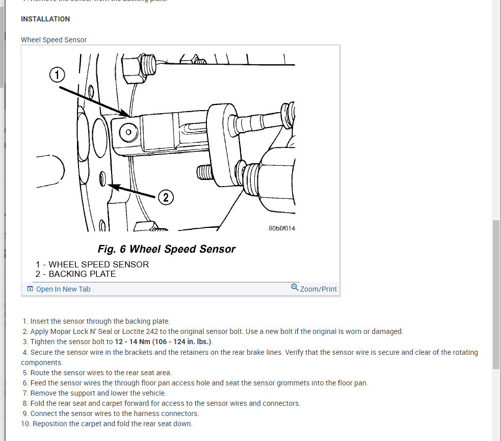

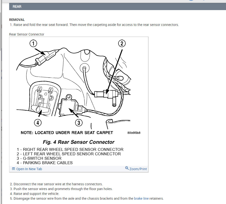

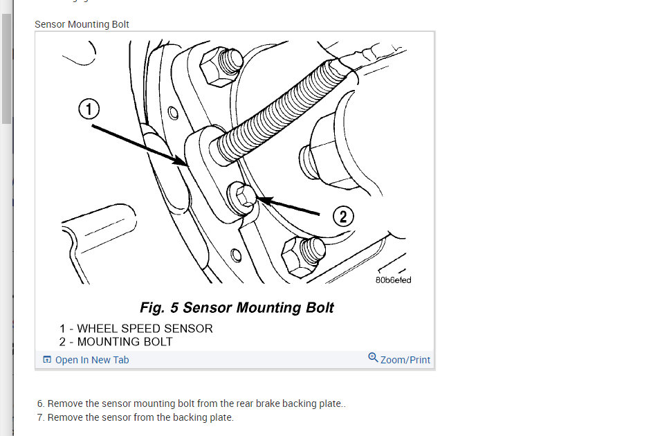

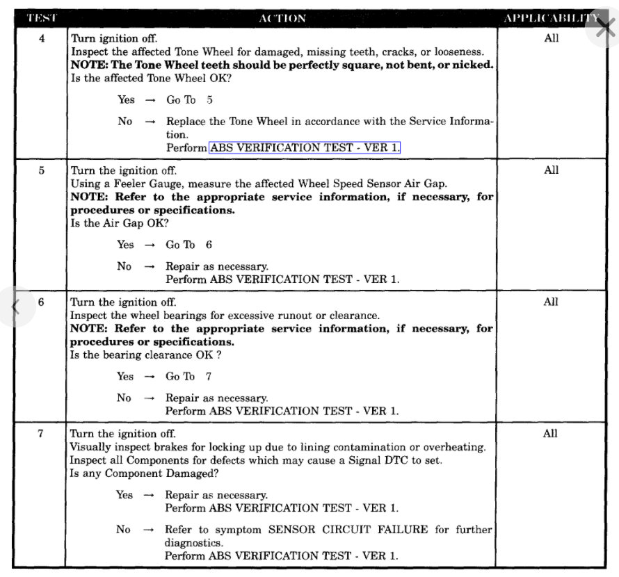

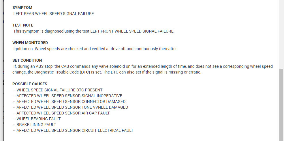

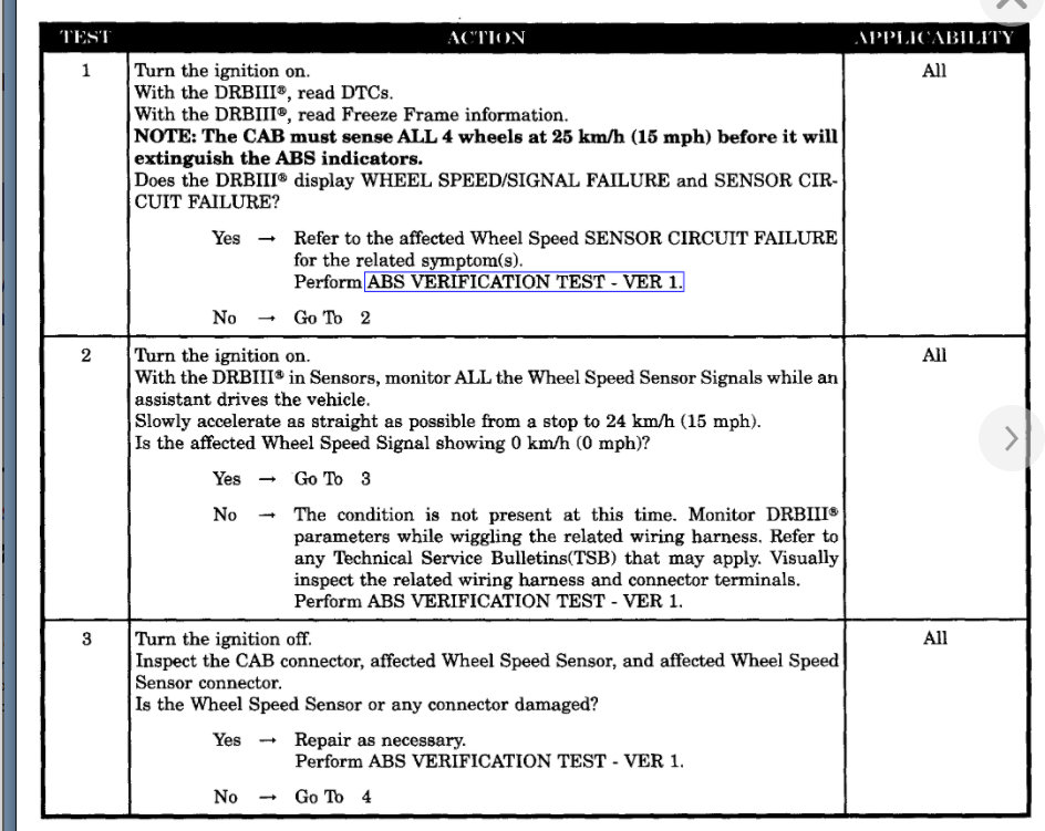

I am also attaching the info below from the manual on how to test and replace the wheel speed sensor if this proves out. This testing is for this failure but I suspect the sensor or hub is the issue since you have to be moving before the light comes on.
Please run through this and let us know what you find. Thanks

Did you ever work under a vehicle when it was pouring rain, and were drenched from the waist to the toes? I’m sure you have. The $50.00 wheel sensor fixed both codes. That crash zone code was bull****, some type of ghost code error and obviously what you get with an improper scan tool. At least my OBD II could erase the codes once corrected.
Test drive with no ABS light. Thanks much for your suggestions and tips. Time now for some dry clothes!
