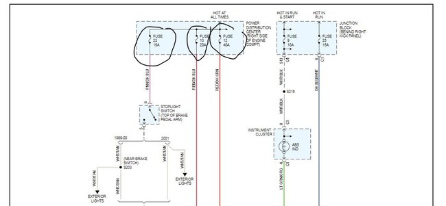

I scanned it no C code was found but only code i got is:
9-ABS motor not working properly
Erased it then re scanned it and i got the same code.
Where should i start and what should i inspect?
Your help is highly appreciated.

Good morning,
Do you have a scan tool that can monitor the ABS system? You will need this.
It could be the ABS pump but needs to be confirmed.
As far as the code, can you give me the code number from a scan tool? It should start with a C and then a number. A parts store will read it for free. Once you get that format, I can help narrow the area of failure.

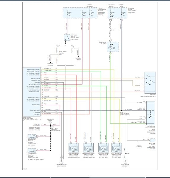

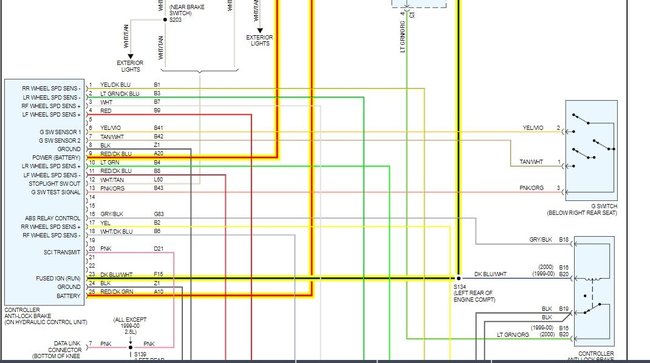

Check the fuses that I circled in the diagrams I sent you.
Make sure they have power on both sides of the fuses.
Then test for powers to the control module as well.
