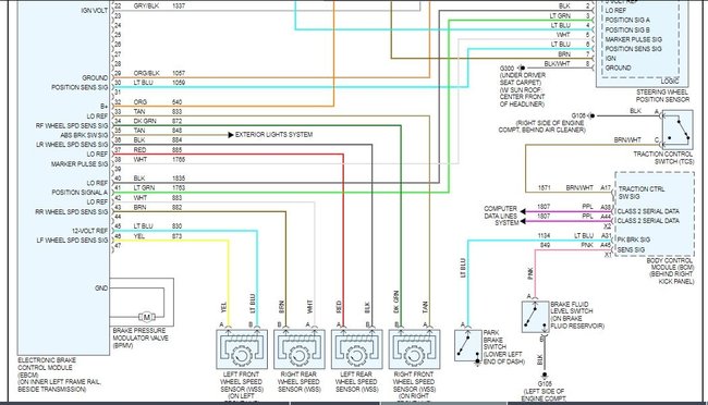

Driver side wheel locks up.
Jan 9, 2020 at 2:10 PM
Good afternoon,

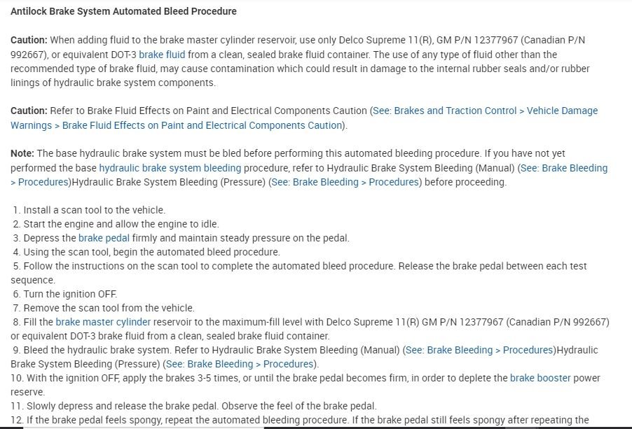

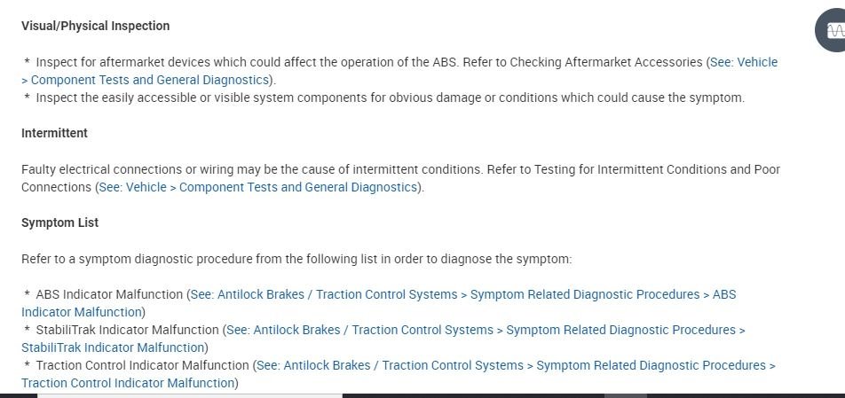

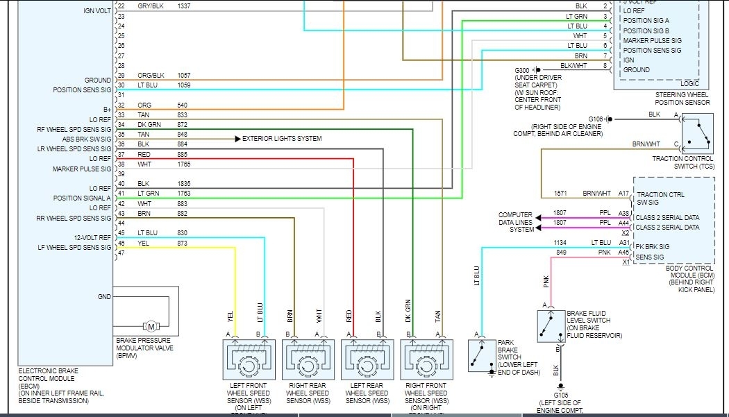

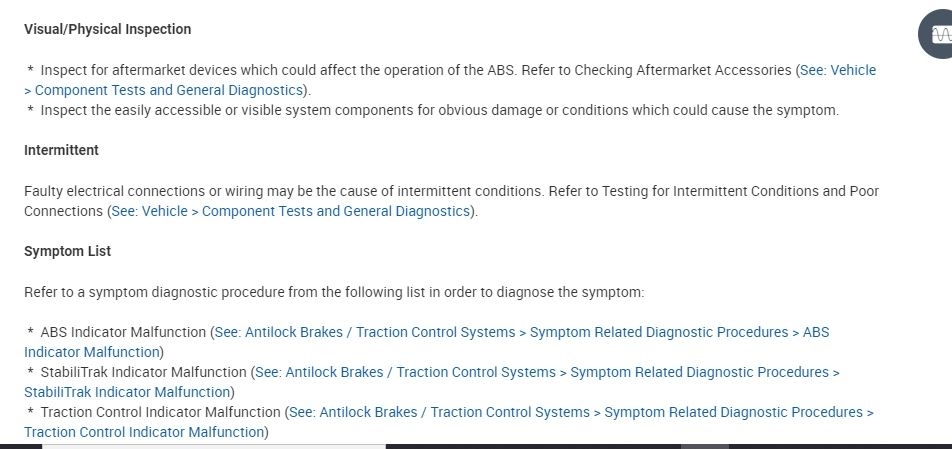

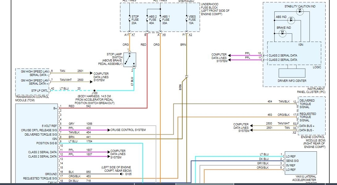

The ABS is a separate system from the regular braking system.
If the light is on, I need the fault code stored.

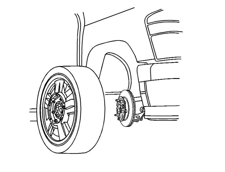

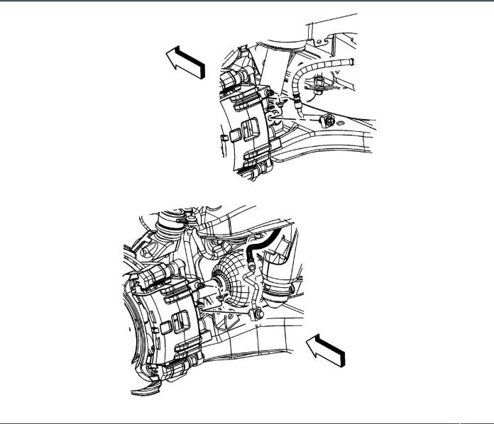

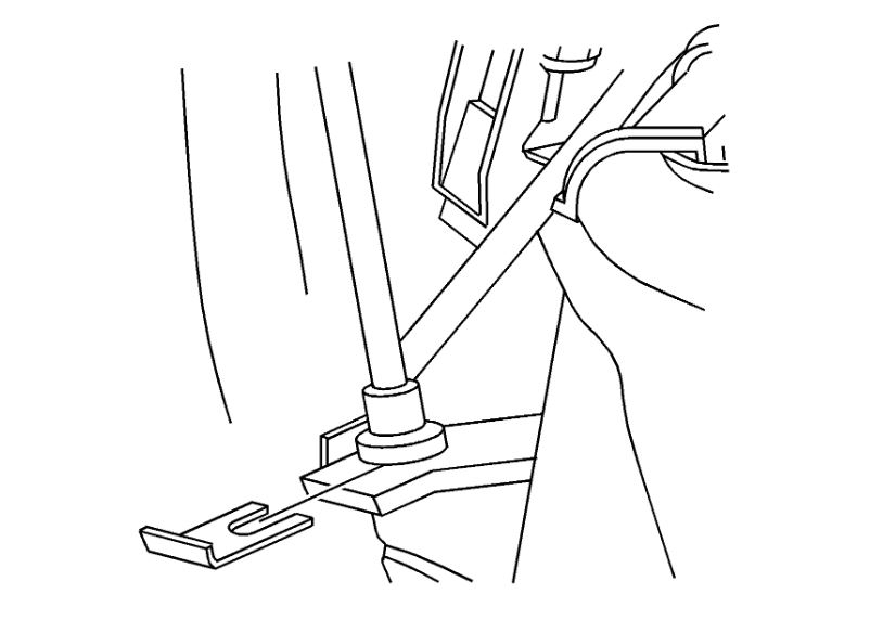

As far as the wheel locking up, I would check the caliper and the brake hose to make sure the caliper is staying applied after you brake.
https://www.2carpros.com/articles/brake-caliper-replacement
I attached a description, diagram and the brake hose below for you to view.
