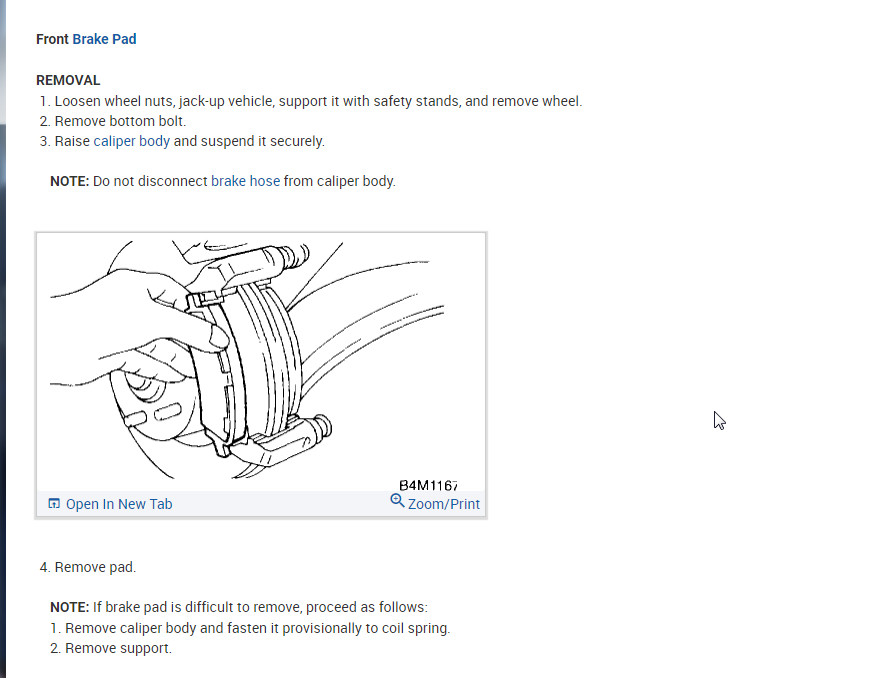

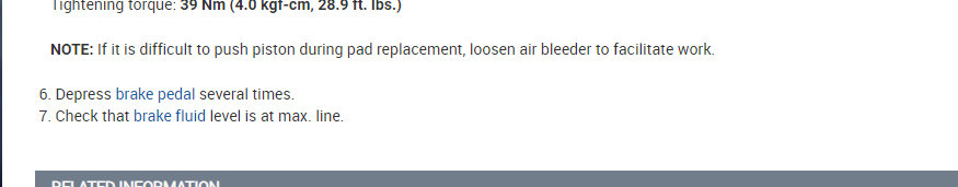

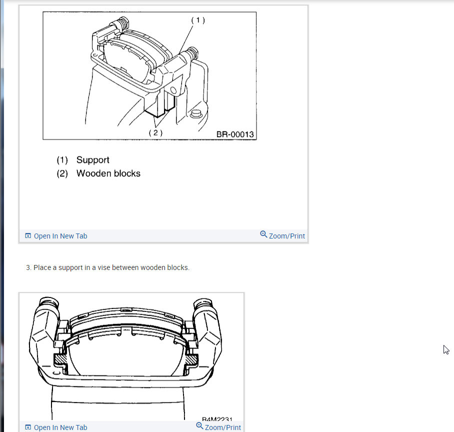

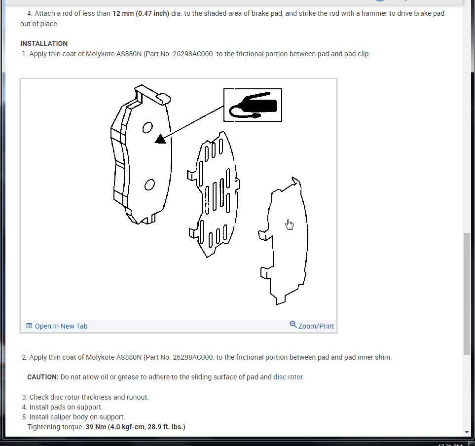

I attached below the process on how to replace them but let's try this process first. I suspect it will be just fine since you seemed to see an improvement as you pulled back in the garage.
