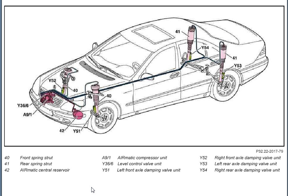

One year ago I have changed the ABC hydraulic struts to normal one, nothing else been changed and it was something worse, again I returned back the ABC Hydraulic and checked for any leak but seems everything is okay.
Now the car is raising up in full but when I switch off the hydraulic the car comes down front in full with the warning red light comes on, the back side remains up in full, changed the oil but still the same.
If I drive the car with the switch on for test the car front raise up but for few yards again front comes down while driving and when I stop the car, front raise up itself, this happen while driving repeatedly.
Looking for suggestions from your side please.

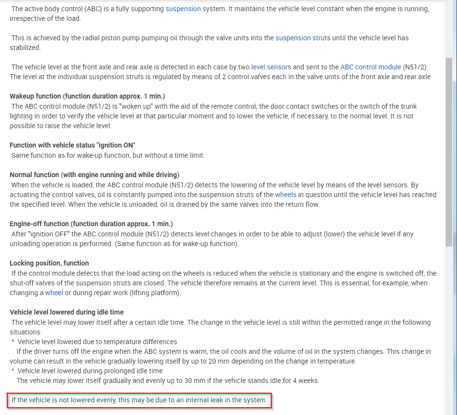

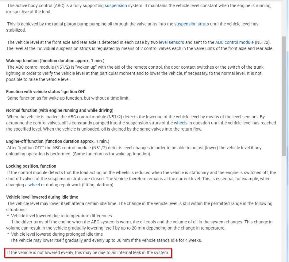

You have an internal leak in the system. Basically the circuit to the front struts has a leak somewhere in it that allows pressure to bleed back to the reservoir.
More than likely the issue is the control unit that is part of the pump/compressor. This is what directs the fluid to each strut. The fact that the front goes down evenly and there are no external leaks then that means it is not a single strut or line. It has to be something that both have in common and this is the control unit.
Look over this material and let me know if you have questions. Thanks
