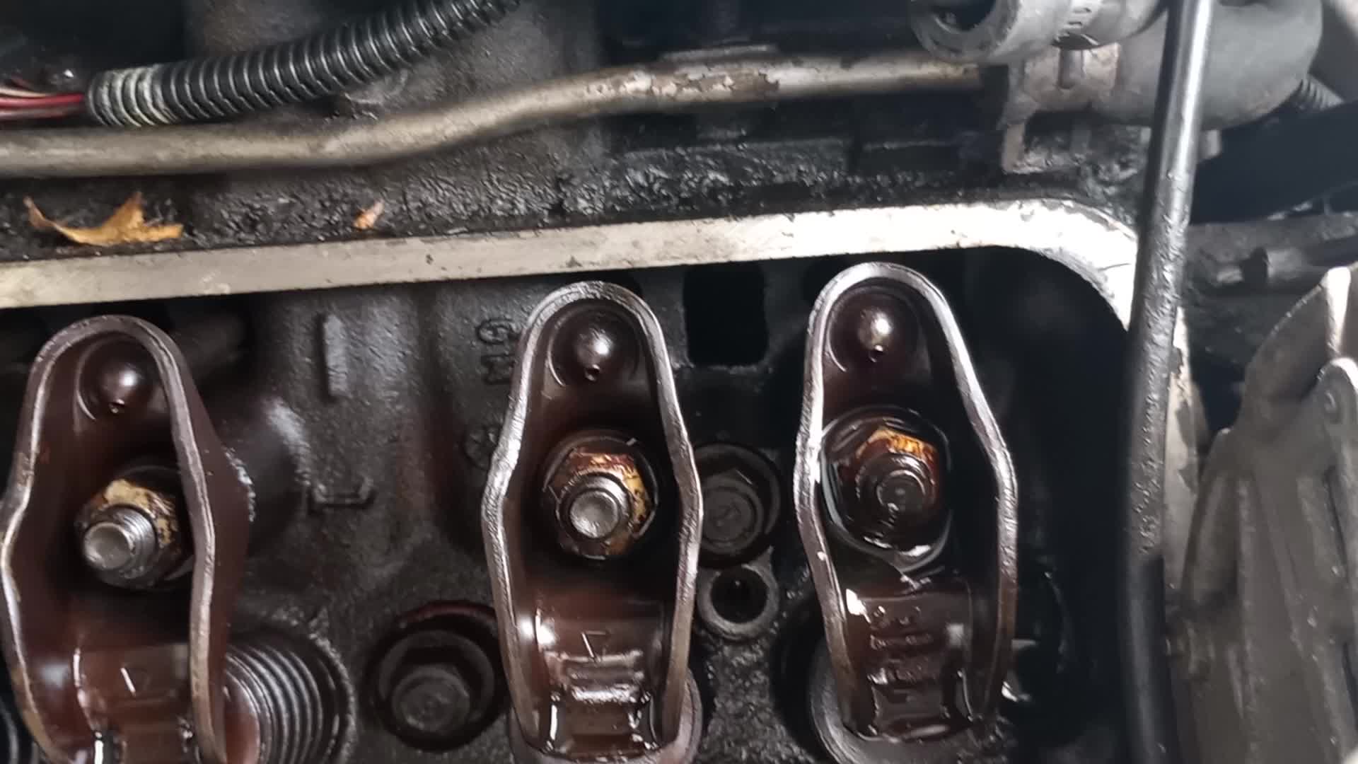

I have the car listed above Classic. It has a popping sound when idling coming from one side of my exhaust, and it pops a lot more when I go to accelerate and barely goes. it won't go over like 40 MPH, and it takes a long time to get up to 40 MPH. I've changed the plugs, TPS, and took the catalytic converter off. I've checked my fuel injectors and my fuel pressure. I'm stumped here.

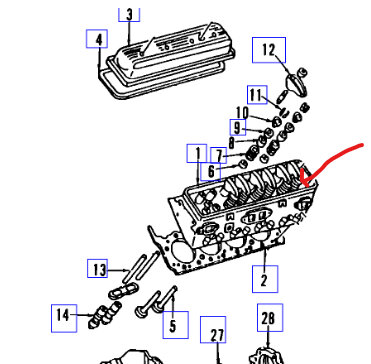

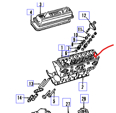

Thanks for the video. it does sound like a broken valve spring, or the valve train has fallen apart, you can remove the valve covers for an inspection. Use a flashlight it helps with the inspection. Please check the image below to see what I am talking about.

  • 54,832 POSTS
Please do, if you find something you have a question on please upload an image a short video.
Sep 5, 2023 at 10:44 AM
CJLOVELESS
  • 6 POSTS

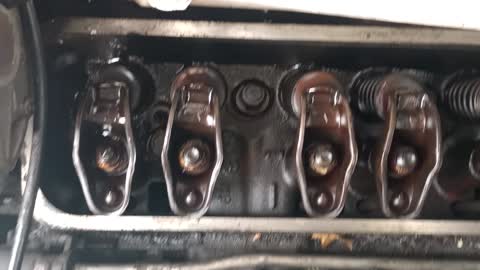

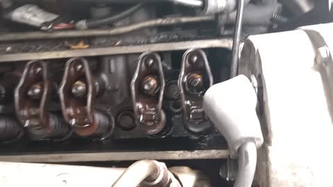

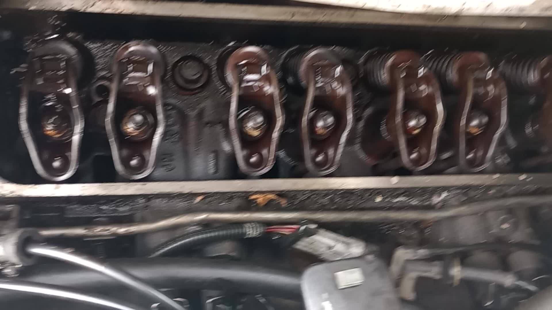

There is a lot of oil shooting out of the 1 and the 3rd on in the passenger side going from right to left.
Sep 13, 2023 at 1:09 PM
  • 54,832 POSTS
Wow, you are not kidding, thanks for the video. It looks like the engine has a spun bearing which is affecting the oiling of the engine and making the noise. You are going to need to remove the engine and disassemble it to find the problem.
