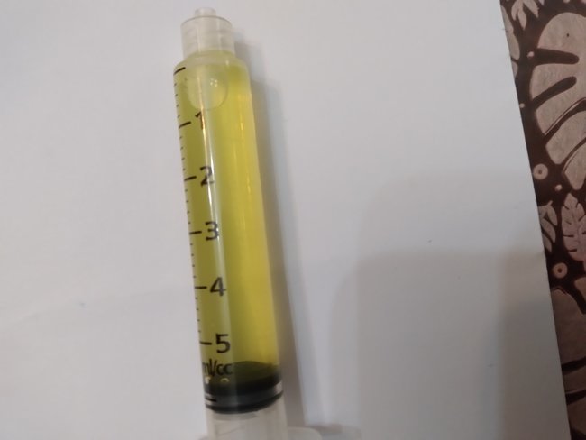

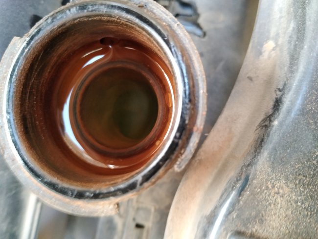

Hello Mr. Sean,
I change engine coolant every 6 months. Last time (3 weeks ago) I changed it, though the old coolant has not been bad. However, I'd rather to not leave it more than 6 months, as my car is old (Hyundai Matrix 2007). The same green coolant "Mannol G13" was added, as usual. But yesterday (after three weeks only of adding the new coolant) I found out that the coolant color has turned to brownish green. I got surprised because the engine temperature has not gotten high recently.
What could be the sudden reason for that?
Saturday, March 26th, 2022 AT 5:33 PM

Having corrosion build up inside the cooling system can turn the coolant into that color. If you would share some pictures of the coolant color.
Since this is a different issue than the oil, please open a new thread.

Knowing that my car was subjected to high temperature a year and half ago, but without harm to engine components. Yet, there were remaining residual corrosion particles on radiator internal surface.
Friday, April 1st, 2022 AT 7:39 AM
SQM
  • 6,383 POSTS
It does appear to be corrosion. You might want to do a chemical test, which checks for combustion gases in coolant (which happens in the event of leaking head gasket).
Here is a helpful video:
https://youtu.be/5zpNjYmmiYY
Saturday, April 2nd, 2022 AT 8:46 AM
EMAD1964
  • 17 POSTS
The fluid color is green.
I have a syringe full of it. I filled this syringe from the radiator now.
Saturday, April 2nd, 2022 AT 1:42 PM
SQM
  • 6,383 POSTS
The fluid color does look normal.
