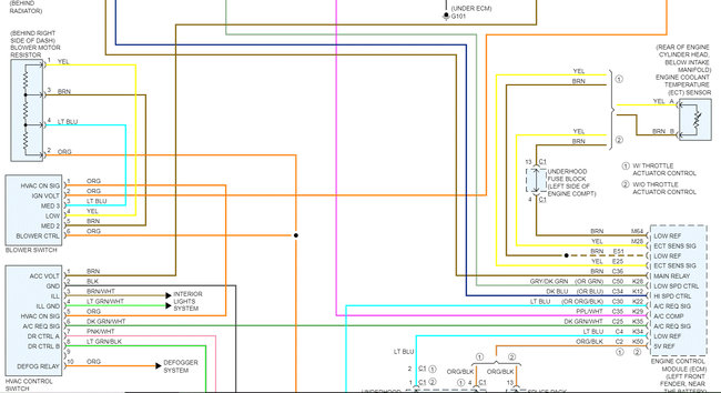

I am having to replace the entire A/C due to being wrecked in the front end. And there are 2 wires not plugged to anything and am needing a wiring diagram for the A/C to find out for that those two wires are for the A/C.

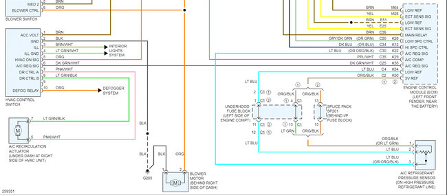

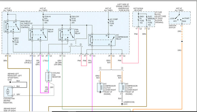

There are two different schematics. One is for a hatch back and the other a notch back. Since the notch back is more common, I attached it. If that is wrong, let me know.
I had to break the pic into three parts to make it readable. I did overlap them so you could follow them.
Let me know if this helps.
