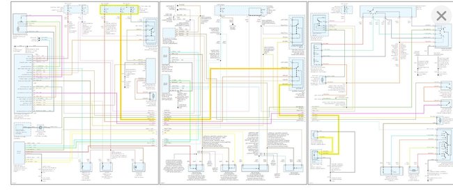

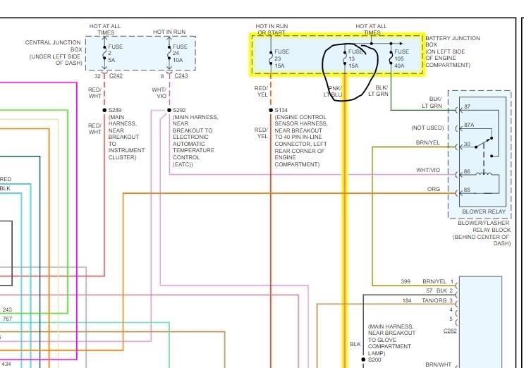

I attached a diagram for you. Check the fuse circled for power on both sides.
Jul 11, 2019 at 1:30 AM
