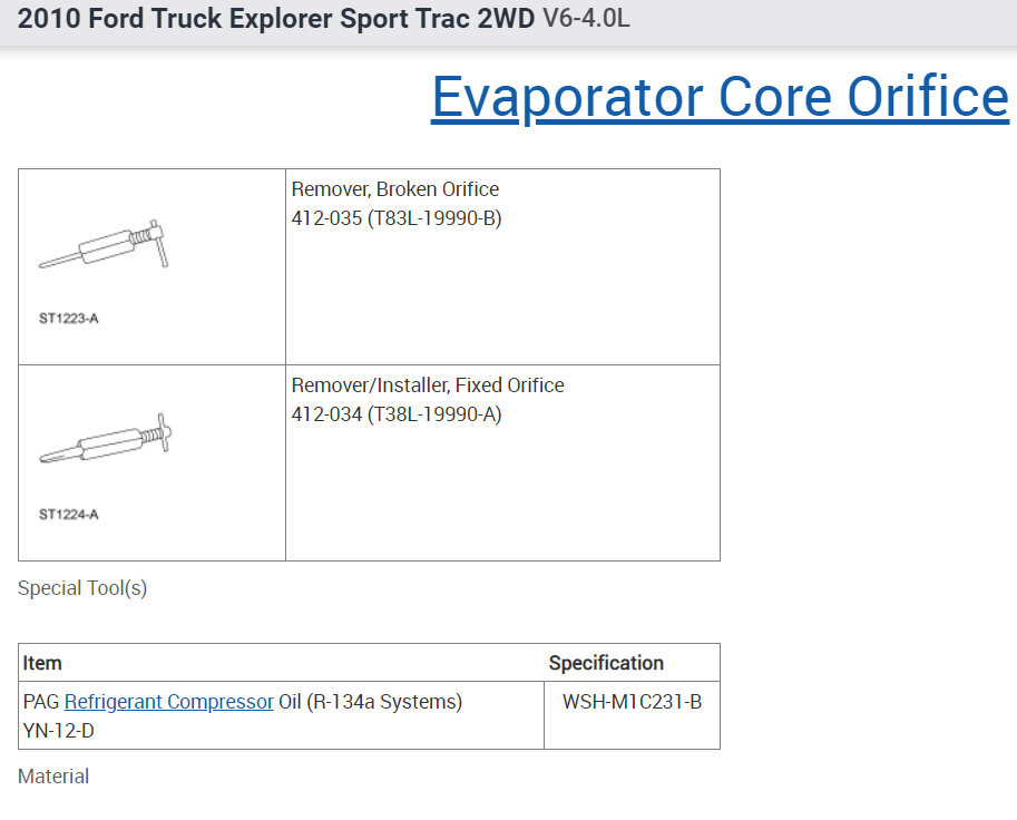

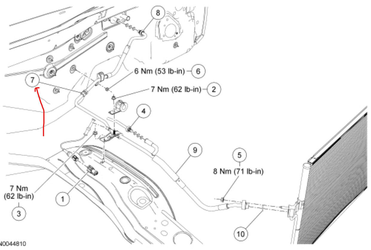

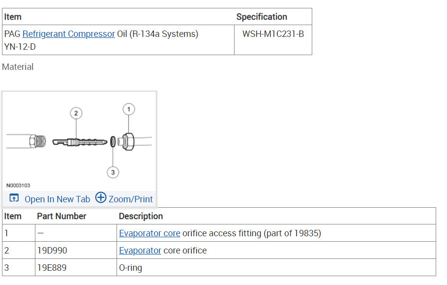

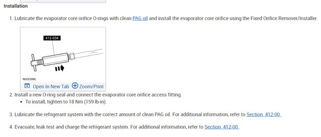

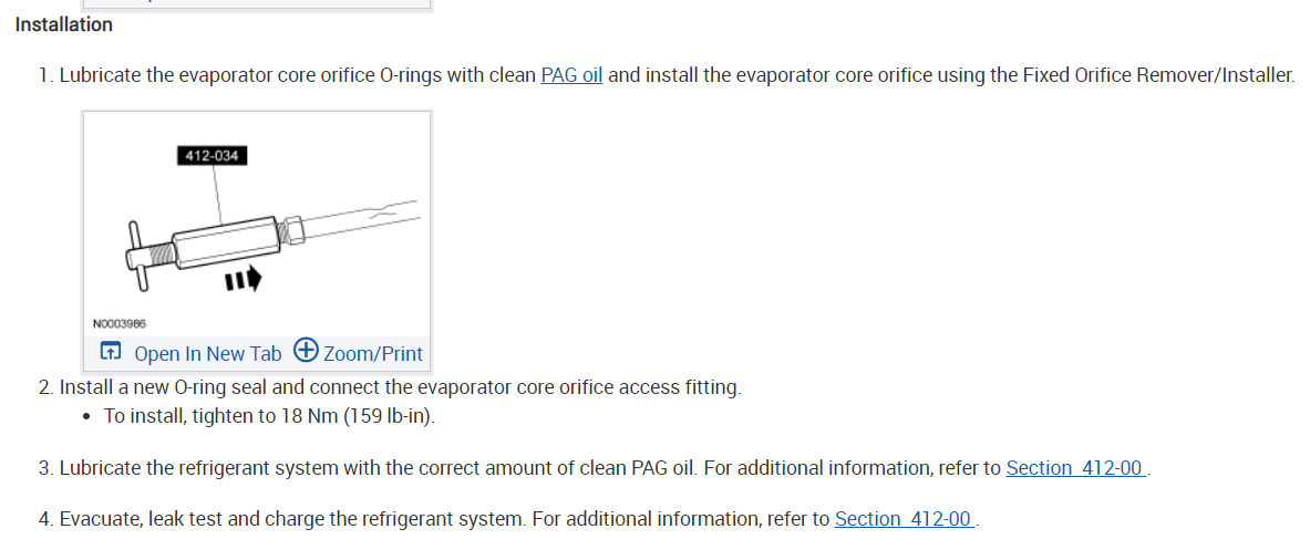

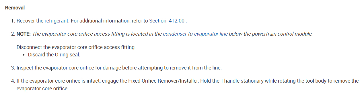

It does sound like the expansion valve needs to be replaced. Also, I have seen A/C systems hold their vacuum while not running and then lose the charge after the recharge because the front seal of the A/C compressor is leaking, I would like for compressor oil at the bottom of the compressor to confirm the failure. Another way to change is to charge the system and use a sniffer to check the front of the compressor. This guide can help, and I have the location and instructions on how to change out the expansion valve:
https://www.2carpros.com/articles/air-conditioner-leak-detection
This video can help as well:
https://youtu.be/4EqdrBVb0sY?si=GzUkeQJsJBmwIzRA
Check out the images (below). Let us know how it goes/
