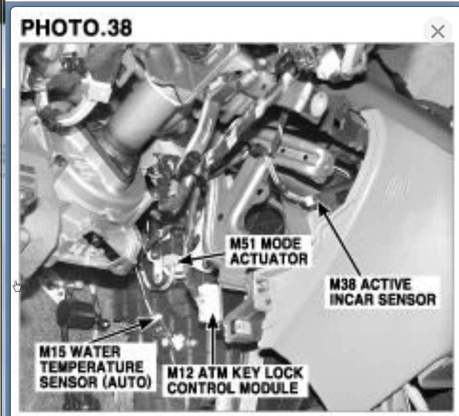

Hi, when I put my A/C on and I select the dash vent only I can feel the air coming from the feet vents. also, which ever position you select the selector knob I can feel
the air from the feet vents.
Is there a problem with the blend door actuator or could it be something else?
Dec 18, 2020 at 4:33 PM

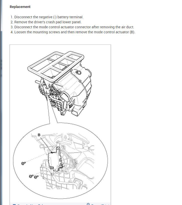

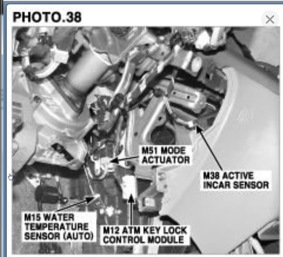

This is the mode door actuator that is not operating properly. Here is a guide that talks about this. Normally it goes to defrost only but this is only when it fails.
https://www.2carpros.com/articles/air-vents-stay-in-the-defrost-position
I also attached below the process from a manual of the USA version of this vehicle. We don't have a manual on this vehicle because it is not offered here in the USA. So this process will be close if it is not exactly matched to your vehicle.
Let us know what questions you have. Thanks
