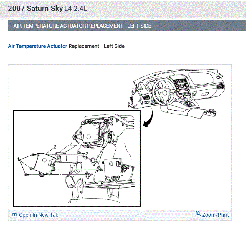

The climate control has either been really cold or really hot, not warm or in between temperatures. It's been like that for a while but now suddenly the A/C doesn't work at all and the car only blows out really hot air, no warm air even!

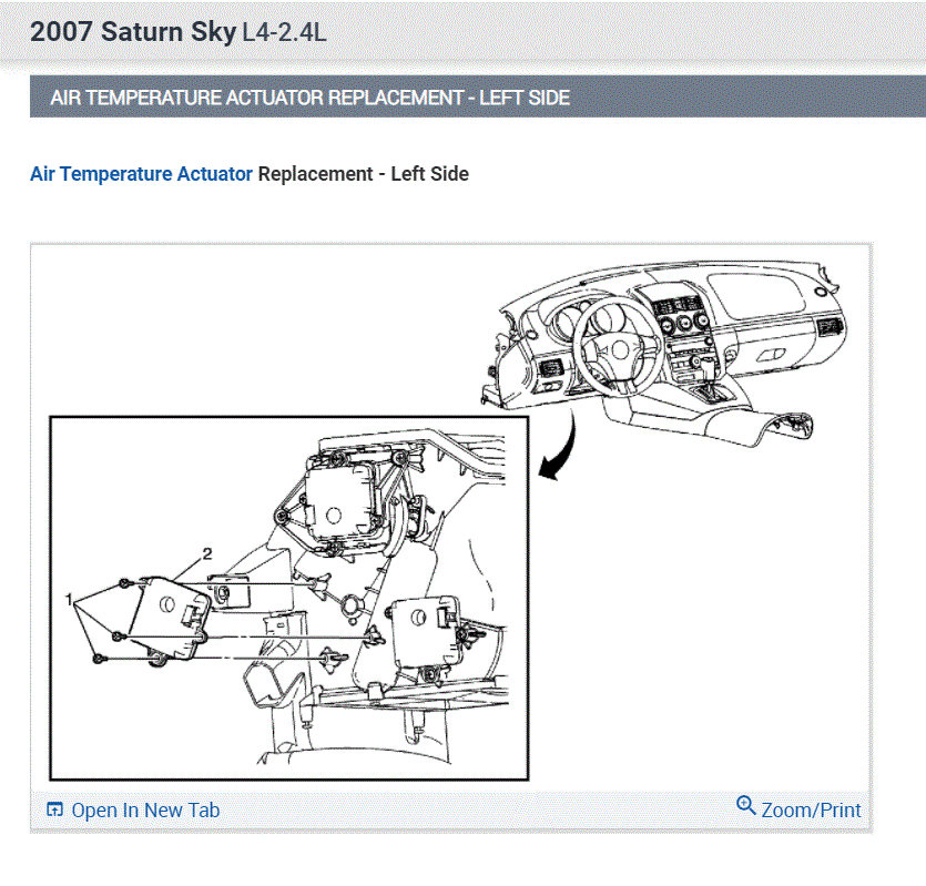

The air temperature entering the vehicle is controlled by what is called a blend air door. An electric actuator moves the door in different directions to either allow heat from the heater core to enter or cold from the A/C.
You indicated the A/C stopped working. Do you hear the compressor engage when you turn it on?
Also, there are two air temperature actuators in the HVAC module, though this vehicle is not equipped with dual-zone temperature control. Both work in sequence with each other. So, what I need you to do is remove one of them and while it is still plugged in, check to see if it responds when you change the temperature.

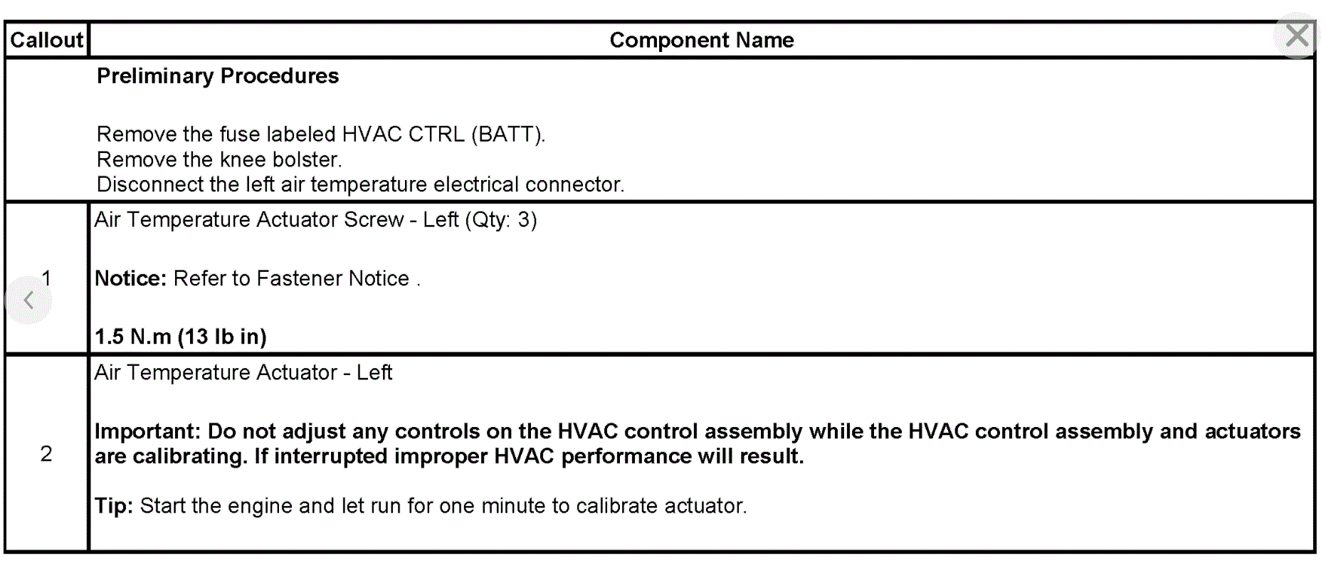

I attached the directions below for the removal of the left door actuator. Try the test I provided. If the actuator doesn't move, disconnect it from power and check to see if there is power to the connector when changing the temperature. Note that the power can be supplied via either wire based on the request. Basically, the polarity is changed to reverse the movement.
Let me know what you find or if you have other questions. Since you have had issues, I suspect one has been faulty for some time and the other just failed causing the new problem. Also, here is a link that you may find helpful for the removal and replacement of the blend door actuator:
Take care and Happy New Year. I'll watch for your reply.
See pic below.

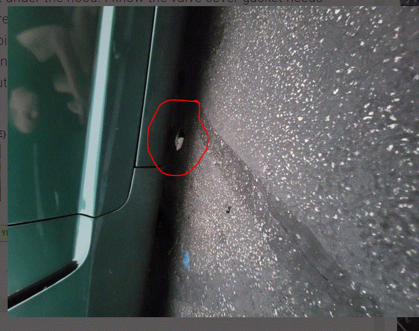

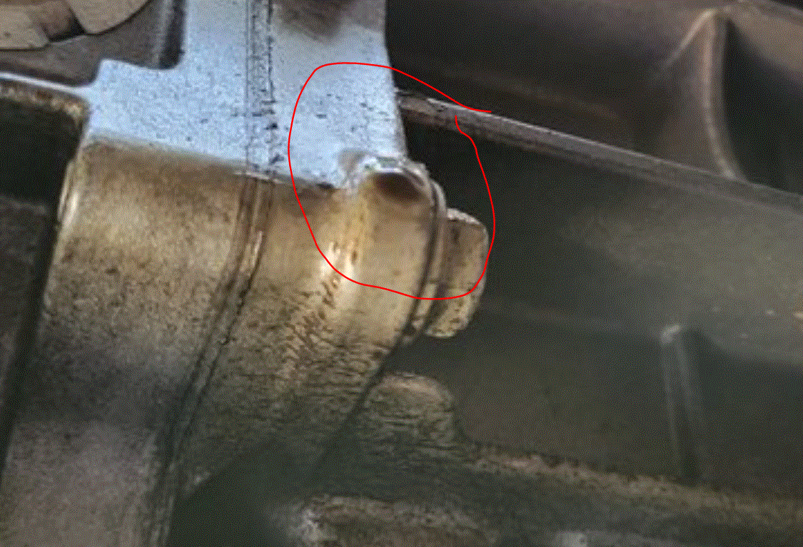

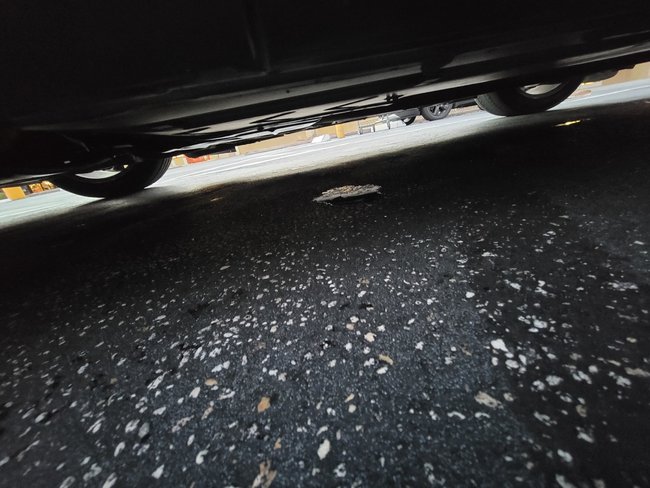

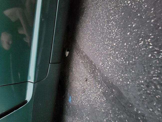

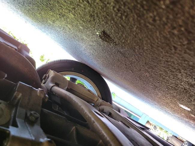

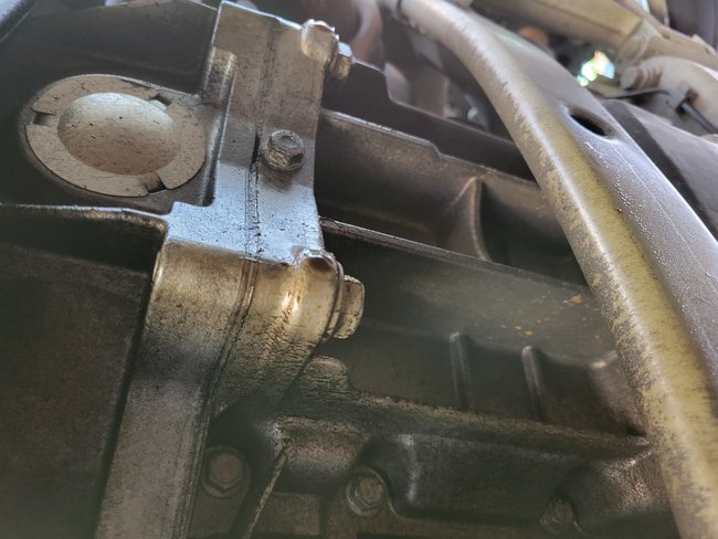

DAN PBADKNEE
  • 6 POSTS
That's where the leak is at! I've noticed it starts when I start the car and it will leave a little trail when I back up! Also, a belt that has been squeaking when I put the car in reverse but stops if I rev the motor or when I start driving. I'm not sure if this is related? I had the thermostat replaced a few weeks ago...but the motor seems to be running hot always! The temperature light has never come on, but it just seems hot under the hood! I know the valve cover gasket needs replaced and I'm not sure if that's related either? The liquid under the car seems to be water. It's not oily at all and I tasted it and it had no taste of antifreeze. Not sure if it's a Freon leak or something? I really appreciate your helping me try and figure this out! I'm not really able to afford to take the car to the shop right now.
Jan 2, 2022 at 3:21 AM
  • 110,240 POSTS
I attached two of your pics and circled one thing in each. Looking at pic 1, that appears to be right where the transmission and engine are bolted together. In that picture, it looks like it could be either engine oil or dirty transmission fluid.
Pic 2 has me confused. Is where I circled where the leak appears? At that specific point of the vehicle (near the end of the front door), there really shouldn't be anything to leak. Is that where you see the leak in the morning? Have you checked the oil level and the transmission fluid level?
If that is either ATF or engine oil, that is a lot to lose. You should notice the level being low. Also, leaking valve covers can make it to where I see the drip in pic but not pic 2.
