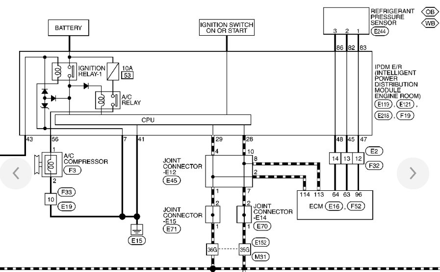

I changed the compressor approximately a month ago A/C worked fine. Now we have temperatures above 90° and the A/C works for about fifteen minutes and starts blowing warm air. Any suggestions? Two days ago I evacuated the system and did a leak test and recharged the system again. Still having the same issues.

Okay. That is great. The unfortunate thing is when you have equal pressure around 100, this indicates the compressor is not operating.
Before you go back to where you got the compressor from, I would just hook your gauges up and let the vehicle sit there and run while you monitor the pressures. I would guess that the pressures are closer to normal when it is blowing cold but if the compressor is not functioning at all then they will be about 100 on both sides all the time.
Let me know what you find and we can go from there. Thanks

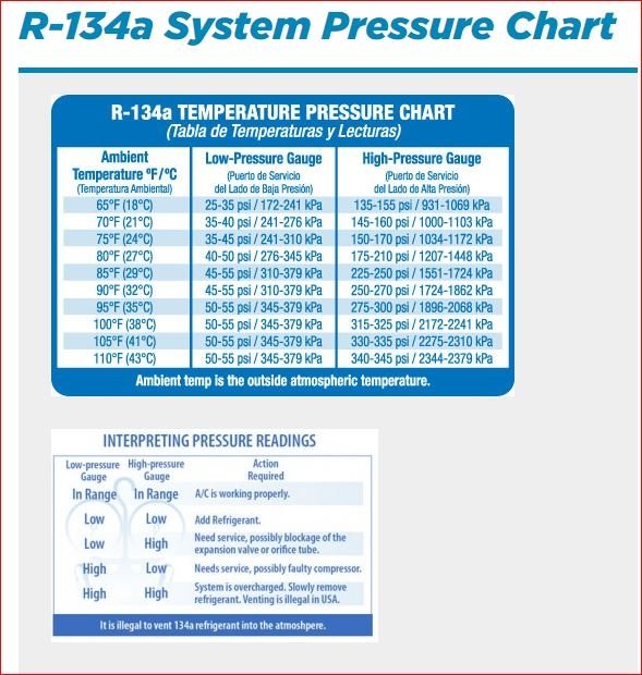

Update: I just was getting ready to leave work and decided to check the A/C one more time. After starting the car it took a good 20 seconds but the clutch engaged. Low side pressure is at 40 psi high side is at about 175 psi.
Jun 30, 2019 at 3:27 AM
Yeah. Sounds like the compressor is not operating. Here is a chart that shows the proper pressures based on ambient temps. When they are equal it just means the the compressor is not pressurizing the system so the high and low side become equal. In other words, it is a static system.
You will want to make sure you have voltage going to the compressor before you replace it again. There is a fuse and relay that control the compressor so if you measure power and ground at the compressor when it is on then they are both okay. If you do not, then check both and test.
