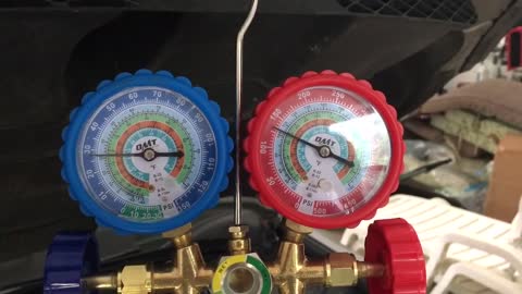

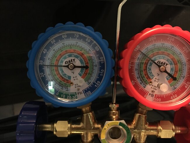

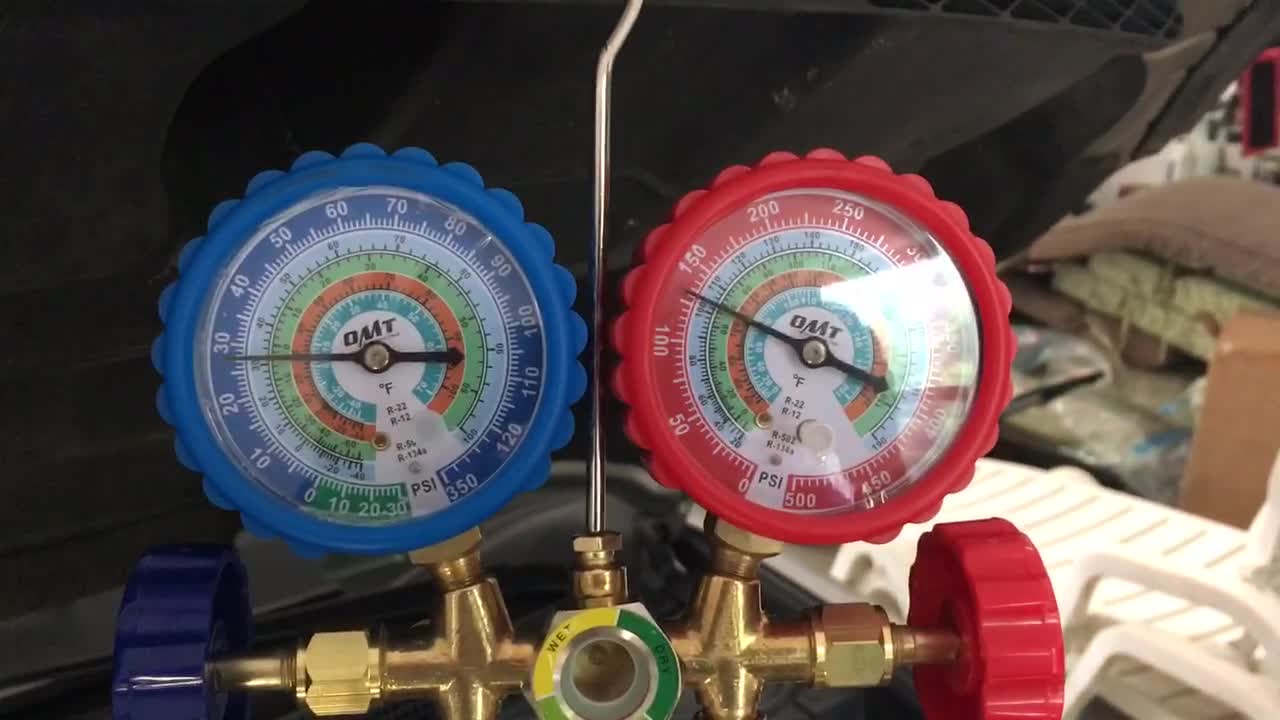

Hi, I bought an inexpensive set of gauges to check high as well as low pressures (Orion Motor Tech gauges).
Tried them today (after the A/C quit after about 20-30 minutes this morning (it is low-to-mid 80’s today).
The OMT gauges have an outer PSI ring and an R-134a ring inside it, so I’ll provide both readings. I’ll try to attach a picture if my description is unclear.
Before turning on the Acura, the Low read 98 psi (86 on the 134a ring) and High read 100 (88).
When I started the car, the readings went to 29 Low (33 for R-134a ring, but still much lower than the 47 reading I got with the digital gauge for the original posting) and 125 (102) for the High.
I ran the car for over 45 minutes and the ratings barely moved (though the High pressure went up to 150 - or 112 - after the car had run for several minutes and then stayed there).
Unlike what we’ve been experiencing in the real world, the A/C never quit.
Unlike all my previous testing in the garage, the fans never cut out or cycled on and off (and I never heard the Click that preceded the fans cycling off).

At 85 degrees, the low pressure should be between 45 and 55 psi. The high pressure should be 175 to 210 PSI. I think it's low on freon.
Let me know your thoughts.
Jun 30, 2024 at 12:06 PM
CALLICLES
Hi Joe - just wanted to let you know that I finally got to a trusted local mechanic and you were right. Over 15 years, our 2010 RDX had slowly leaked out about half of its R134a. He evacuated it and refilled it to its proper amount and - so far - it’s running great. Thanks for your help!
