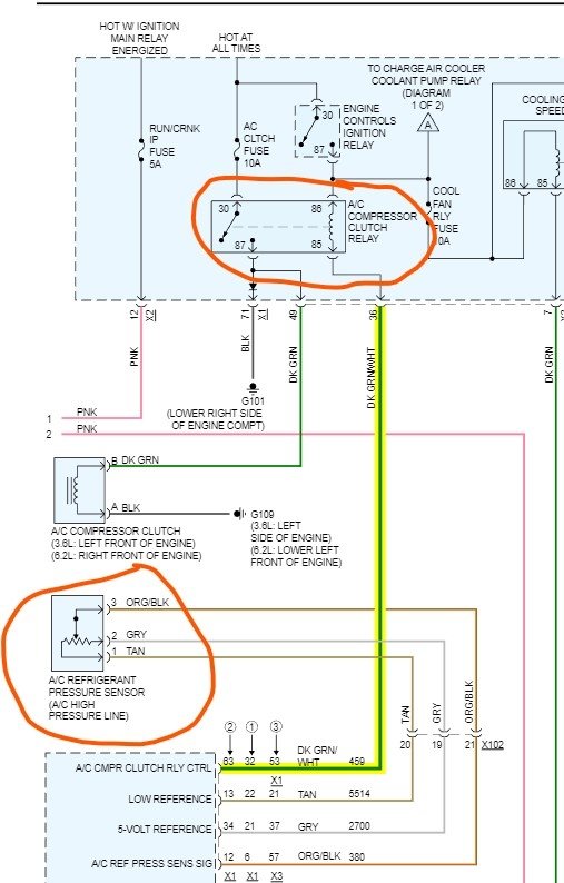

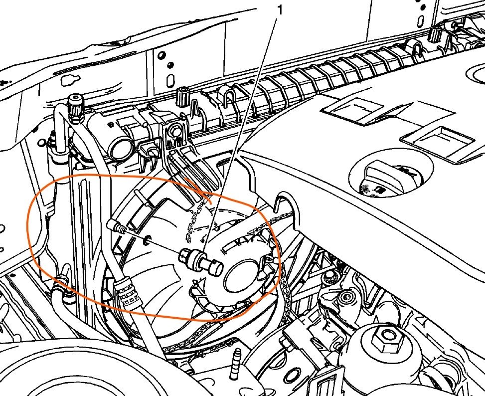

Need to know where high pressure and low pressure A/C relay are located.
Jun 4, 2022 at 12:36 AM
STEVE W.
  • 15,349 POSTS

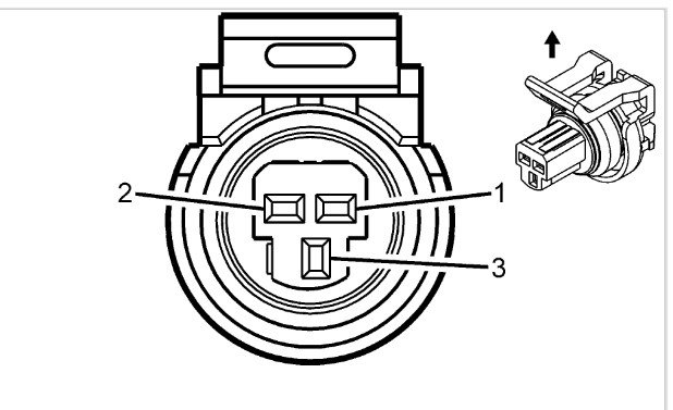

That system doesn't have A/C relays, it has a pressure sensor in the high-pressure line that sends data to the ECM and the ECM then controls the clutch relay. If you remove the plug from it, you should find a 5-volt signal on pin 2 (gray wire) a ground on pin 1 (tan) and the last pin is the signal pin from the sensor. It is a variable voltage not a simple on off type switch. What is the issue you are having with the system?
