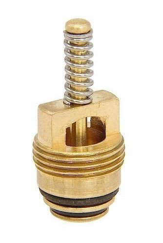

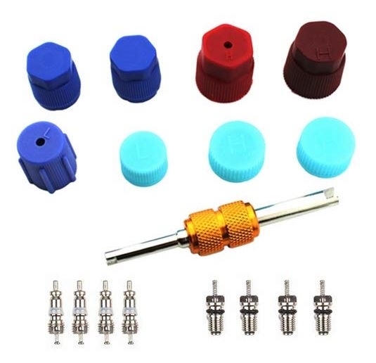

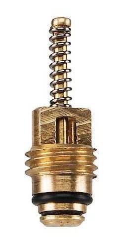

Welcome to 2CarPros. A/C can be a fun thing to work on. From the service information your system holds 810 grams +- 15g. Or 28.5 oz of refrigerant. Plus 220 ml of PAG oil. However I doubt you have lost the full oil charge. As for the valves, the commonly used one looks just like a common tire valve, for those a long stem core tool will work to remove them. Then there are JRA valves, these are larger than the common tire valve types and use a different tool. Plus there are M8 and M10 high flow valves. The double ended tool in the image removes them all. Most parts stores will have a version of that tool on the shelf.
I would suggest recovering the refrigerant charge, then put the system under vacuum to check for other leaks not just at the valves. If it holds a good vacuum for an hour or so then replace both the high and low valves and recharge the system, add some dye to it as well to help with future issues. I like to also test with a pressure charge of nitrogen on vehicles that have mystery leaks, that is because you could have a leak that only shows under pressure and not a vacuum. It also wouldn't be a bad idea to replace the O-Rings while you have the system empty.

Thanks for getting back to me so fast, I'm impressed. I was at AutoZone at the time I did this and checked what they had as far as valves go. Their A/C rack had valves that were the typical Schrader valve but offered none that were bigger or any of the others you mentioned. I bought two different valve tools and they didn't help either and were no bigger or deeper than what I have used for the last 35 years. A valve stem with the cap that has the tool on the end of it. Yes, go ahead and laugh but it's been bulletproof for 35 years. I will do as you suggested with the vac test. I was just hoping I could get away with the quick and easy recharge. NOT. lol. Thanks, Steve. I'll see if I can make a video while I do the test and see if I have any problems. You guys are the best.

Jaguar likes to do some things different. I don't laugh at things that work. Be sure to try turning the valve both ways, I have seen a few with left hand threaded valves.
