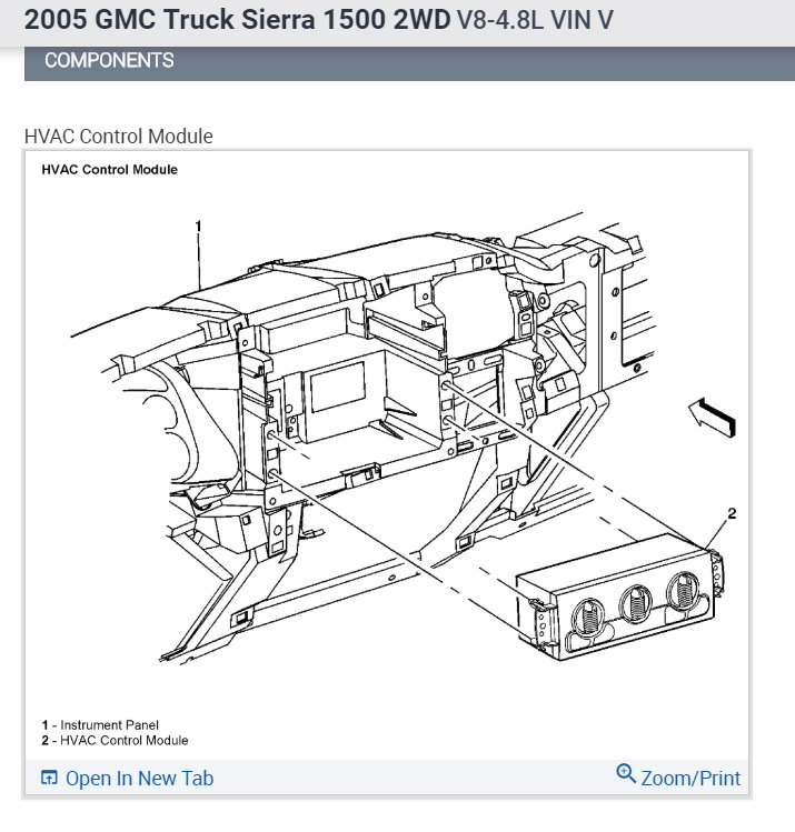

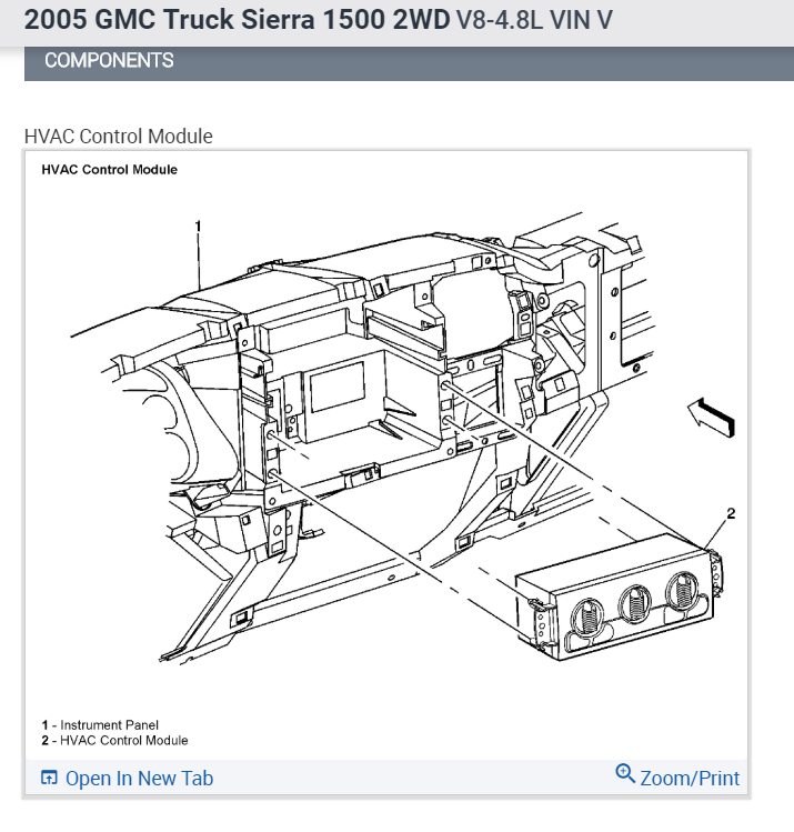

Hello, This is two problems that do not happen concurrently but I suspect they may be interrelated so I have included them both. The vehicle does have auto temperature and dual controls (GM RPO code CJ2).
The first problem is A/C randomly decides to start blowing hot air out either the driver or passenger side. One time it had fixed itself after it had been parked, shut off and sat for many hours, and another time it took disconnecting the battery for five minutes to bring it back.
The second problem is that the system randomly stops blowing air out the vents. When this happens I cycle through all the vent positions and hear air switching and changing internally. You can hear the air blowing and can also hear the blower motor running, but no air comes out the vents. I suspect the controller but was hoping to get a second opinion here before dropping money on a controller. they are not cheap! Thanks.

Yep it does sounds like the controller is loosing its calibration but lets reset the system to see if it holds one last time before replacing the control module. If it doesn't hold here are the replacement instructions and diagrams to help.
Remove the HVAC fuse and turn the key on for 1 minute then turn the key off and replace the fuse, then turn the key back one and let site for 1 minute. It should reset.

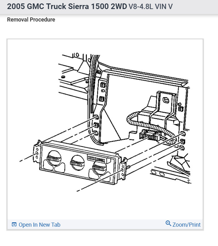

HVAC CONTROL MODULE PROGRAMMING AND SETUP
Each of the following service procedures may require programming or setup procedures to be performed on the HVAC control module or HVAC actuators.
HVAC Control Module Replacement
If the HVAC control module is replaced, an automatic re-calibration of all the actuators will occur. No additional procedures are necessary.
HVAC Control Module Reprogramming
Do not reprogram the HVAC control module, unless directed by a service procedure, or a service bulletin.
Reprogram HVAC Control Module-Refer to Service Programming System (SPS).
Actuator Replacement
If an actuator is replaced, the following procedure must be performed:
- Re-Calibrating Actuators-Refer to Re-Calibrating Actuators in HVAC Systems - Manual.
- Re-Calibrating Actuators-Refer to Re-Calibrating Actuators in HVAC Systems - Automatic.
1. Connect the electrical connectors to the HVAC control module.
2. Install the HVAC control module into the instrument panel, ensuring that the HVAC control module retaining tabs lock into place.
Notice: Use the correct fastener in the correct location. Replacement fasteners must be the correct part number for that application. Fasteners requiring replacement or fasteners requiring the use of thread locking compound or sealant are identified in the service procedure. Do not use paints, lubricants, or corrosion inhibitors on fasteners or fastener joint surfaces unless specified. These coatings affect fastener torque and joint clamping force and may damage the fastener. Use the correct tightening sequence and specifications when installing fasteners in order to avoid damage to parts and systems.
3. Install the screws from the HVAC control module.
Tighten
Tighten the screws to 1.9 Nm (17 lb in).
4. Install the instrument panel accessory trim plate. Refer to Instrument Panel Cluster Trim Plate Bezel Replacement See: Dashboard / Instrument Panel > Removal and Replacement.
Important: Do not adjust any controls on the HVAC control module while the HVAC control module is calibrating. If interrupted improper HVAC performance will result.
5. Start the vehicle and let run for one minute.
6. Refer to Control Module References for programming and setup information See: Vehicle > Programming and Relearning.
Check out the diagrams (Below). Please let us know what you find. We are interested to see what it is.

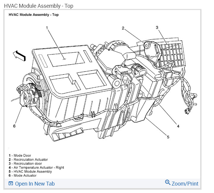

Here is more information before before I answer the low on charge question...
The following day after my previous post I turned the vehicle on and the air blowing out the vents was back to being cold, and the system ran cold for the duration of an hour long drive. The following day on an hour long return drive, the system stopped blowing air at about the 55 minute mark, same as described in my original post. I will add that more specifically, what it does is slowly blow less and less air until eventually it is not blowing anything. As in my original post, once this happens I can still cycle through the different vents (vent, floor, defrost) and can hear air being diverted within the plenum AND hear the blower motor running, yet nothing comes out. And now my experience with this tells me that I will have to let the vehicle (more specifically the control unit) cool to ambient temperature before it will go back to working normal.
One thing I did not mention previously is that prior to performing the HVAC reset, I brought the control unit inside, completely disassembled it and multimeter tested the 100 ohm ceramic resistors (3 each) and the 2 large capacitors by desoldering 1 leg of each to remove them from the circuit. All components checked fine. but I did notice a browning of the white plastic back shell in the direct vicinity of where the ceramic resistors are located when the control unit is assembled. And knowing that ceramic resistors are used in high power/current applications, I know that means that they will generate quite a bit of heat. With the processor chip being on the same circuit board and less than 2 inches away, I am now thinking the most likely explanation is that after 14+ years of being too close to the ceramic resistors without any shielding or even so much as a heat sink on said components, that the processor chip is now suffering from latent heat damage and is malfunctioning whenever it reaches a certain temperature. To me, that is the most likely explanation of what is happening to cause at least 1 of 2 problems. The other problem, the blowing of hot air out of driver of passenger side, from what I have read up on could either also be the control unit or could be an actuator that has gone bad. Others have reported that same problem and it had turned out to be an actuator in some cases. But my HVAC system problem was bigger than just that one thing, which widens the number of things I need to rule out in order to pinpoint the problem. Long story short is I am fairly certain that a new control unit will fix 1 of 2 problems and will maybe fix both.

The air stop blowing part sounds like the evaporator core could be icing up due to lack of charge. Also the drivers side actuator can be out good call on that. here is a guide to help:
Let em know how to goes once you have replaced the control head and actuator while checking the refrigerant level.
