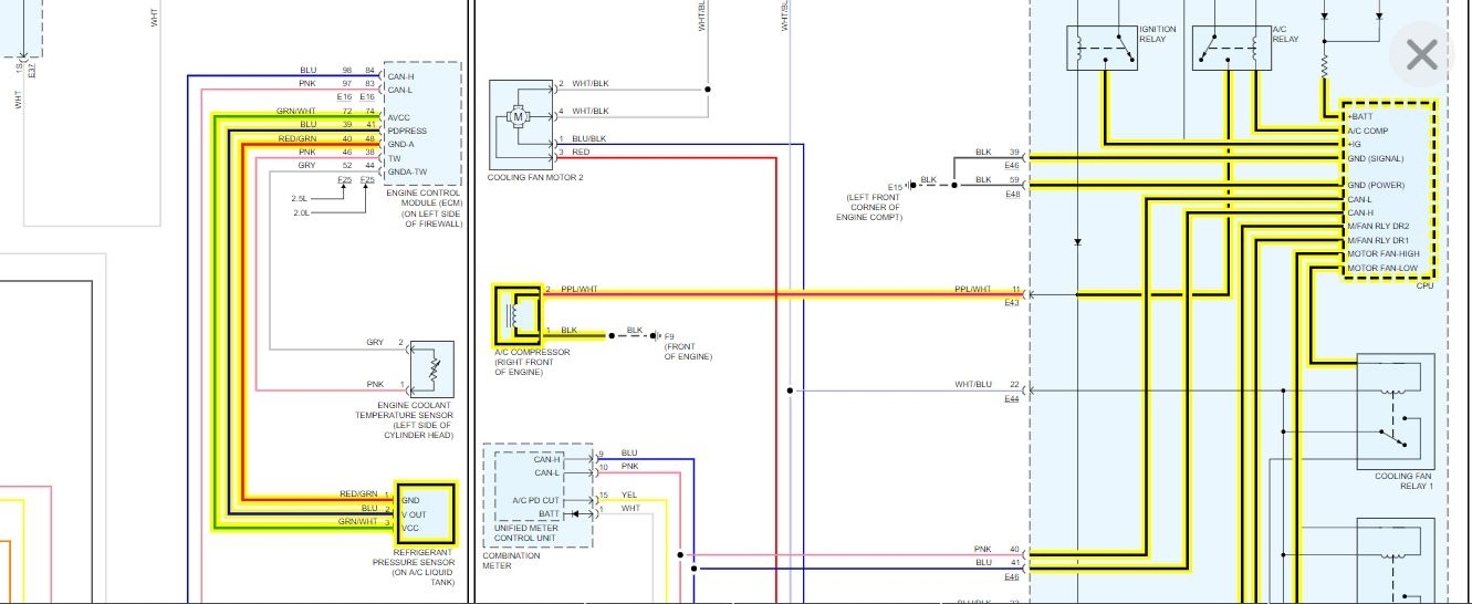

So, i realized that my A/C is not working properly recently. i bought the car in October and only used the heating since. The heating works just fine but i recently noticed that cold air does not work properly. When using cold air, airflow seems week and not cooled. any pointers as to what might be the cause before i spend big money for no good reason ? (also sorry it has 140,000 km (87,000 miles) not 14 000 miles my bad)

Do you have a set of gauges to give me the high and low side reading for the A/C system? This will help determine if the issue is Freon or electrical.
When you turn on the A/C, does the compressor come on?
I attached a diagram of the compressor circuit for you.
The ECM will allow the compressor to come on when it sees the correct readings from the pressure switch. That is why I asked about the pressures.
