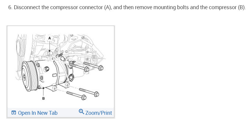

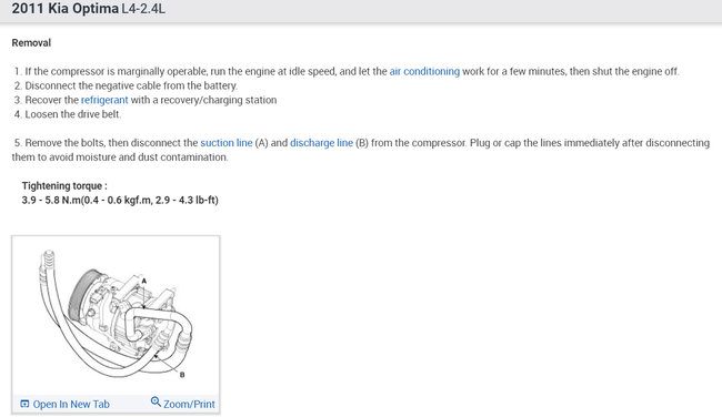

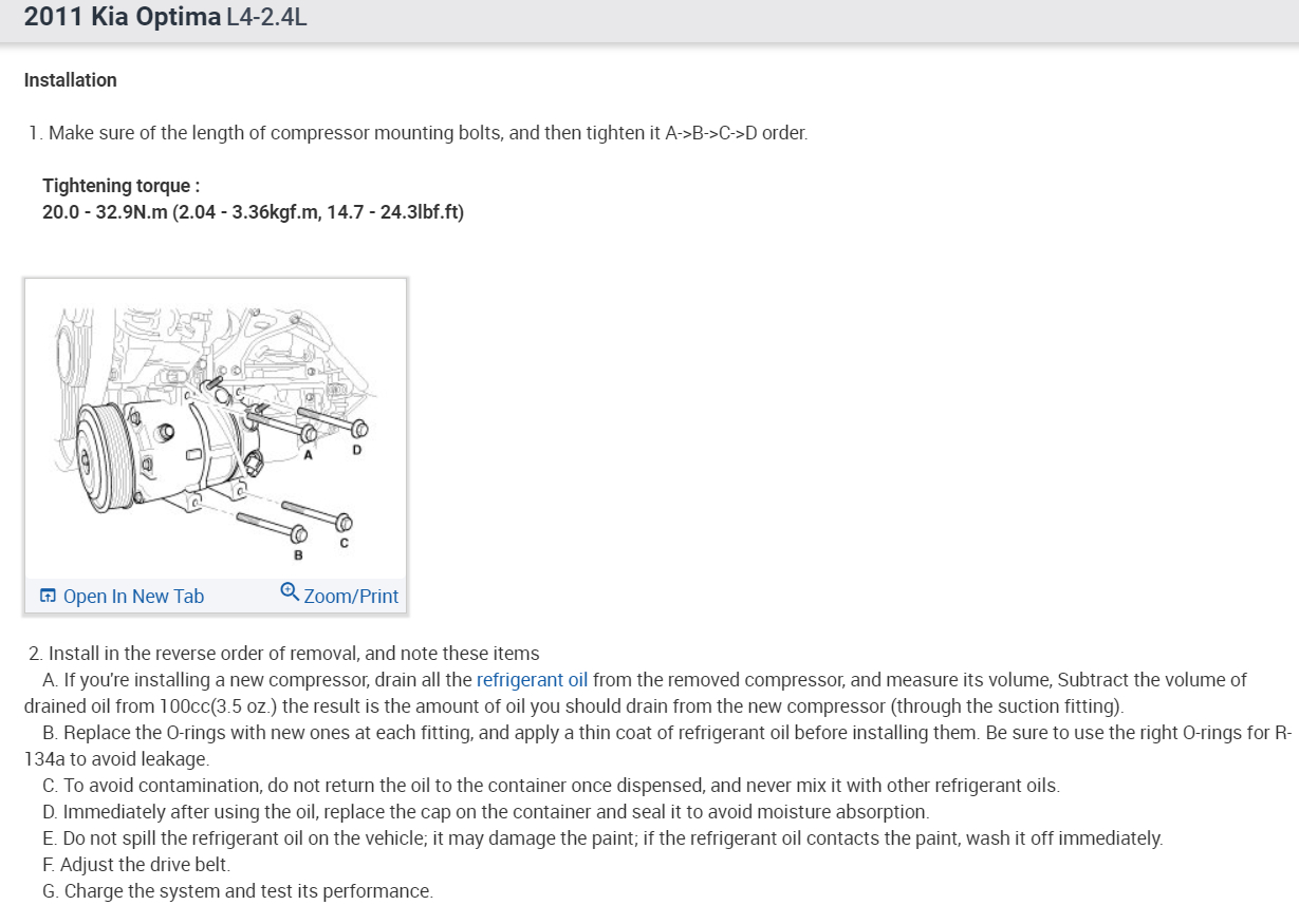

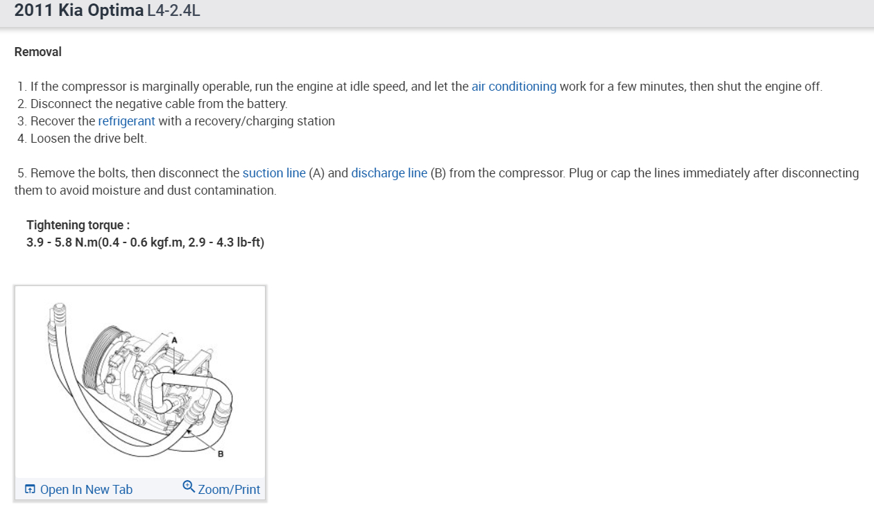

That noise sounds like the compressor is back feeding the noise through the low side telling us the compressor is bad or the expansion block is wide open. Here is a guide to help you see what you are in for when doing the job and diagrams below to see what it will be like on your car.
Expansion Valve part # 976263R000 - $167.09 retail.
https://www.2carpros.com/articles/replace-air-conditioner-compressor
Here is a video on how to vacuum down and recharge the system. You can get both parts from Amazon/RockAuto
https://youtu.be/C9IvBziFUSo
