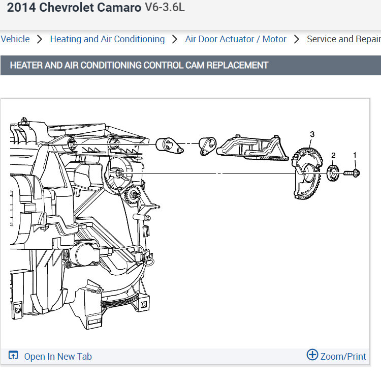

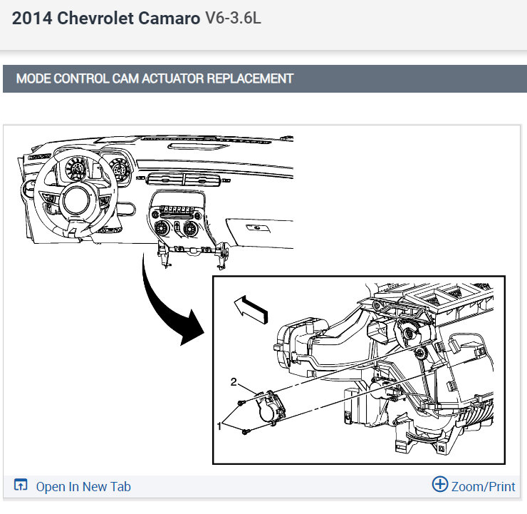

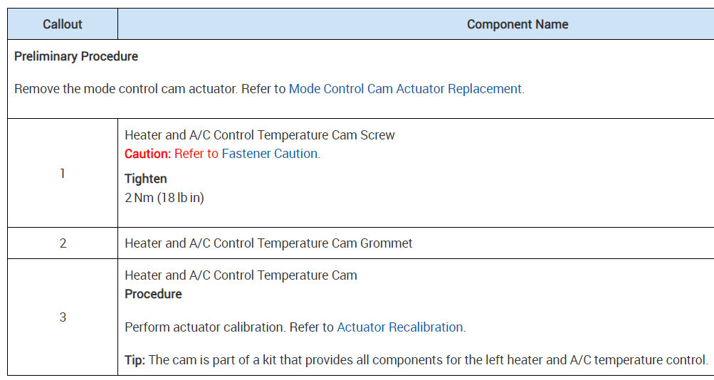

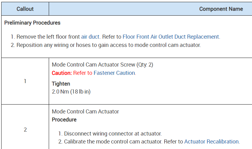

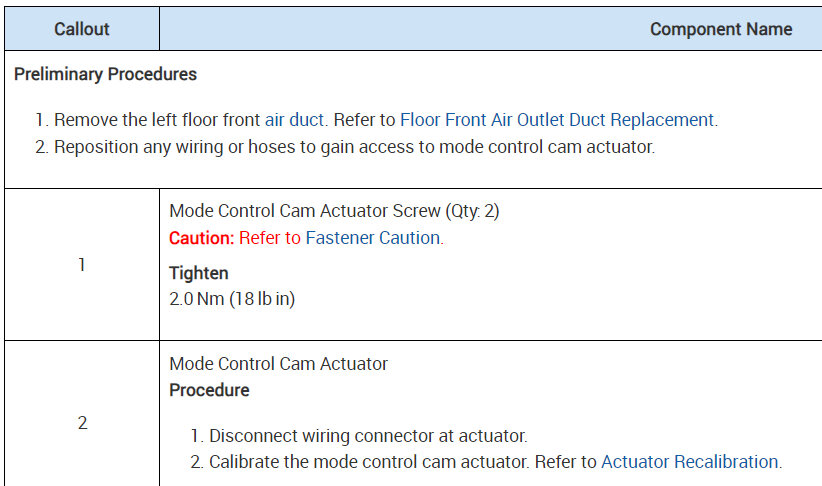

Yep, it sounds like the rheostat inside the mode blend door actuator has gone out. Here is the location of the part you so can swap it out which should fix the problem. This car does not have right and left climate controls, correct? Here is the location of the mode door actuator so you can check it out. Check out the images (below). Please let us know what happens. BTW while you are under the dash, please check control cams for the heater and A/C blend door which I have included as well.
