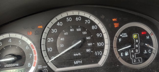

I have another unrelated issue. Last fall I had some used tires put on from a local shop. Early spring this year my tire pressure management system turned on. I checked pressure and it was high high. Figured it was temperature change. It kept coming on every once in a while so I kept checking and adjusting to the specs which is 35 psi. Not long after. All these lights came on. They would sometimes last a short time other times not till the next day. This went on for about a month. Then one day they turned on and have stayed that way.
I have no idea what this could be. I took it to a local parts store where they can scan for faults and nothing can up. It runs fine everything seems to work. The indicator light for the tire pressure management system is blinking rapidly and the other lights (VSC, brake and track off) just stay on.
Any ideas?
Jul 19, 2020 at 11:07 PM
RUDYPAK
  • 42 POSTS
I forgot the ABS light is on and my horn didn't work.
Clock spring bad?
