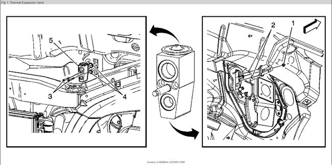

After layoff for two months, A/C blows warm. No "check engine light" blower motor fine, fuses, replaced relays anyway. Under hood,noticed A/C clutch spins, (I do know the electric fan does cycle on in traffic) added Freon that came with gauge, read full before I pulled trigger. Days later purchased Manifold gauge from Harbor Tools to get a pressure reading. Read even 60 high and 60 low while the A/C clutch was spinning. Ran out of time, so disconnected high side and low side.I will mention that the high side shrader valve did leak when I disconnected the hose from the manifold gauge like it is stuck open, put dust cover back. replace valve? Later, wanted a second pressure test for diagnostics, now the A/C clutch will not turn because too low? the readings were 20/20. I do not have much money to spend on this so trying to go slow and careful.

Although I am not technically an AC mechanic, that sounds to me as though the expansion valve is stuck open. You should also fix that leaking shrader valve.
You may need a J 46246 valve core tool.
Of course you will have to recover the Freon for both procedures. although R134a is supposed to not harm to ozone layer, I still do not think it is legal to just allow it to escape into the atmosphere.
Here are the instructions for replacing that expansion valve.
Recover the refrigerant. Refer to refrigerant recovery and recharging .
Remove the air cleaner assembly. Refer to air cleaner assembly replacement for the 2.2L (L61) engine or air cleaner assembly replacement for the 2.4L engine.
1. A/C evaporator and condenser hose nut.
2. Sealing washer.
Remove and discard sealing washers. Refer to sealing washer replacement .
3 Thermal expansion valve bolts (Qty: 2).
Tighten: (62 lb in)
4 Sealing washer.
5 Thermal expansion valve

Since I need to evacuate the Freon to replace the shrader valve, why not replace the expansion valve, charge it up to the right Freon specs/oil and try the pressure test again hoping the compressor does its job?

Because the expansion valve is not your problem. The symptoms do not indicate anything wrong with the expansion valve. I live in South Florida and I specialize in AC repairs.
