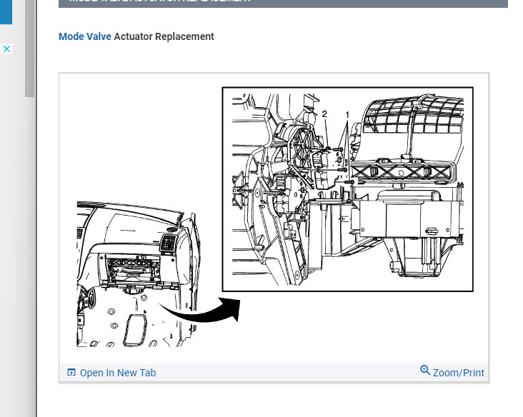

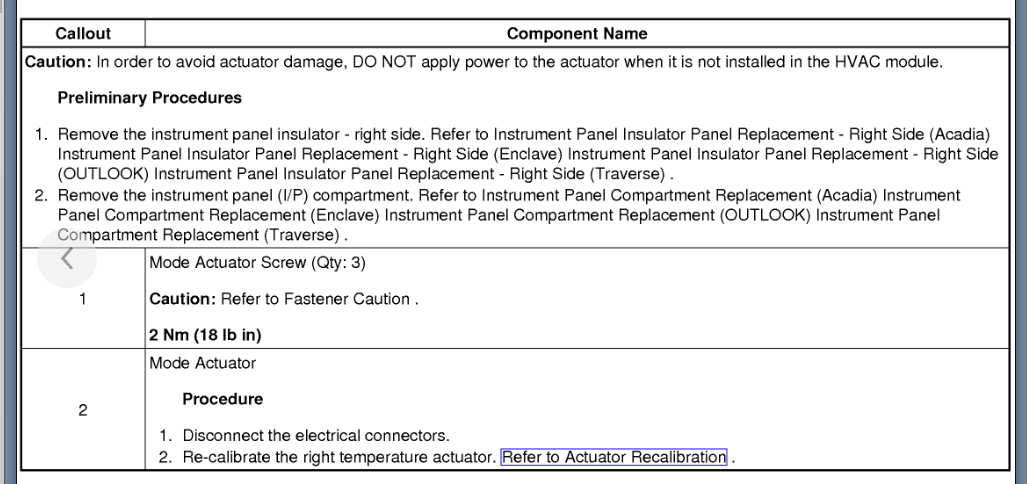

Okay. I am sorry then that may still be an issue because you said it does not cool that well but if it is not blowing then that is a fan issue or directional door issue.
If it blows out of the defrost vents, then the blower is working. So that means we need to look at what is called the mode door.
Here is a guide that talks about this:
https://www.2carpros.com/articles/air-vents-stay-in-the-defrost-position

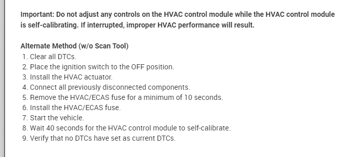

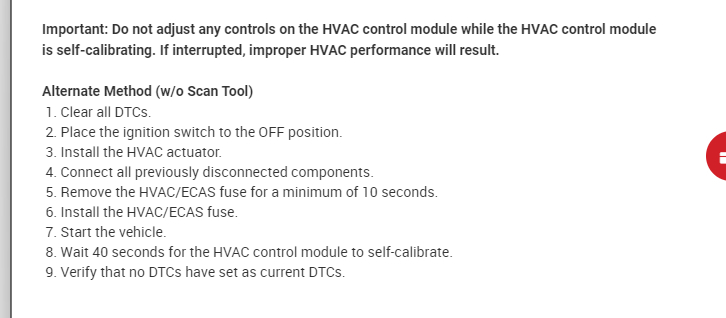

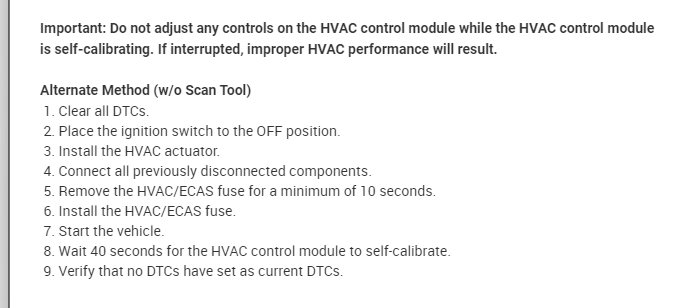

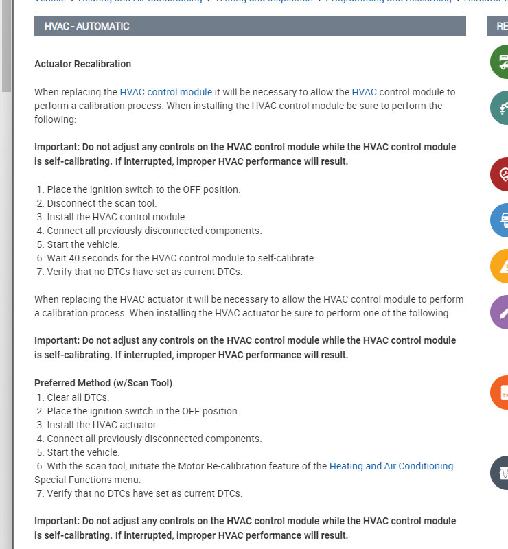

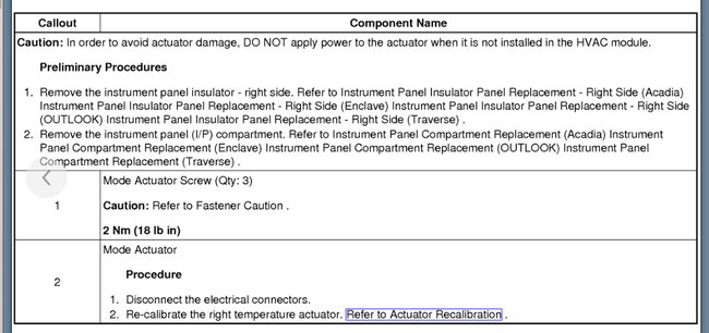

Below you will find the process from the manual that will help with replacing this actuator, which is what I suspect we are going to have to do.

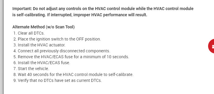

Also, you are going to have to recalibrate it so that process is there for the auto and manual systems.
Let me know if you have questions on this.
