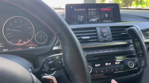

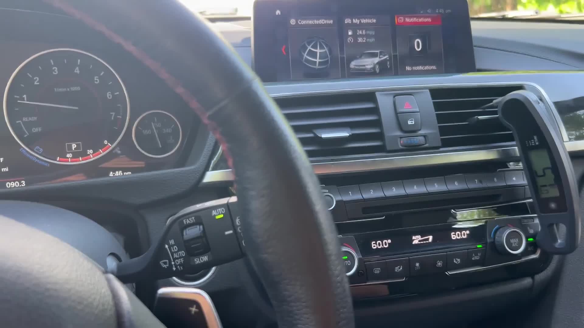

In the video I attached, I placed an instant read thermometer in the vent. It is displaying 56 at the beginning and goes up past 80 by the end of the video after I turn the fan speed up. You will also notice the fluctuation in the RPMs. Once the RPMs begin to fluctuate the groaning noise start, then I feel a light "clunk" in the seat and floorboard and the RPMs drop. It will continue this cycle until I lower the fan speed down or turn the car off.
