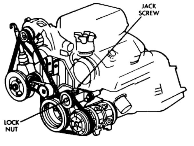

My A/C belt broke today on my van. The belt had been squalling for a bit. How can I figure out why the belt broke and can I still drive my van without that belt? I just had a timing belt kit installed in December due to a bad water pump. Should my mechanic had noticed any issues when he replaced the water pump?

You should be able to run without the AC belt since the AC compressor is the only thing it runs. The noise however is either coming from the AC compressor pulley or the pulley where the jack screw is located in this diagram.
To replace that belt:
1. Loosen adjusting lock-nut, then turn jack-screw, Fig. 27, counterclockwise to reduce belt tension and remove belt.
2. When reinstalling belt, adjust belt tension to 5/16 inch deflection between pulleys.
