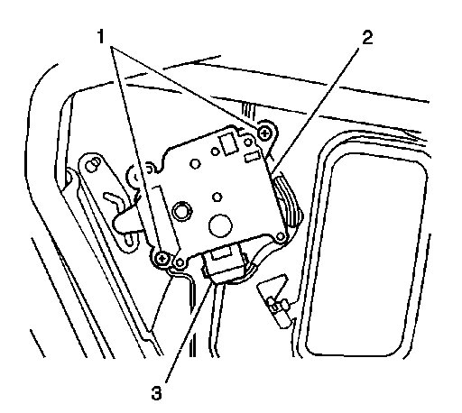

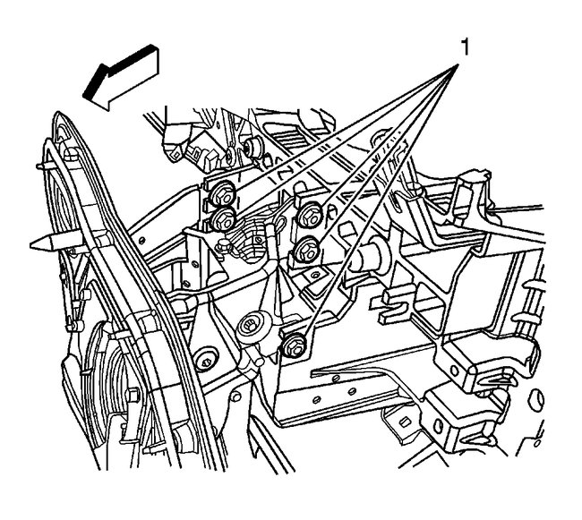

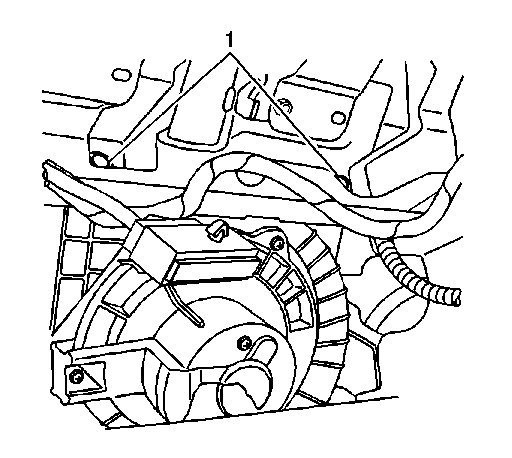

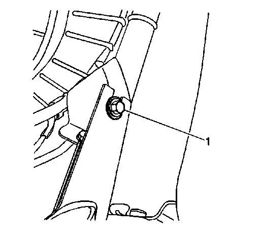

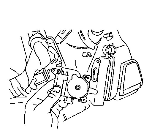

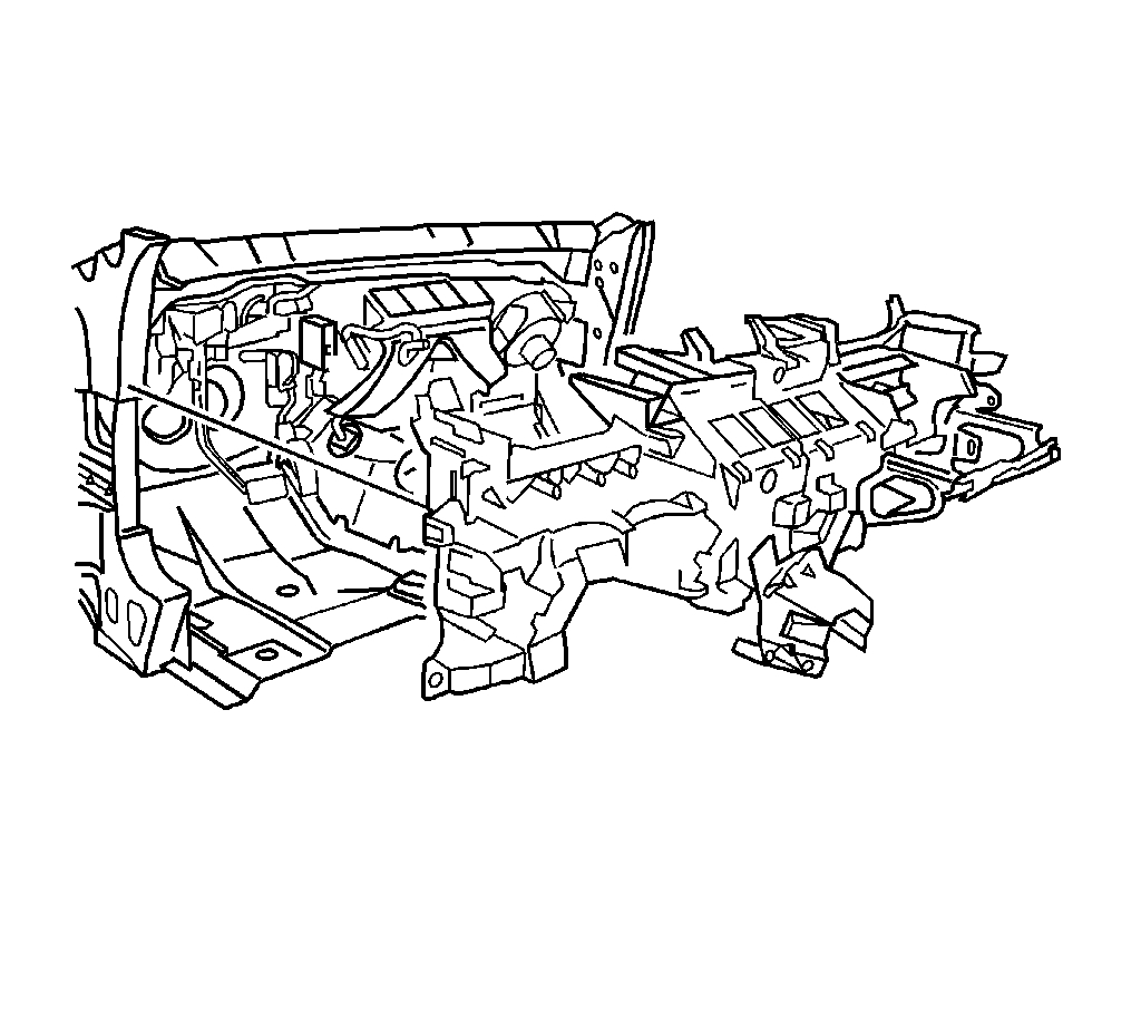

A/C blowing warm air on passenger side vent
130,000 MILES • 3.6L • 6 CYL • 4WD • AUTOMATIC
CANDO1
  • 47 POSTS

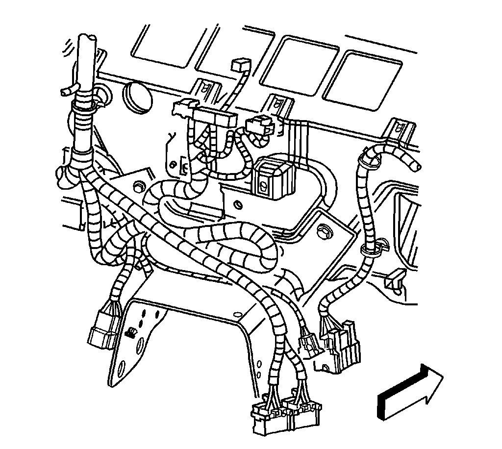

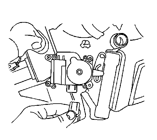

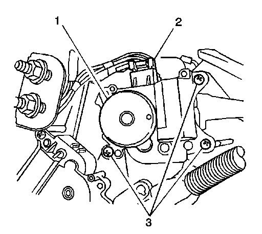

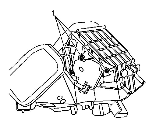

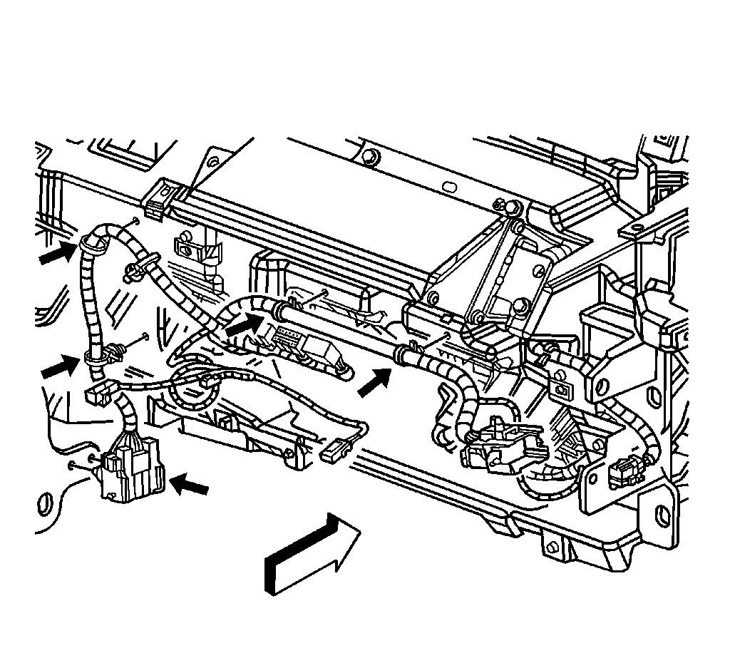

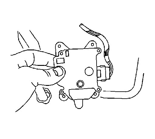

Where is the A/C heater A/C defrost heat mode Control Door Actuator Motor part number 15939657 at and can I get to it?
Also the HVAC Air Adjustment Control Motor part number 89023395 located at and also can I reach it?
I know where the blending door actuators are right number 89023390 and left number 89023389.
I want to replace all 4.. the right vent is warm with the A/C running and i'm getting clicking noises from inside the dash... i just want to replace them all.. Thanks, Floyd

The actuators aren't too easy to get to. I am going to provide the directions from the manual. You mentioned that you are okay with the blend doors, so I'm not including them. If you need them, let me know.

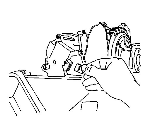

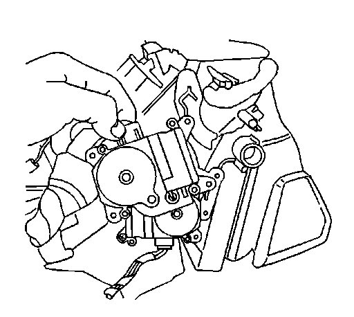

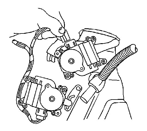

Here are directions for replacement. First is the mode door actuator. As far as the mode door, the instrument panel needs removed. I will provide those directions as well. All pics correlate with the directions.
________________--
2008 Cadillac STS AWD V6-3.6L
Mode Actuator Replacement
Vehicle Heating and Air Conditioning Air Door Actuator / Motor Service and Repair Removal and Replacement HVAC - Automatic Mode Actuator Replacement
MODE ACTUATOR REPLACEMENT
Removal Procedure
1. Remove the instrument panel (I/P) carrier. Refer to Instrument Panel Carrier Replacement (See: Dashboard / Instrument Panel > Removal and Replacement) .
pic 1
2. Disconnect the mode actuator electrical connector.
pic 2
3. Remove the mode actuator screws (3).
pic 3
4. Remove the mode actuator.
Installation Procedure
pic 4
1. Install the mode actuator.

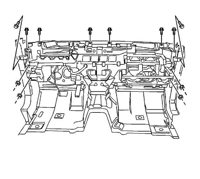

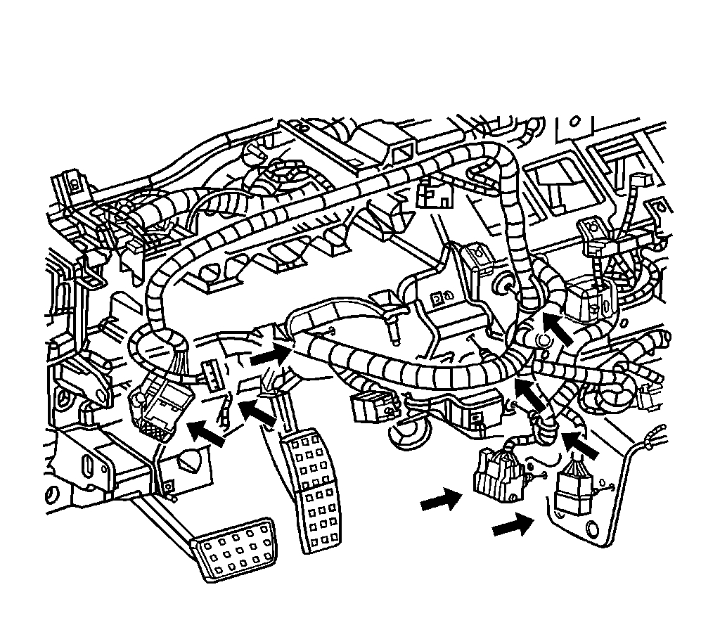

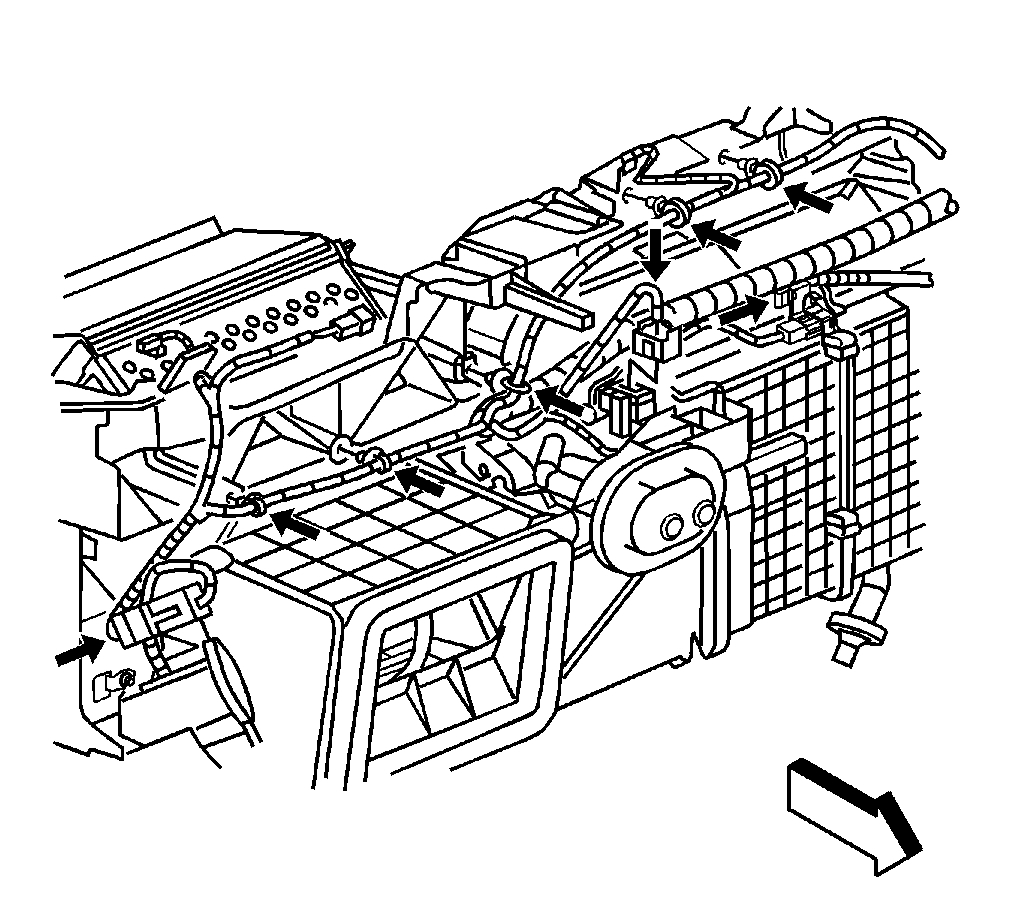

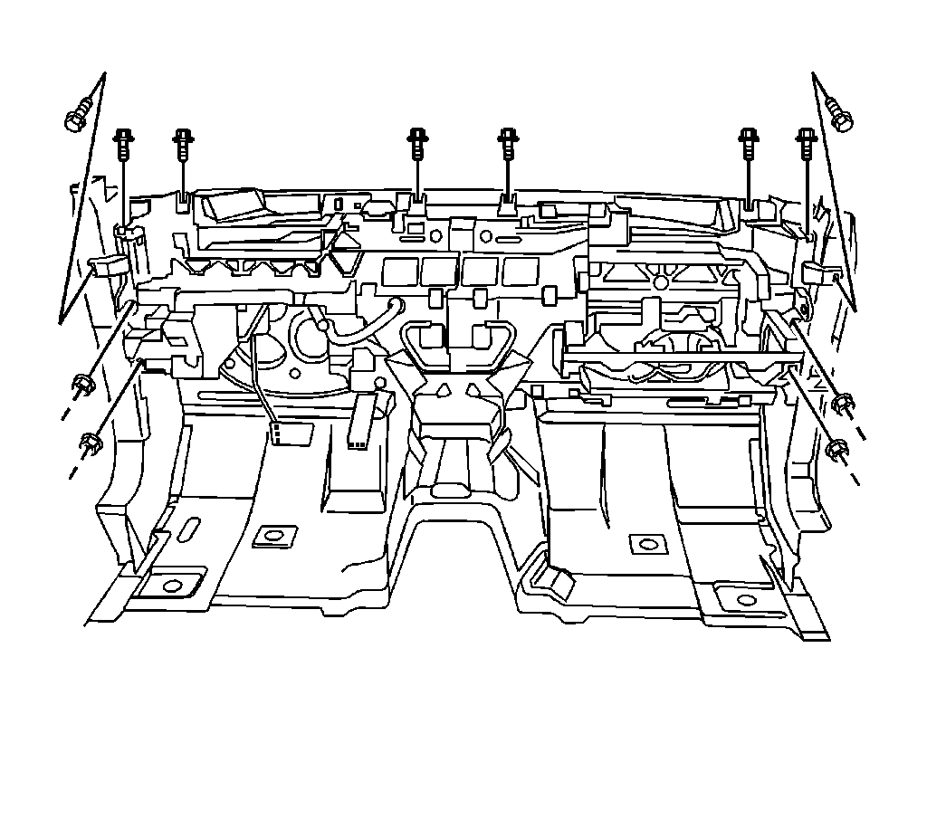

Here are directions for replacement of the IP carrier. You aren't replacing it, but these are the directions I have which include removal and replacement.
_____________________________________
Vehicle Body and Frame Interior Moulding/Trim Dashboard /Instrument Panel Service and Repair Removal and Replacement Instrument Panel Carrier Replacement
INSTRUMENT PANEL CARRIER REPLACEMENT
Removal Procedure
1. Remove the front seats. Refer to Bucket Seat Replacement (See: Seats > Removal and Replacement > Bucket Seat Replacement) .
2. Remove the instrument panel retainer. Refer to Instrument Panel Retainer Replacement (See: Dashboard / Instrument Panel > Removal and Replacement) .
3. Lower the steering column. Refer to Steering Column Replacement (without JL7) (See: Steering Column > Removal and Replacement > Steering Column Replacement (without JL7))Steering Column Replacement (with JL7) (See: Steering Column > Removal and Replacement > Steering Column Replacement (with JL7)) .
pic 7
Important: Note the position of the wire harness.
4. Disconnect the wire harness connector and clips on the drivers side of the vehicle.
pic 8
5. Remove the wire harness clips in the center of the instrument panel.
pic 9
6. Disconnect the wire harness connectors and the harness clips on the passenger side of the instrument panel.
pic 10
7. Loosen the nuts securing the instrument panel carrier brackets to the pedal assembly.
The nuts do not have to be removed.
pic 11
8. Remove the fasteners securing the carrier to the cowl.
9. Remove the bolt securing the carrier to the HVAC housing.
pic 12
10. Move the carrier back away from the cowl far enough to disconnect the wire harness retaining clips off of the carrier.
pic 13
11. Remove the carrier from the vehicle.
pic 14
1. Connect the wire harness retaining clips to the rear of the carrier.
pic 15
2. Locate the carrier on to the pedal assembly brackets.
Tighten the nuts securing the instrument panel carrier brackets to the pedal assembly to 25 N.m (18 lb ft)

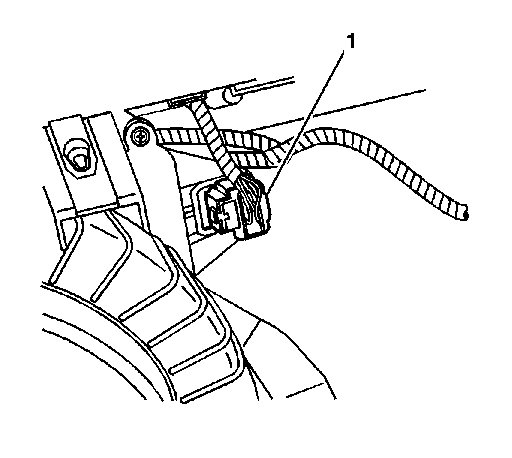

The one above you identified as the air adjustment control motor I believe to be the fresh air door actuator. There is nothing listed as you mentioned.
Here are directions for that.
Re-circulation Actuator Replacement
Vehicle Heating and Air Conditioning Air Door Actuator / Motor Service and Repair Removal and Replacement HVAC - Automatic Re-circulation Actuator Replacement
RE-CIRCULATION ACTUATOR REPLACEMENT
Removal Procedure
1. Remove the air inlet assembly. Refer to Air Inlet Assembly Replacement (See: Air Duct > Removal and Replacement > Air Inlet Assembly Replacement) .
pic 21
2. Disconnect the electrical connector from the re-circulation actuator.
pic 22
3. Remove the re-circulation actuator screws (1).
4. Remove the re-circulation actuator.
pic 23
1. Install the re-circulation actuator.
Notice: Refer to Fastener Notice .
2. Install the re-circulation actuator screws (1).
Tighten the screws to 1 N.m (9 lb in).
pic 24
3. Connect the electrical connector to the re-circulation actuator.
4. Install the air inlet assembly. Refer to Air Inlet Assembly Replacement (See: Air Duct > Removal and Replacement > Air Inlet Assembly Replacement) .

Darn this is the Bomb.. It's almost impossible to get information on my model.. Can you please give the blending doors as well? I'd like to look over the procedure before diving in... Thanks.. I absolutely appreciate this beyond what I can say...
Aug 23, 2020 at 3:48 PM
  • 110,248 POSTS

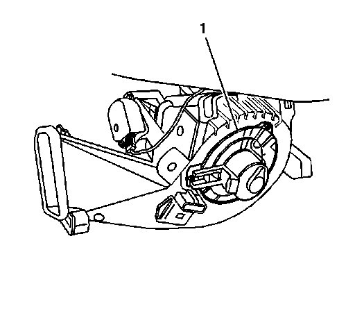

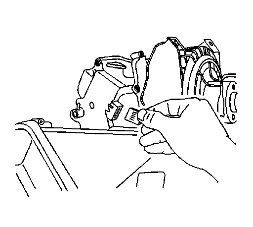

The first set of directions are for the right side and the second, the left.
___________________________________________
Air Temperature Actuator Replacement - Right Side
Vehicle Heating and Air Conditioning Air Door Actuator / Motor Service and Repair Removal and Replacement HVAC - Automatic Air Temperature Actuator Replacement - Right Side
AIR TEMPERATURE ACTUATOR REPLACEMENT - RIGHT SIDE
Removal Procedure
pic 1
2. Remove the right air temperature actuator screws (1).
pic 2
3. Remove the right air temperature actuator.
4. Disconnect the right air temperature actuator electrical connector.
1. Connect the right air temperature actuator electrical connector.
pic 3
2. Install the right air temperature actuator.
Notice: Refer to Fastener Notice (See: Vehicle > Vehicle Damage Warnings > Fastener Notice) .
3. Install the right air temperature actuator screws (1).

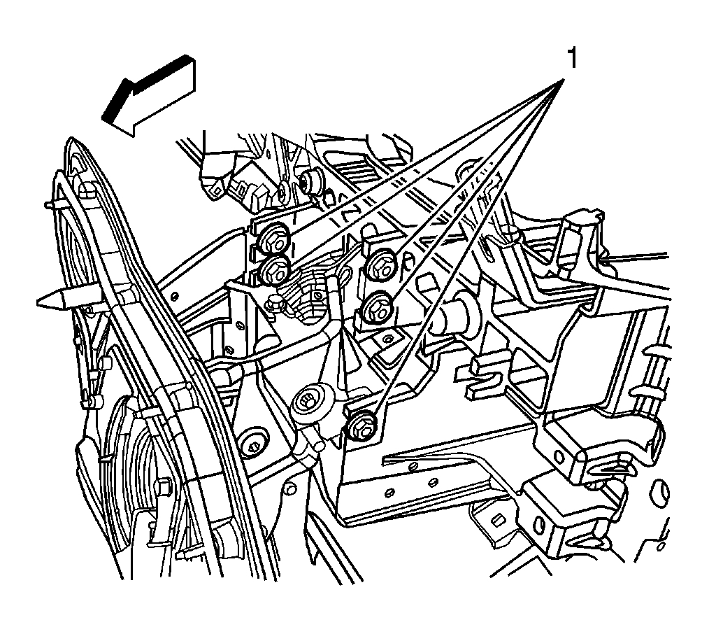

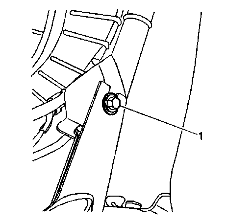

pic 4
Air Temperature Actuator Replacement - Left Side
Vehicle Heating and Air Conditioning Air Door Actuator / Motor Service and Repair Removal and Replacement HVAC - Automatic Air Temperature Actuator Replacement - Left Side
AIR TEMPERATURE ACTUATOR REPLACEMENT - LEFT SIDE
Removal Procedure
1. Remove the left closeout panel. Refer to Instrument Panel Insulator Panel Replacement - Left Side (See: Dashboard / Instrument Panel > Removal and Replacement) .
pic 5
2. Disconnect the left air temperature actuator electrical connector from the actuator.
3. Remove the left air temperature actuator screws.
pic 6
4. Remove the left air temperature actuator.
pic 7
1. Install the left air temperature actuator.
2. Install the left air temperature actuator screws.
pic 8
3. Connect the left air temperature actuator electrical connector to the actuator.
4. Install the left closeout panel. Refer to Instrument Panel Insulator Panel Replacement - Left Side (See: Dashboard / Instrument Panel > Removal and Replacement) .
