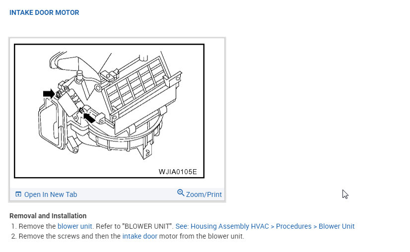

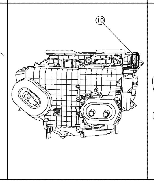

This is most always the mode door actuator has failed or is failing. Attached is the process to access and replace this. This is responsible for directing the air to the selected location.
Here is a guide that will help with this:
This is one on the blend door but the theory is the same.
Below is the process from the manual on how to do this. Please run through this material and let us know if you have other questions. The Mode actuator is #10. Check out the images (below). Let us know if you need anything else.

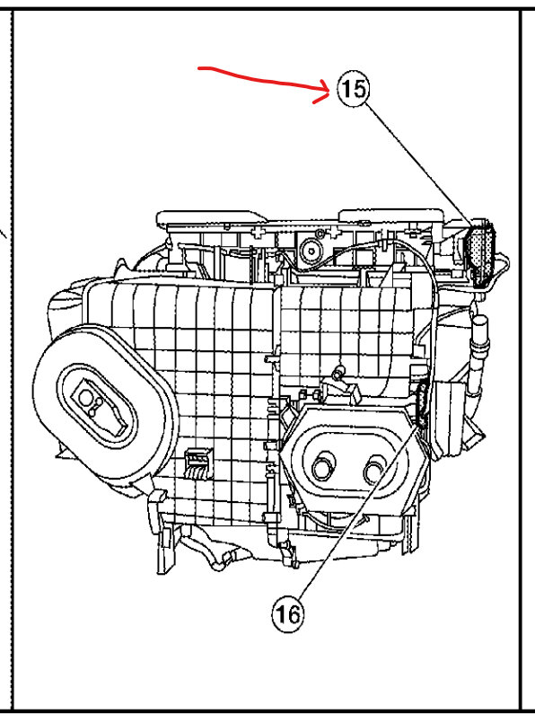

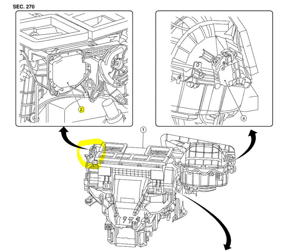

I am trying to determine how to fix the (guessing) actuator that changes air flow for the A/C. When I turn on the A/C it will only blow out of the bottom feet vents. It will not change to the upper vents no matter what buttons I push. I think someone had this issue before where you take out the glovebox and so forth... I just want to make sure I'm looking at the same thing before I follow those directions.
May 24, 2021 at 12:10 PM (Merged)
BORIS K
  • 836 POSTS
It looks like you might have a problem with the mode door motor which is located on the opposite side of the motor you were referring to. Please see picture below regarding the location.
To access the mode door motor you will have to remove the instrument lower panel on the driver's side. Then disconnect the harness from the motor. Remove the screws holding the motor and then the motor.
Please let us know how you get along.
Cheers, Boris
SEAN PEDONE
  • 10 POSTS
Okay, finally got the actuator out. Not easy. Best place to buy?

Okay, got Part number: 27731-3SB0A Actuator motor installed and no change. I may have overlooked a symptom when first asked. When I hit "AUTO" for the HVAC it defaults to the floor vents instead of the face vents. What would control that?

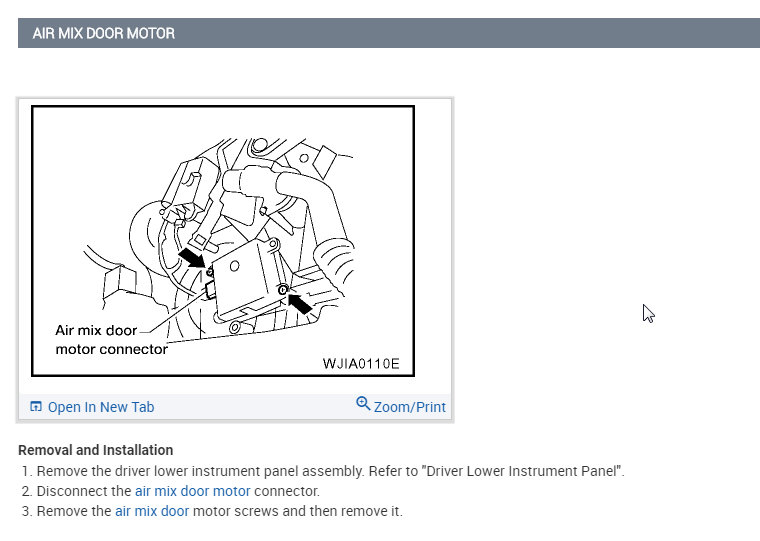

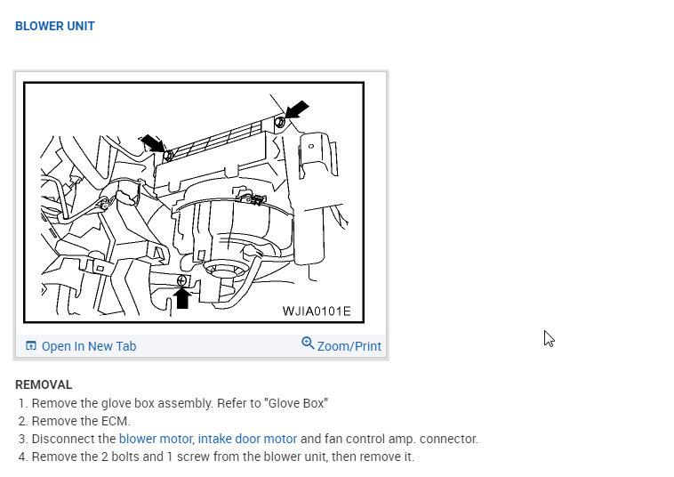

All summer my A/C would go from cold to hot, now my heater is more cold than warm. I've been doing all the suggested DIY projects with no results. My problem now is when I changed the cabin air filter I found a mouse nest in the top after removing the filter. I was forcing my fingers into the small opening and something broke. Just my luck. It is a hinged rectangular part with a foam insulation around the edges. Can someone the me what it's called, and how to replace it?
I think you have two issue now that the door broke. I suspect the actuator is what actually broke and not the door itself. I attached the process on how to access this from under the dash. The only way to know for sure what it was is to look up there when you get the blower motor out.
As for the air not being the right temp. More than likely this is the air temperature door actuator has failed. There is a chance that this is a temperature sensor but the actuators are more likely.
Let me know if you have questions and we can go from there. Thanks

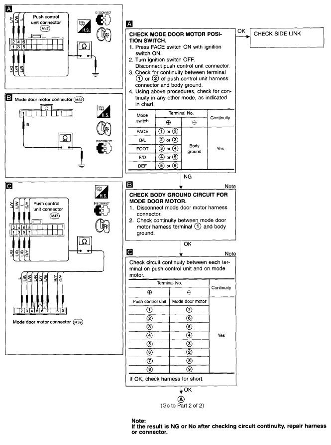

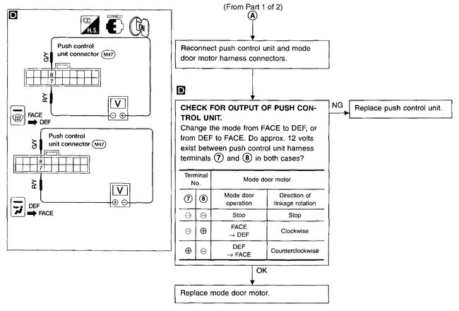

JAMIE TURNER
I have no air coming from the dash vents. It only comes out of the top and bottom. I have found 2 actuators and neither one of them have fixed the problem. Is there another on or do those two work together to control where the air comes out?
May 24, 2021 at 12:11 PM (Merged)
STEVE W.
  • 15,345 POSTS
Your description sounds like the ventilator door is stuck closed or the mode actuator has failed. As you have changed those out already then you will need to test the push controller to see if it is sending the correct signals to the mode control actuator. The images are the process to test the controller.
First verify that fuses 1, 2, 6, 8 and 30 are all good. Those provide the power to the HVAC control system.

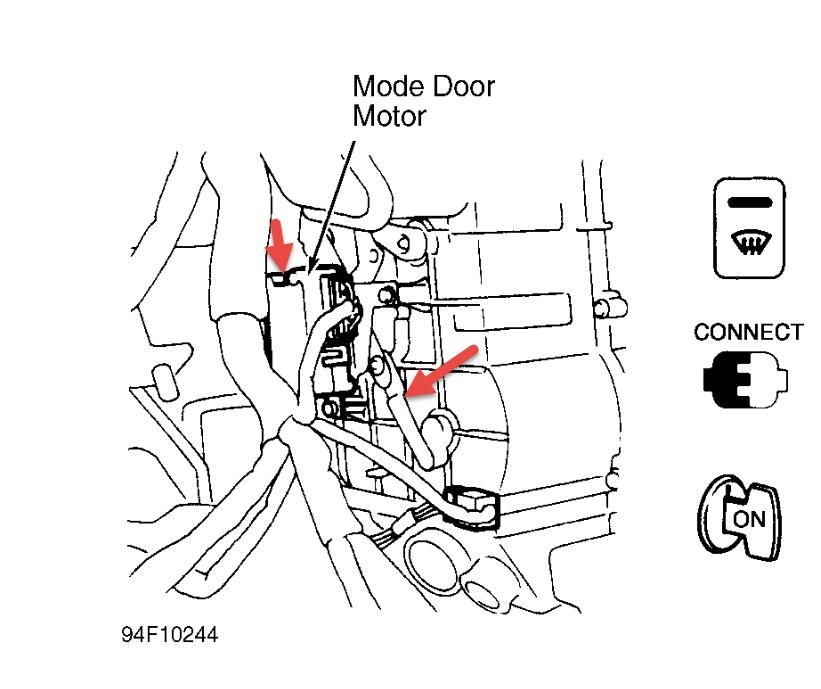

RANSOM
my vents are stuck on defrost it blows both warm and cold air but it will not switch to blowing out inside the car, nor to the feet. I need to know what to tell the mechanic and a diagram of how to fix this.
HMAC300
  • 48,601 POSTS
see if your ventmode door linage is broken or falling off then check to see if your motor is working see pic. it's electric.

SEAN PEDONE
  • 10 POSTS
Actuator replaced and air is working out of all vents when selected. Thank you for the help.
