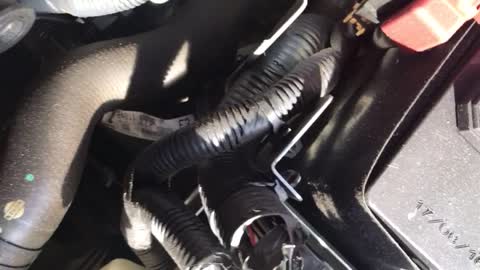

I've noticed a sound that my car makes for about 1-2 seconds when i first start up the car and continues at random times when i drive my car. Best way to describe the sound is like the old school alarm clocks that would need to be windup. I gave my car an oil change and also fueled up on Premium Fuel and neither have resolved the issue. I have no light indicators on in my dashboard but the sound does concern me since it has just recently begun. The car runs normal and I have not noticed any difference in performance since the car has started to make the sound.
Prior to this issue I had a Check Engine light indicator in my dashboard turn on for a (Mass Air Flow Sensor) and I had bought a spray for it and cleaned it myself. The Check Engine light turned off as soon as I cleaned it myself. Then 3 days later I get this ringing sound, I wonder if this is somehow related to this new issue?

Can you tell approximately where the sound comes from? Does it seem to be under the hood? And if I understand, it happens at random times. Is that correct? Is there anything you can do to make it happen? Is it possible for you to record it so I can hear it.

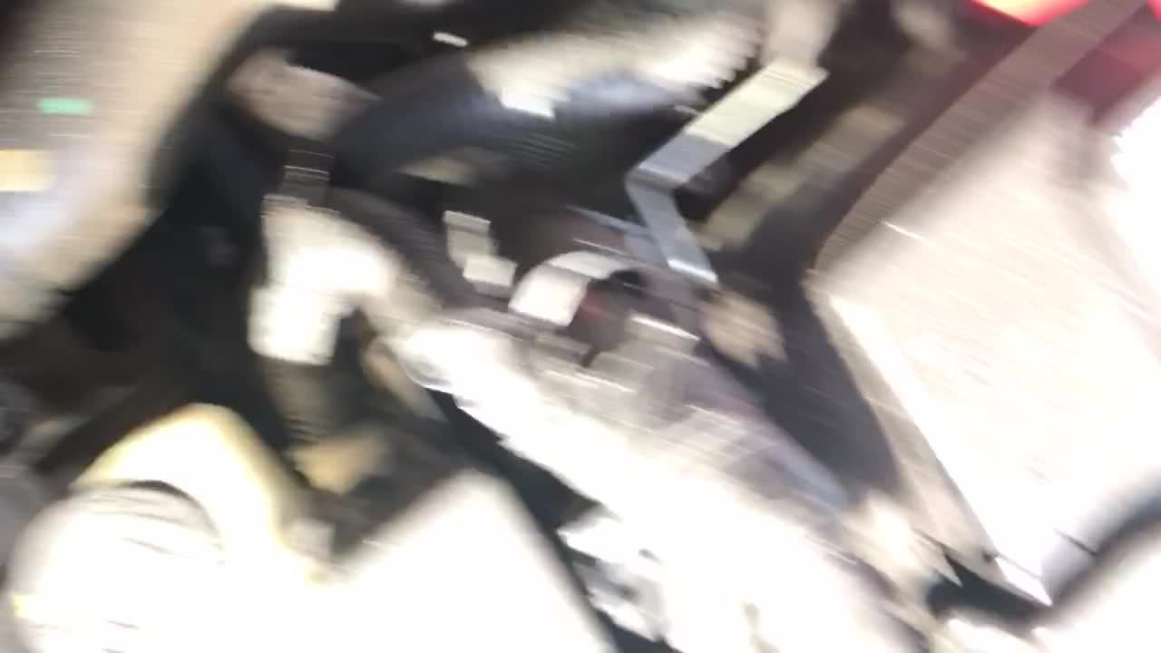

It sounds like it’s coming from the engine or something by it, I don’t really know. I hear it coming from the front right side. It makes the sound when I first turn the car on once while I have it idling. Then it continues when I accelerate the car. It happens randomly I have no control of when it happens it just makes the sound. I hope the video I’m sending helps...

I heard it. Check the heat shields on the exhaust system. I suspect one is loose. To test, take a rubber mallet and tap on the system to see if you can mirror the sound.

Hey Joe, I appreciate the help so much. My car is fixed! You were 100% correct. The heat shield was broken from one of the sides it was bolted on. I had my cousin cut the end off The broken end of the heat shield. He then bolted the one Good end back on. I got to say I’m impressed you were able to figure it out from a short video of the sound it would make. I thank you and I will tell people about this website... thank you!
