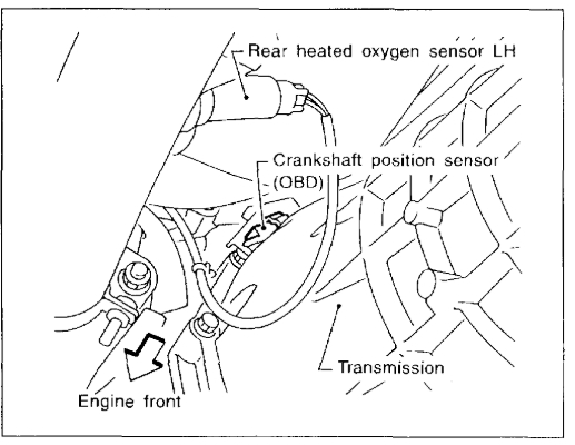

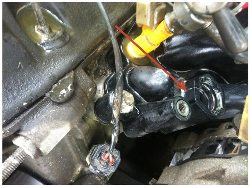

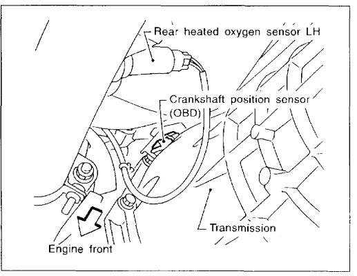

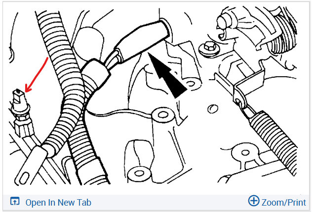

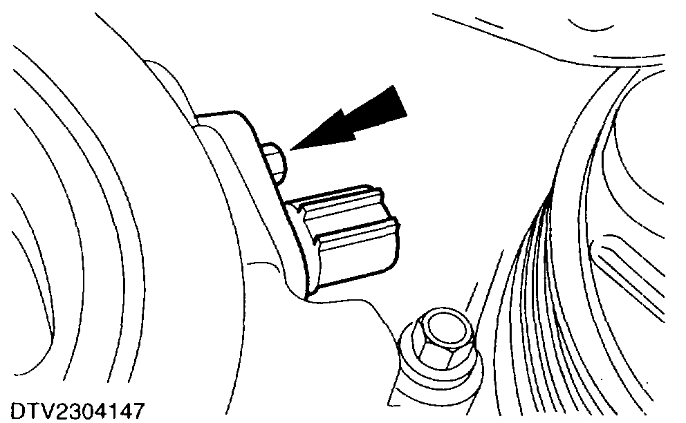

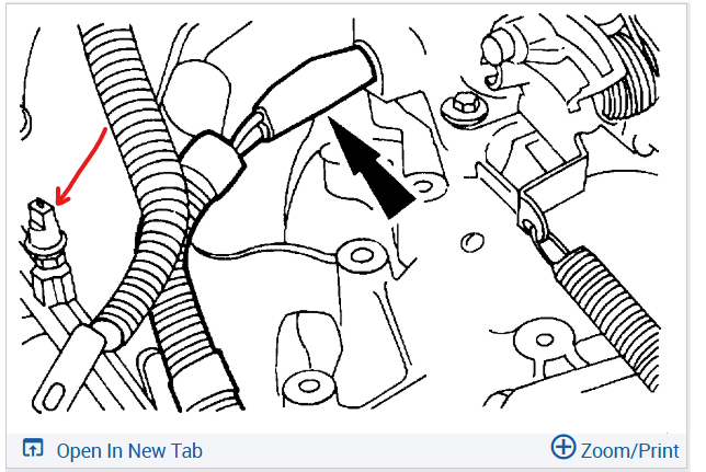

Based on your description, it could be a few things. However, my first suspect would be a bad crankshaft position sensor. Take a look through this link and see if the symptoms mirror what is discussed.
If you confirm the sensor is the issue, here is a link that shows how in general one is replaced:
_____________________________

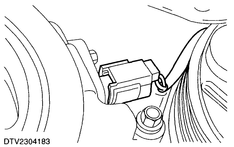

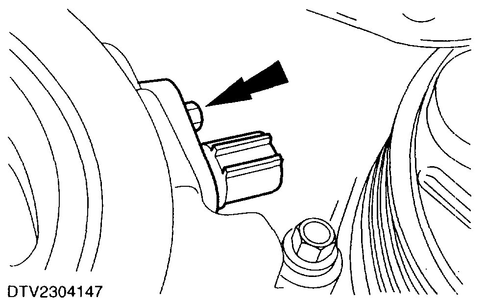

Here are the directions specific to your vehicle for replacement. All attached pictures correlate with these directions.
PROCEDURES
REMOVAL
1. Remove the lower right hand fender splash shield.
2. Disconnect the Crankshaft Position (CKP) sensor electrical connector.
3. Remove the CKP sensor.
INSTALLATION
1. To install, reverse the removal procedure.

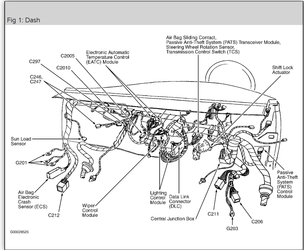

It tries to stall when putting it into P-D as soon as I step on the gas it just shuts off.

Is the check engine light staying on when the engine is running? Have you scanned for trouble codes? Based on your description, it could be a few different things. Therefore, if the check engine light is on, we need to know what diagnostic trouble code or codes are stored. That way, we know for sure what system to focus on.

No check engine light at all. No oil lights. No lights on dash. No codes. Nothing.

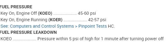

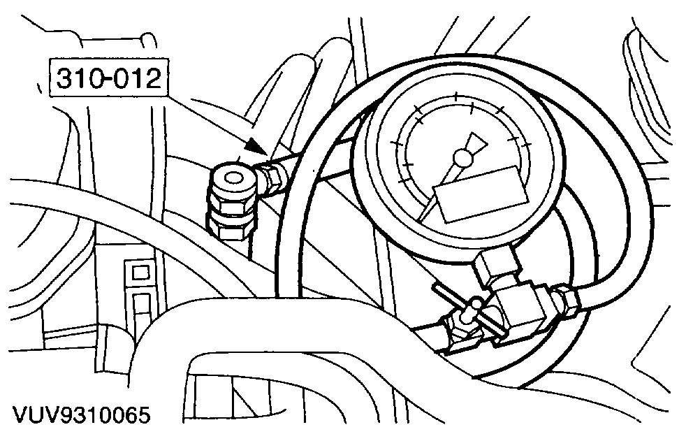

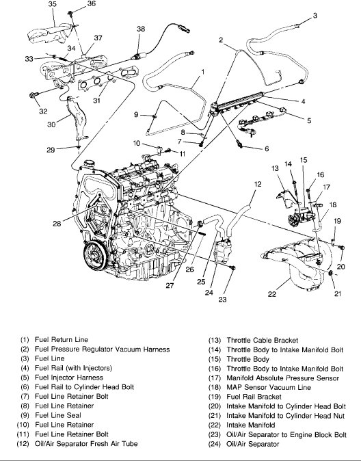

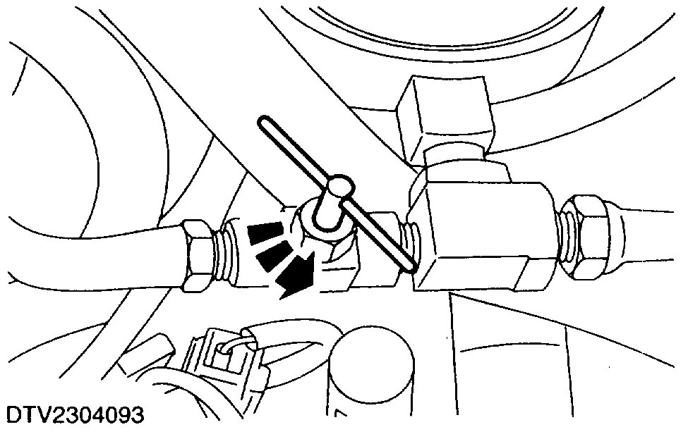

Since there are no codes, we need to check for fuel pressure as well as if there is spark to the plugs.
Here is a link that shows how to check fuel pressure:

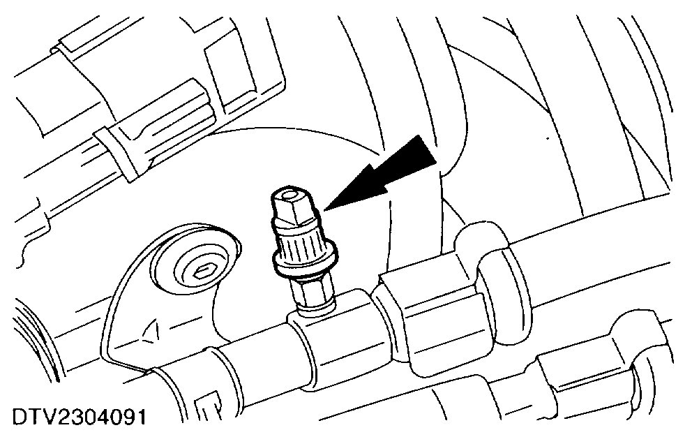

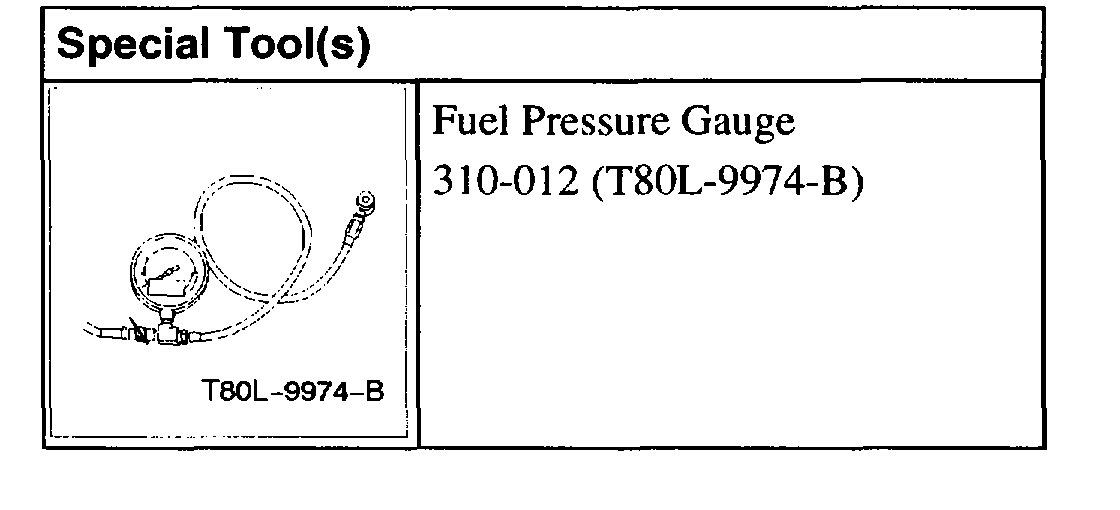

Here are the directions for testing pressure specific to your vehicle. The attached pics correlate with these directions. Also, the fuel pressure specifications are listed.
Special Tool(s)
Fuel Pressure Gauge
Fuel pressure release procedure
Warning: do not smoke or carry lighted tobacco or open flame of any type when working on or near any fuel related components. Highly flammable vapors are always present and may ignite. Failure to follow these instructions may result in personal injury.
the fuel system remains pressurized for a long time after the ignition is switched off. The fuel pressure must be relieved before attempting any repairs. Failure to follow these instructions may result in personal injury.
1. Disconnect the battery ground cable.
2. Remove the air cleaner outlet tube.
3. Remove the Schrader valve cap.
4. Connect the Fuel Pressure Gauge to the Schrader valve.
Warning: make sure that the tap is turned fully clockwise before fitting the fuel pressure gauge to the schrader valve. failure to follow these instructions may result in personal injury
5. Turn the tap on the Fuel Pressure Gauge fully counterclockwise to relieve the fuel pressure.
NOTE: When relieving the fuel pressure, catch any displaced fuel in a suitable container.
6. Remove the Fuel Pressure Gauge and install the Schrader valve cap.
We have to start somewhere since there are no codes. Fuel pressure is the best place to start. Also, check and for vacuum leaks.
