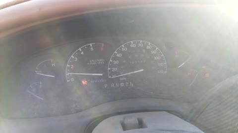

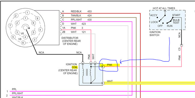

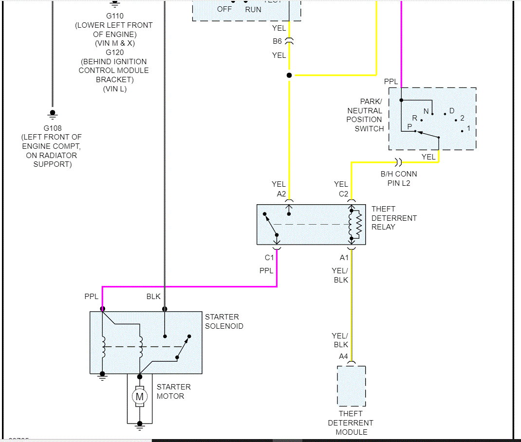

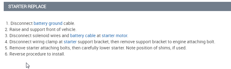

Replaced starter, it tries to start then immediately shuts off afterwards small backfire. any suggestions?
Dec 1, 2019 at 1:42 AM
I may be stumped on this one like you are because replacing the starter would not cause this. Did you replace the starter and this happened immediately or has it been some amount of time since the starter was replaced? Also, was the vehicle running prior to this and it is now doing this?
Basically I am trying to find out if there is more to the story because this is not adding up yet. Thanks
