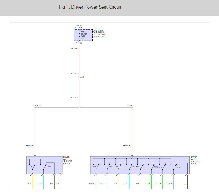

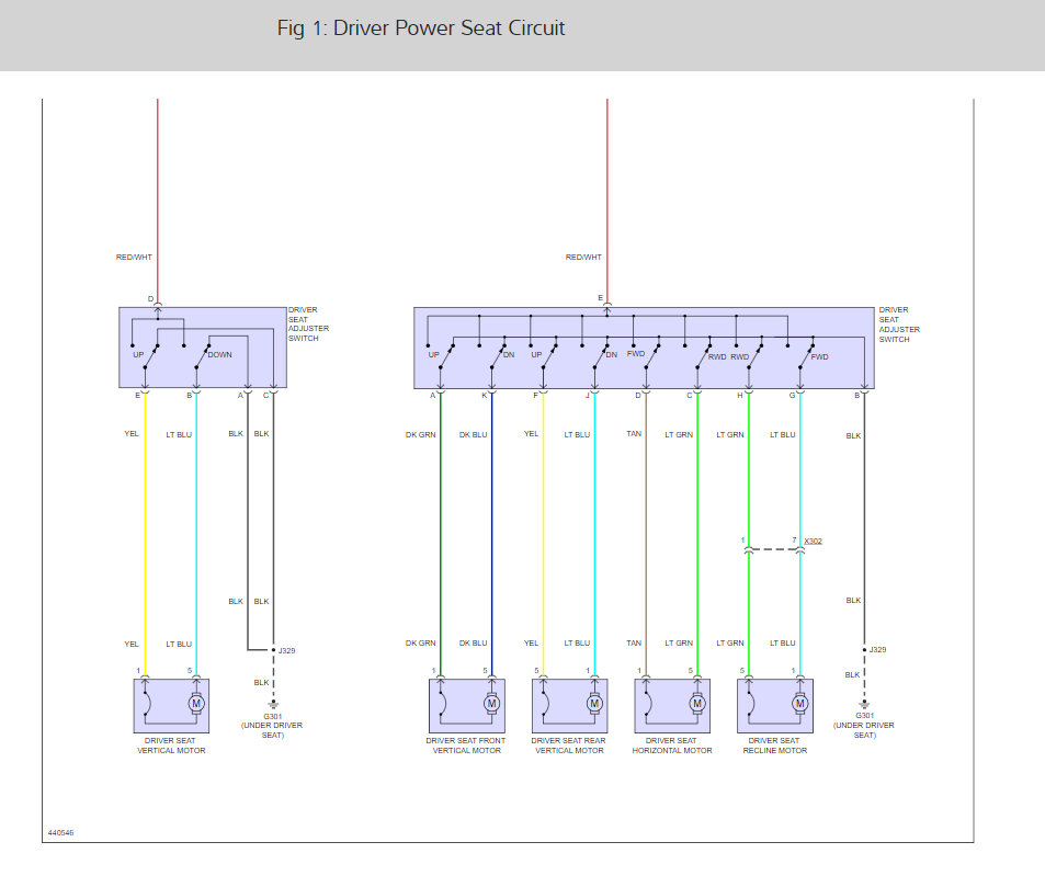

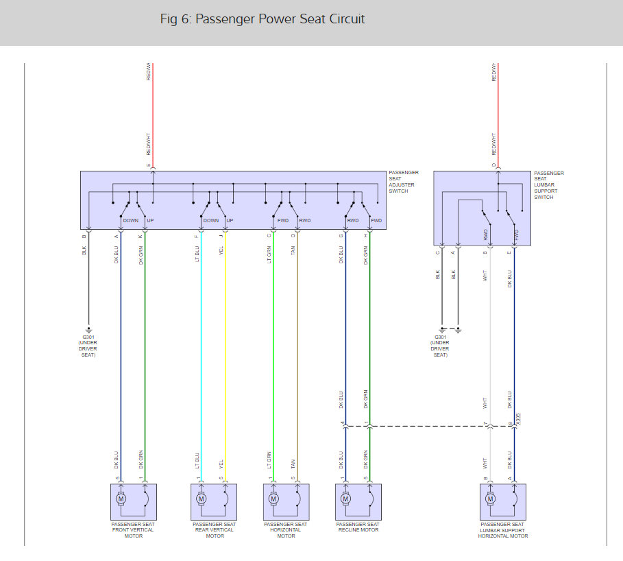

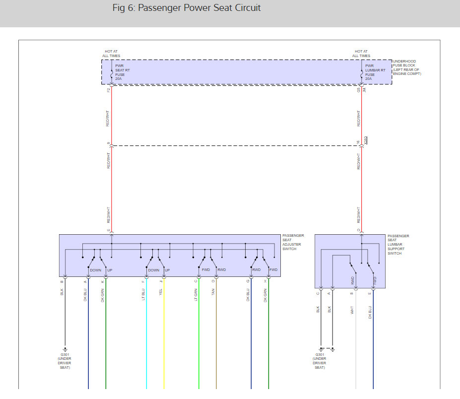

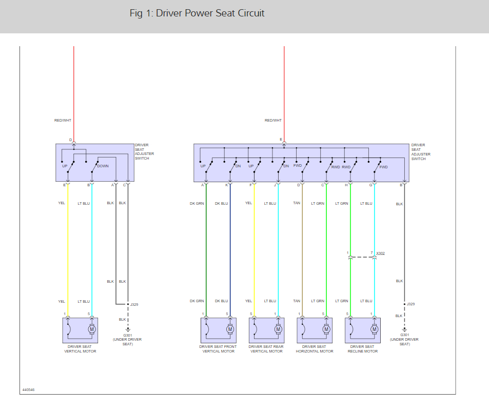

Swapping out seats, to eight way power.
Have passenger seat working, can't figure out how to bypass memory module, so wanted to know if harness (part # 23247221) will work on drivers seat?
Mar 18, 2019 at 6:01 AM
  • 55,399 POSTS
I don't know if you can bypass the module. Here are the seat wiring diagrams and a guide to help you trace the wires by checking the colors and connector configuration.

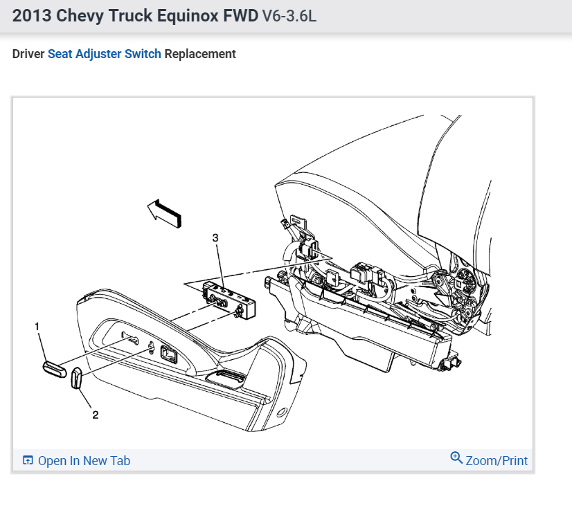

CRAIGMCCARTHY63

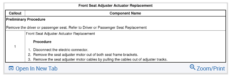

The driver seat is completely prone. Is there a way to manually raise the reclined seat without the electric motor?
Jul 21, 2020 at 10:19 AM (Merged)
  • 55,399 POSTS

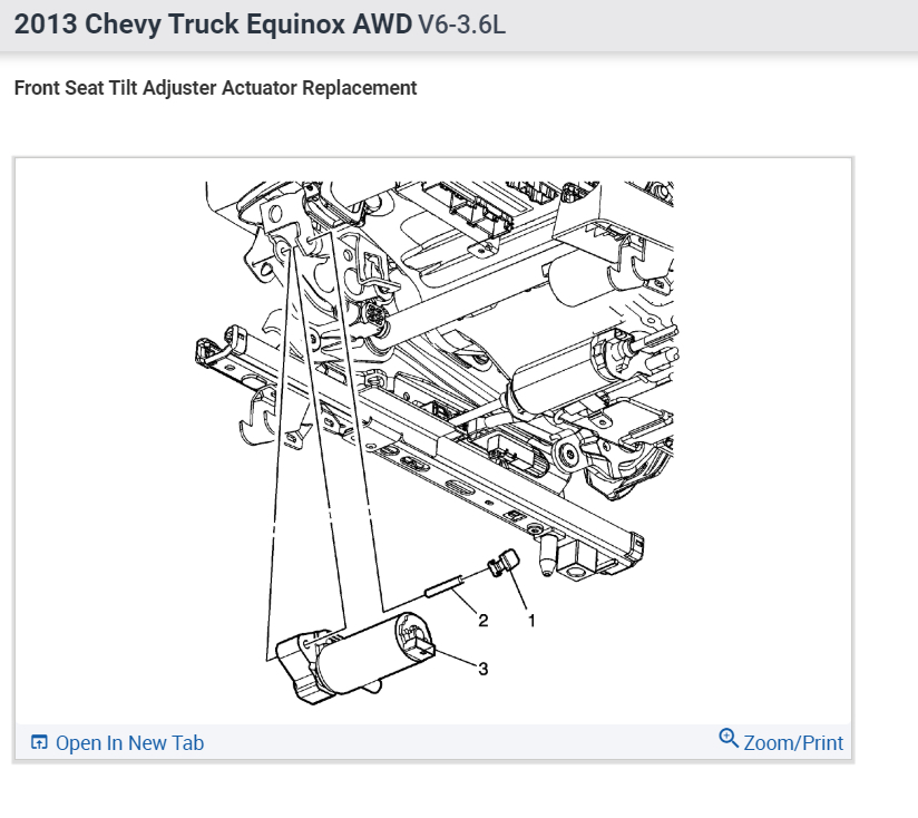

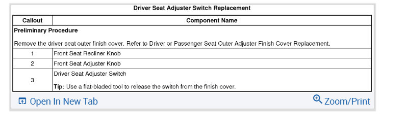

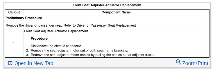

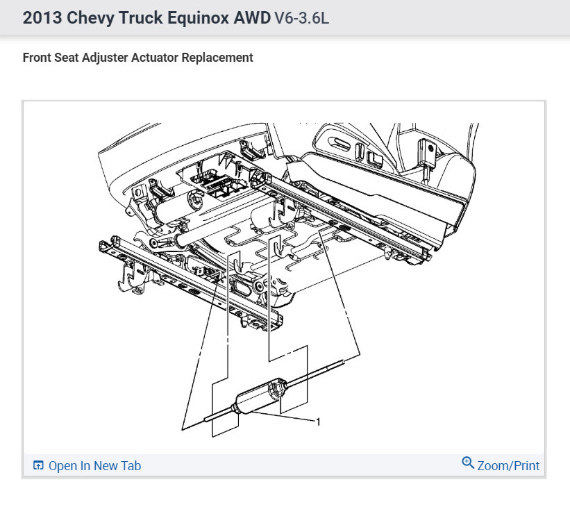

No, the motor must work to move the seat. it could be the switch causing the issue. here is a video of the switch getting replaced on a similar car with diagrams and instructions below for your car:
https://youtu.be/xLHNfnSdrVQ
I have included the sdat motor location and how to replace them in the diagrams below. Check out the diagrams (Below). Please let us know what happens.

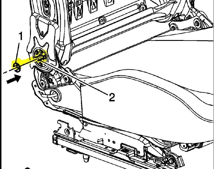

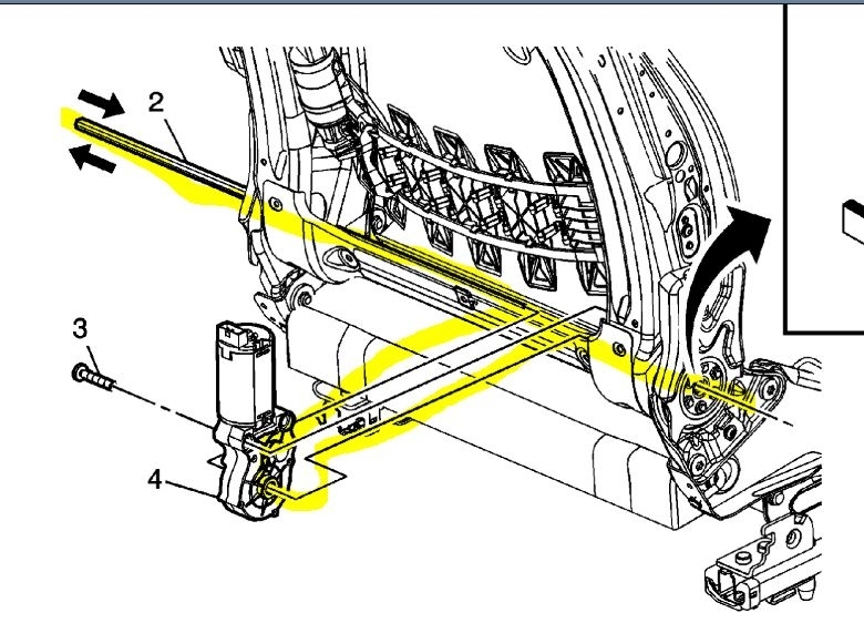

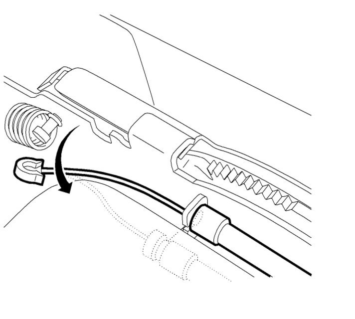

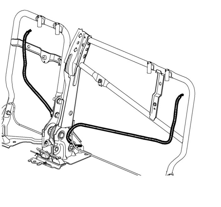

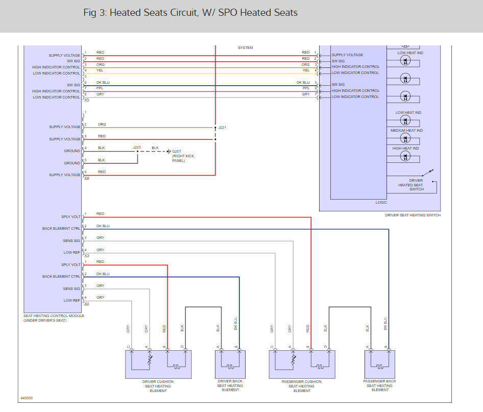

RBRTSN

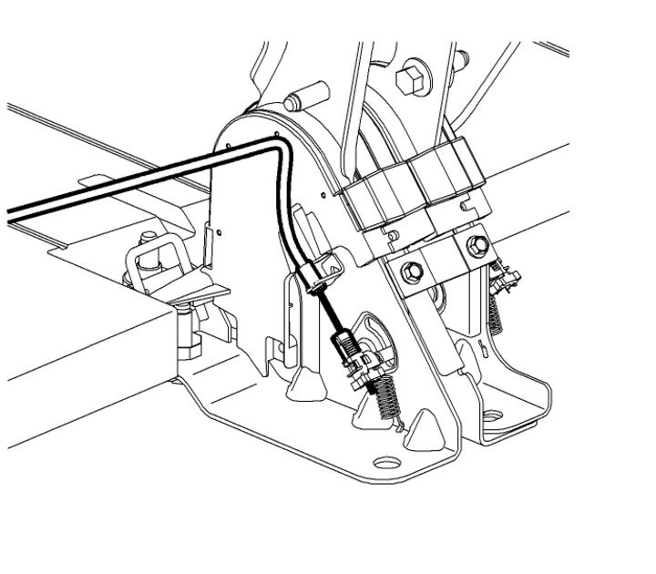

Just started tonight. Thoughts, Ideas? Is this something I could fix on my own?
On separate note lumbar quit working years ago, Can this be fixed too?
Figured if I'm tearing it apart.
  • 110,241 POSTS

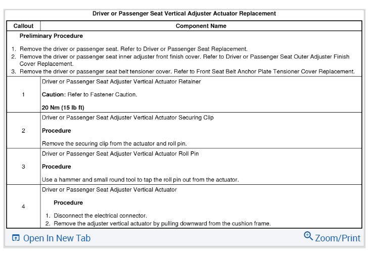

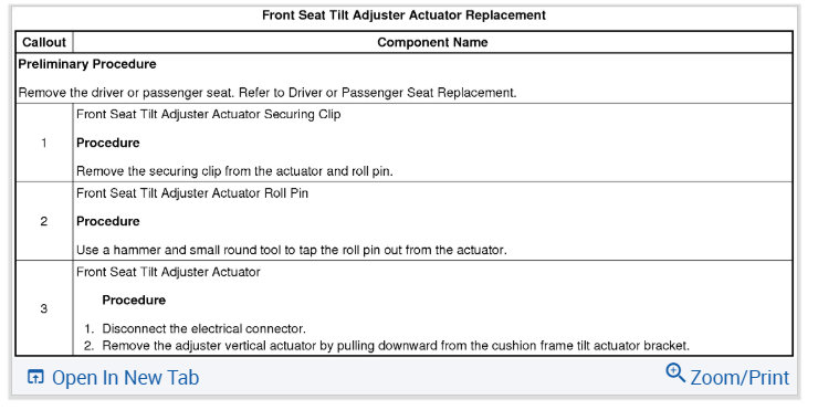

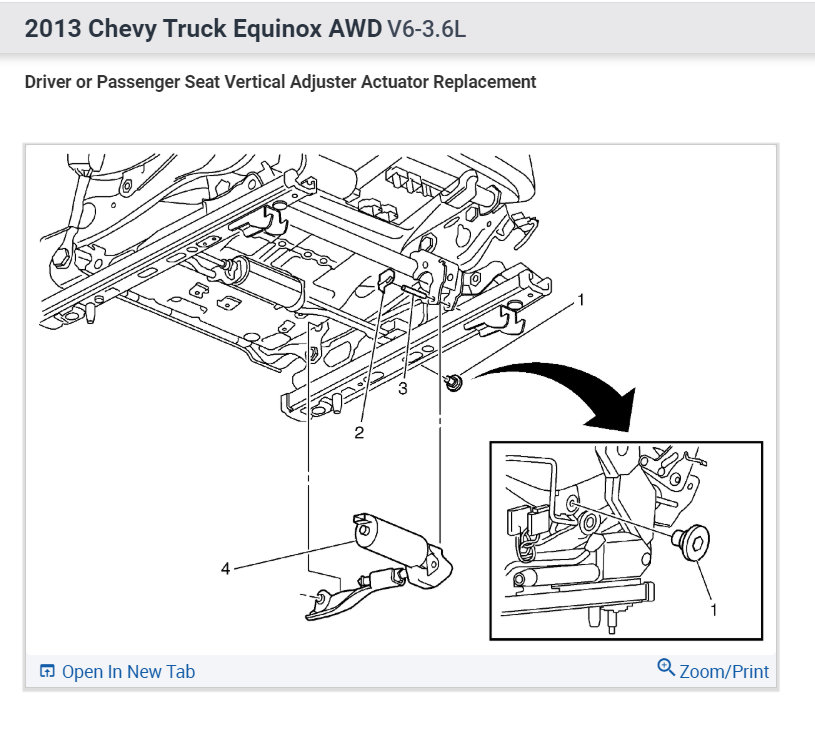

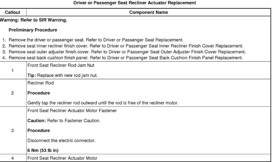

There is a recliner rod that runs to each side of the seat to recline it. In addition, the rod runs the a motor which moves the seat. There is a chance the rod has broken or come disconnected at one point. There is a jam nut that holds the rod in place. It may have come off. Also, make sure nothing is blocking the seat and preventing it from moving.
If you look at pic 1, I highlighted the rod I am referring to. The second picture is the directions for motor replacement. Pic 3 shows the location of the jam nut. I don't think you need the motor, but the one in it will need removed and replaced if the rod is the issue.
Take a look through the directions and let me know if you have questions.

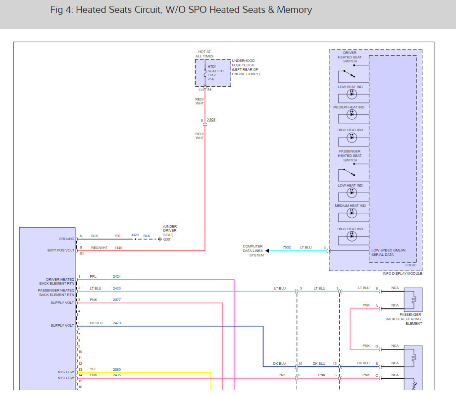

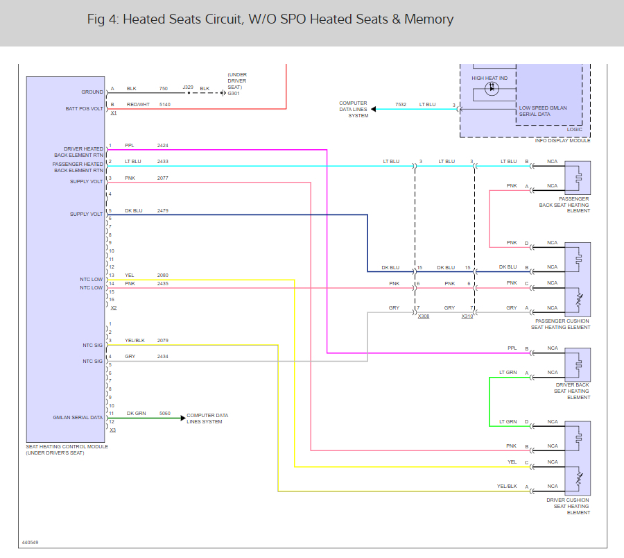

BURTON ROBERTSON
Yes, that was the problem. got it working. it it is great except, when we put the seat back in the car it is still crooked and doesn't work. Thinking the seat frame is bent.

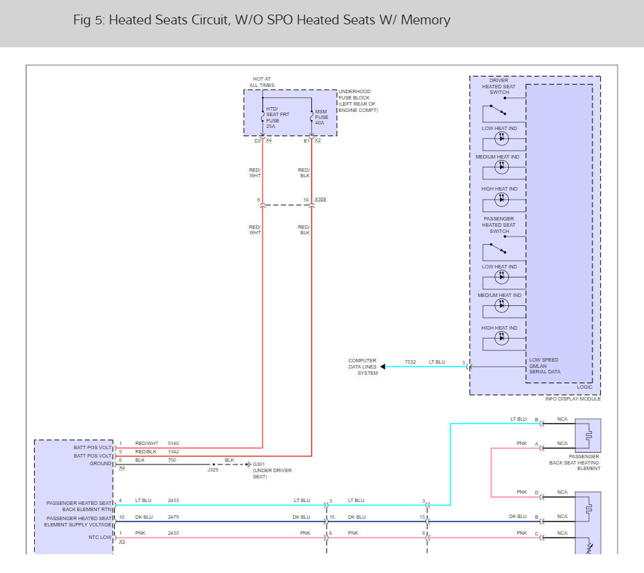

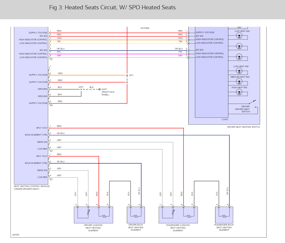

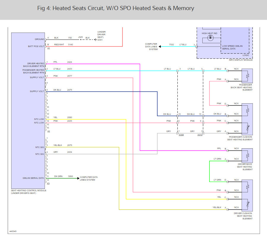

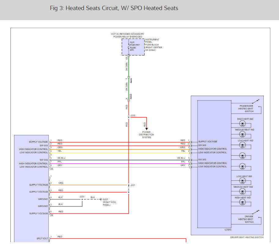

If I replace the seat can I upgrade to a heated seat or is this a big project? Not sure what additional wiring would be involved?
  • 110,241 POSTS
The frame may be bent. Are you sure when you reattached the rod that everything was straight? It isn't hard to not have it straight. LOL
As far as the heated seat, that is a much bigger job than one would think. It will require a different body control module as well as a few other things. I have to be totally honest. I wouldn't do it. It will be more expensive than you think.

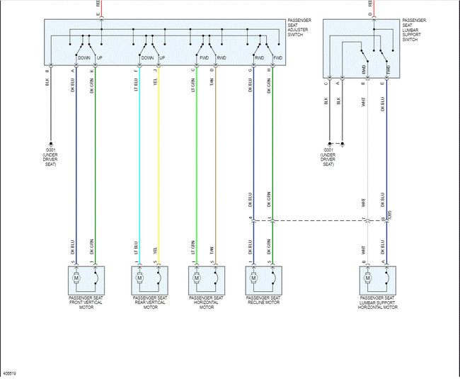

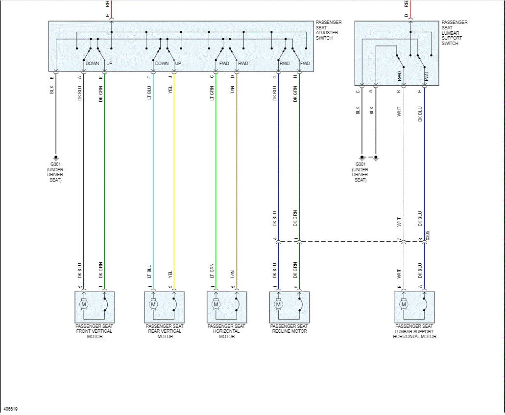

GEORGE D MILLER

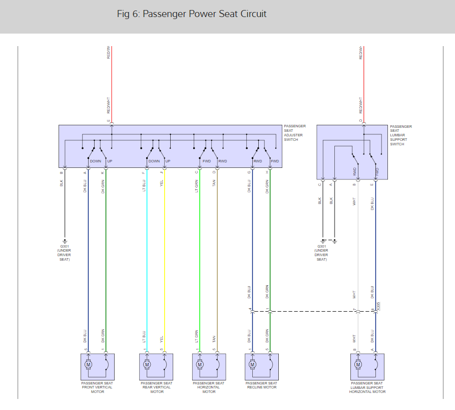

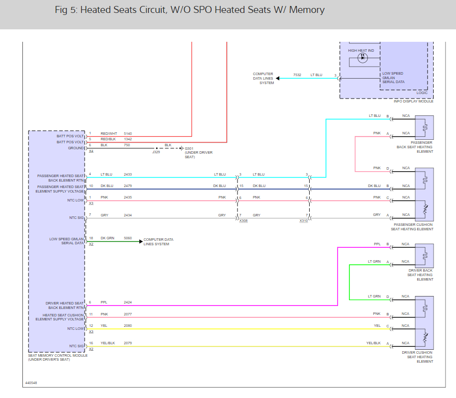

I have a manual passengers seat and a 8 way drivers seat. Can the passenger seat be replaced with a 8 way passengers seat?
  • 110,241 POSTS

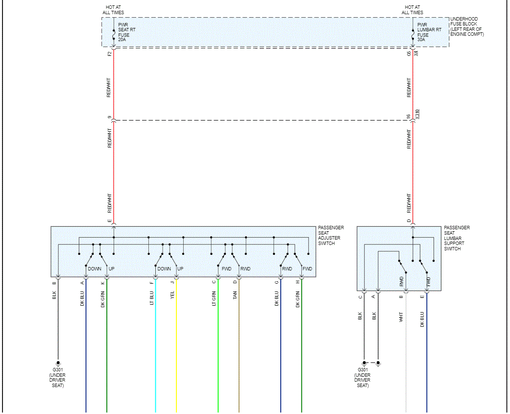

You are likely able to do this. I have reviewed the wiring schematics, and from what I see, you simply need to supply two power supplies the the two switches on the seat.
Now, the schematic shows the original location where the fuses would be. Since the vehicle wasn't ordered with a power passenger seat, chances are they will not be there. So, you will likely need to find a power supply and then using an inline fuse (which you can get at any parts store) and provide a 20 amp fuse for the lower seat controls and a 30 amp inline fuse for the lumbar control.
Take a look at the wiring schematic I attached. I had to cut it in half to make it readable. I did overlap the two halves so you can easily follow it.

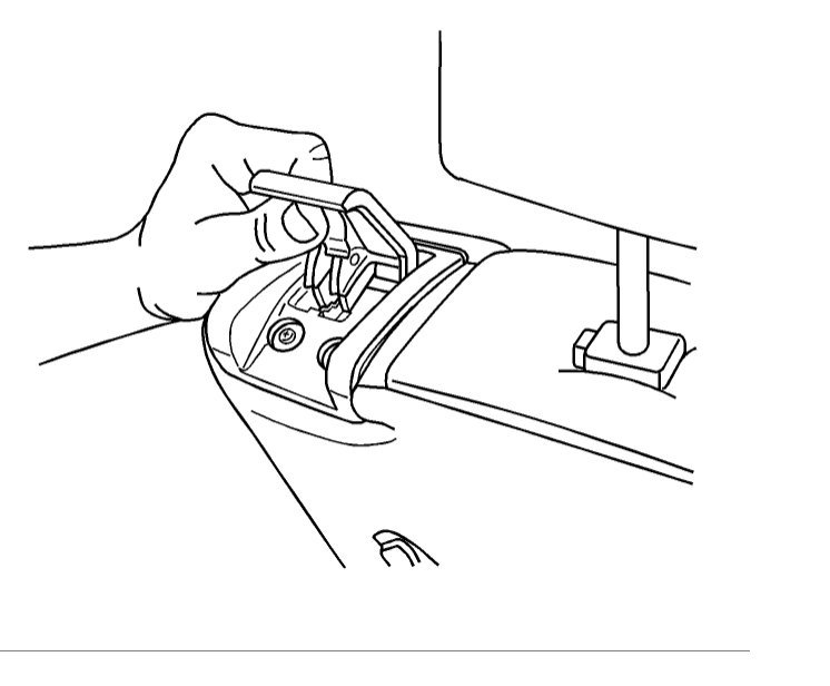

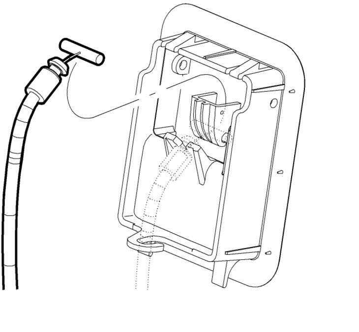

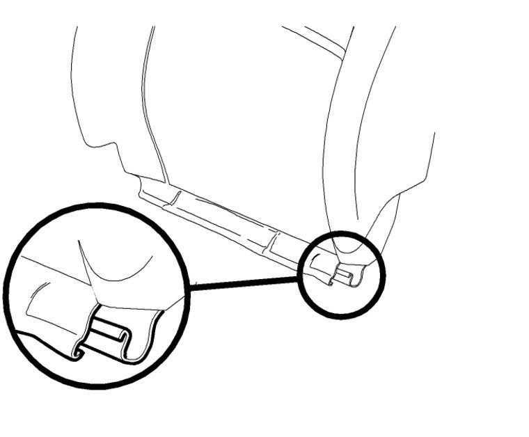

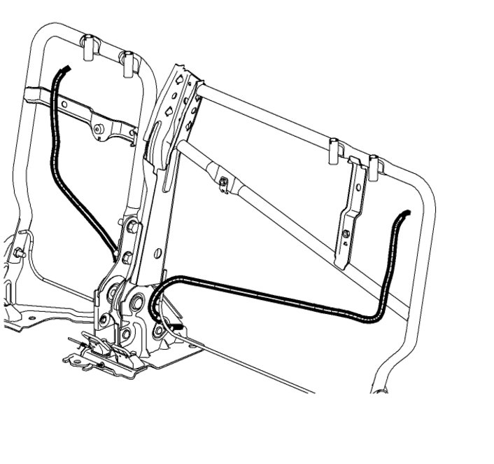

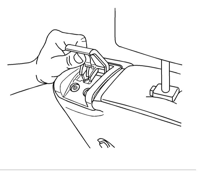

ROCKIN64
Interior problem 6 cyl Front Wheel Drive Automatic 15000 miles

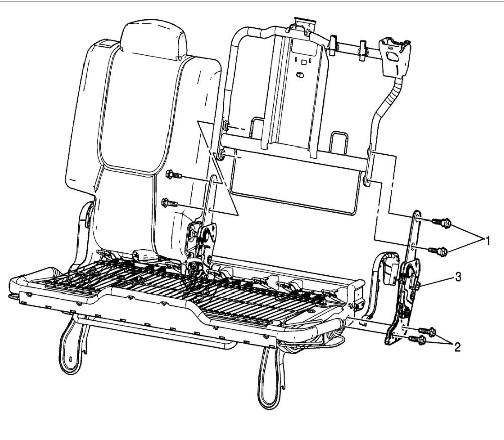

The rear seat on the passenger side won't fold down. The lever can't be pulled up, it seems to be stuck.
  • 55,399 POSTS
This should be one of three problems, either the cable is broken or the release handle is worn and not pulling the cable to release the seat back. Something can be stuck in the track like an ink pen use a flashlight and look down inside.
Here are some diagram (BELOW) to help you get the problem fixed.
