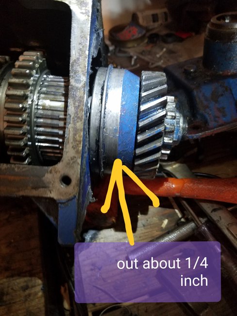

Pulled the transmission and transfer case. Separated transmission and transfer case and rear bearing adapter came out of transmission. If this was a little bit loose to start with would it cause the first gear problems or would all the gears have problems/

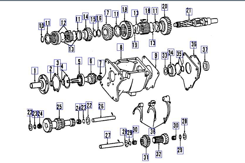

Which bearing main shaft? Counter shaft? Idler shaft?
Can you post a picture?

It is the main shaft where it mounts to the transfer case.

Yes, it could by upsetting the balance of the main shaft.
