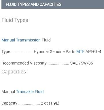

Dealer replaced gearbox oil for the 1st time with a 80w90 one, assuming the original oil was 75w85, the only one recommended in the owner manual.
Living in a hot country, always a heavy traffic one (shifting a lot), l noticed slight difficulty shifting back to 1st gear while car is crawling (need to go a bit slower than before).
Maybe because oil is new, will become business as usual next few months?
Thanks
May 4, 2019 at 10:15 AM
  • 110,244 POSTS
Welcome to 2CarPros.
You are correct. The fluid that was installed is heaver than the manufacturer's recommendation, and that can be what is causing what is happening.
I would recommend taking it back and have them install the correct weight of oil. Please keep in mind, the manufacturer takes into consideration different temps when engineering the vehicle. They know best.

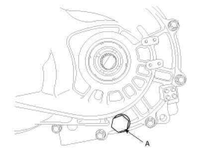

I attached a picture which indicates the recommended weight and capacity. Also, if you want to do it yourself, here are the directions. The remaining pictures correlate with these directions.
_____________________
PROCEDURES
Service Adjustment Procedure
Transaxle Gear Oil Level
Replacement
1. With the vehicle parked on a level surface, remove the drain plug.
2. Drain the transaxle oil after loosening the drain plug(A).
picture 2
3. Install the drain plug with new washer.
Drain plug tightening torque:
60-80 Nm (600-800 kg-cm, 43-58 lb-ft)
4. Add new oil through the file plug hole and, fill it just below the plug opening.
Standard oil SAE 75W/85, API GL-4
Oil capacity:1.9 liter (2.0 US qt, 1.67 lmp qt)

The main difference in these oils is the fact that the 75w-85 is rated to go to -40 degrees. The other is only -20.
The difference between the 85 and 90 is the 90 is a little bit thicker that the 85. This may be where your shifting issue is coming from. I wouldn't think so because once the fluid is hot it should be fine but if you didn't have it before and now you do, the thicker fluid could cause it.
I wouldn't change it again unless you want to be safe and stick to what the OEM says to use. I always do just because they designed and engineered the product using that fluid.
Hopefully this helps. Please let me know if you have any questions. Thanks

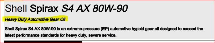

Found this at:
http://shop.sclubricants.com/shell-spirax-s4-ax-80w-90
Below at:
Detailed Product Description:
Shell Spirax S4 AX 80W-90 is a premium all-season, multigrade gear oil designed to exceed Original Equipment Manufacturers' lubrication requirements under today’s increased temperature and loads.
Also within:
Shell "Technical Data Sheet" link the same page below at:
"Download the TDS"
Or simply at:
http://shop.sclubricants.com/pub/media/pds/shell/Spirax-S4-AX-80W-90.pdf
Anyway, would this make any difference, many thanks.
May 6, 2019 at 10:14 AM
It says right on the document that this is for heavy duty application. Your gear box is not under heavy duty use. This is an industry term that is meant for heavy hauling like work trucks, police cars, mail carrier vehicles. These types of vehicles run all day and are run hard. Passenger cars do not fall under this category.
I would have it changed if for no other reason that it was not designed for it. Not to mention you are experiencing an issue after they did it.
May 6, 2019 at 10:25 AM
