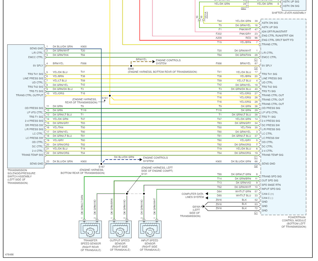

62te Transmission issues. Check engine light came on about 3 weeks ago for low fluid pressure I added fluid, but it didn’t help so I took it to Aamco, and it had codes p1745 p0869 p0933 p0934. now I won’t shift out of 1st gear it’s in limp mode I replaced the transmission pressure sensor, the filter and fluid still have the same issue.
Jul 19, 2023 at 12:39 AM
  • 55,216 POSTS

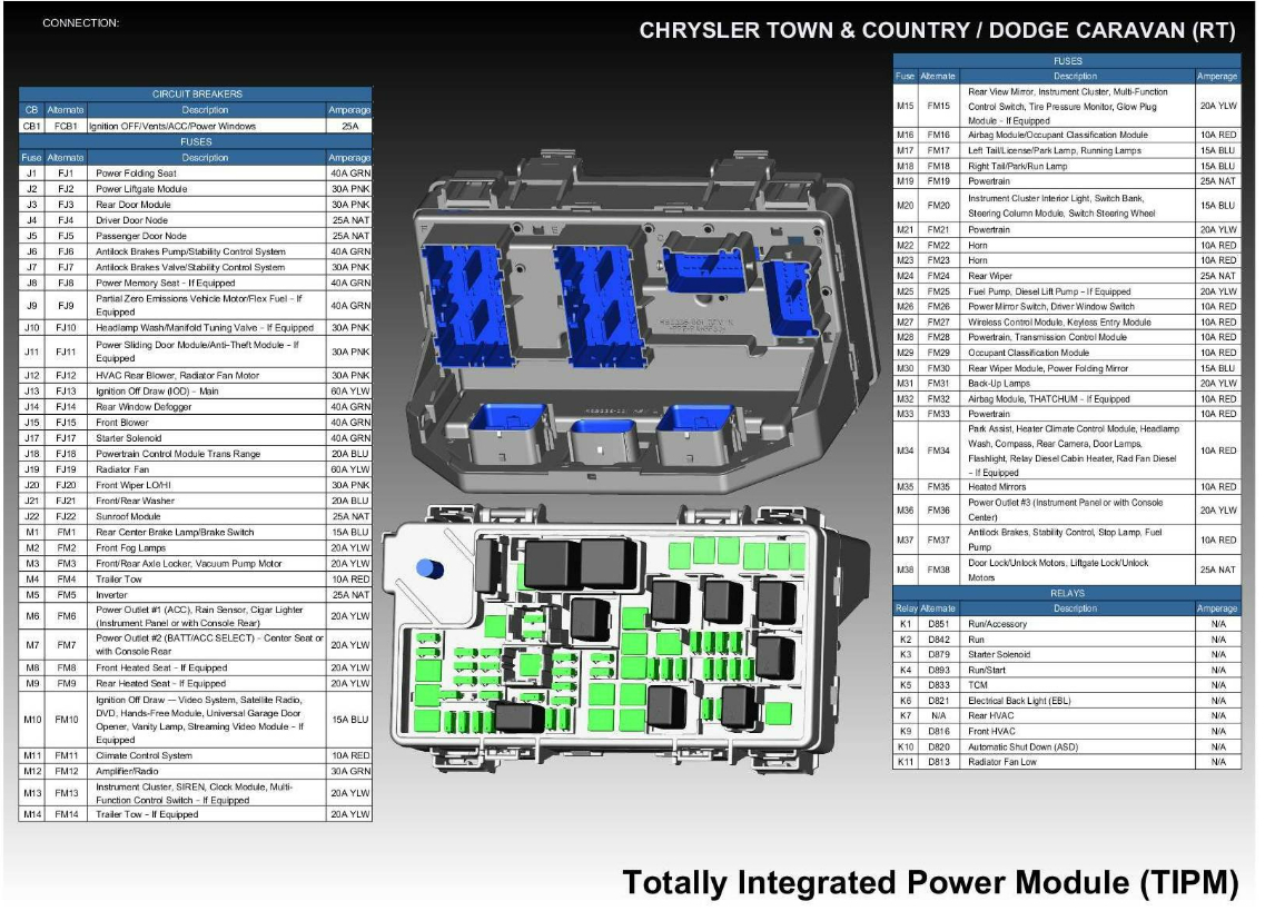

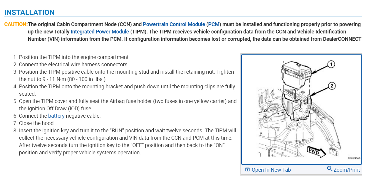

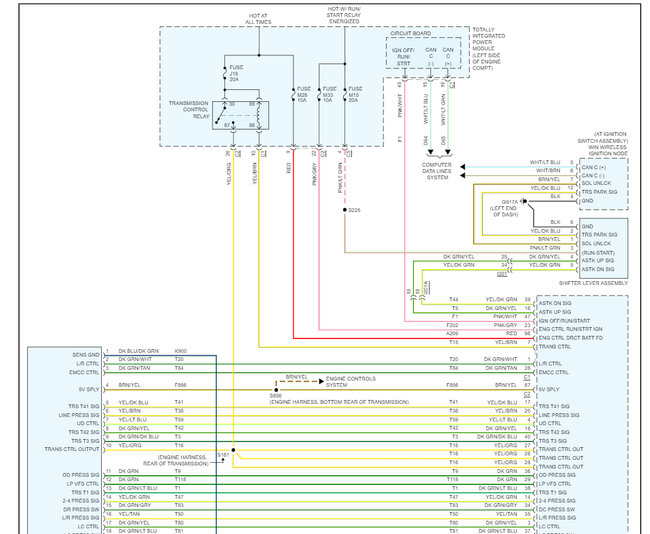

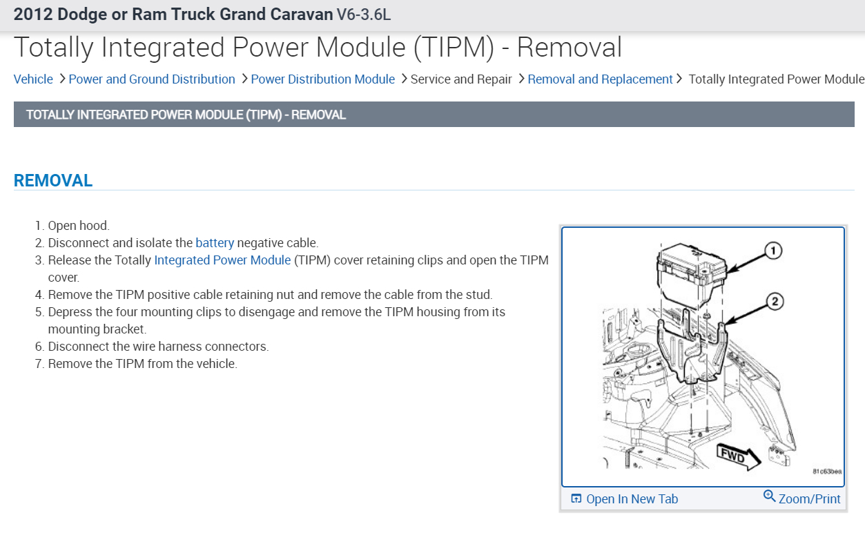

These codes are all for the transmission pressure sensor or circuit. I have seen the TIPM go out on these vehicles which will cause this issue. Here is the location of the module. I would remove the electrical connectors and check them for water damage, overheated. I have included the transmission wiring diagrams so you can see how the system works.

Let's check the m28, m33 and m15 fuses for power in the under-hood fuse panel (TIPM) The transmission control relay (on pcb) is not serviceable.
Check out the images (below). Please let us know how it goes
