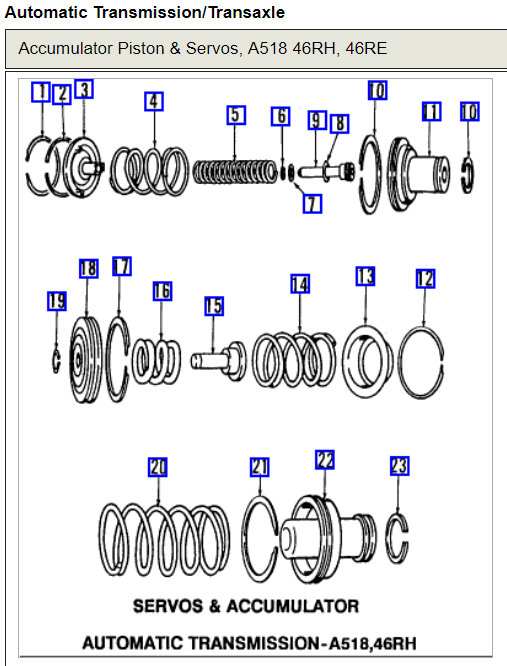

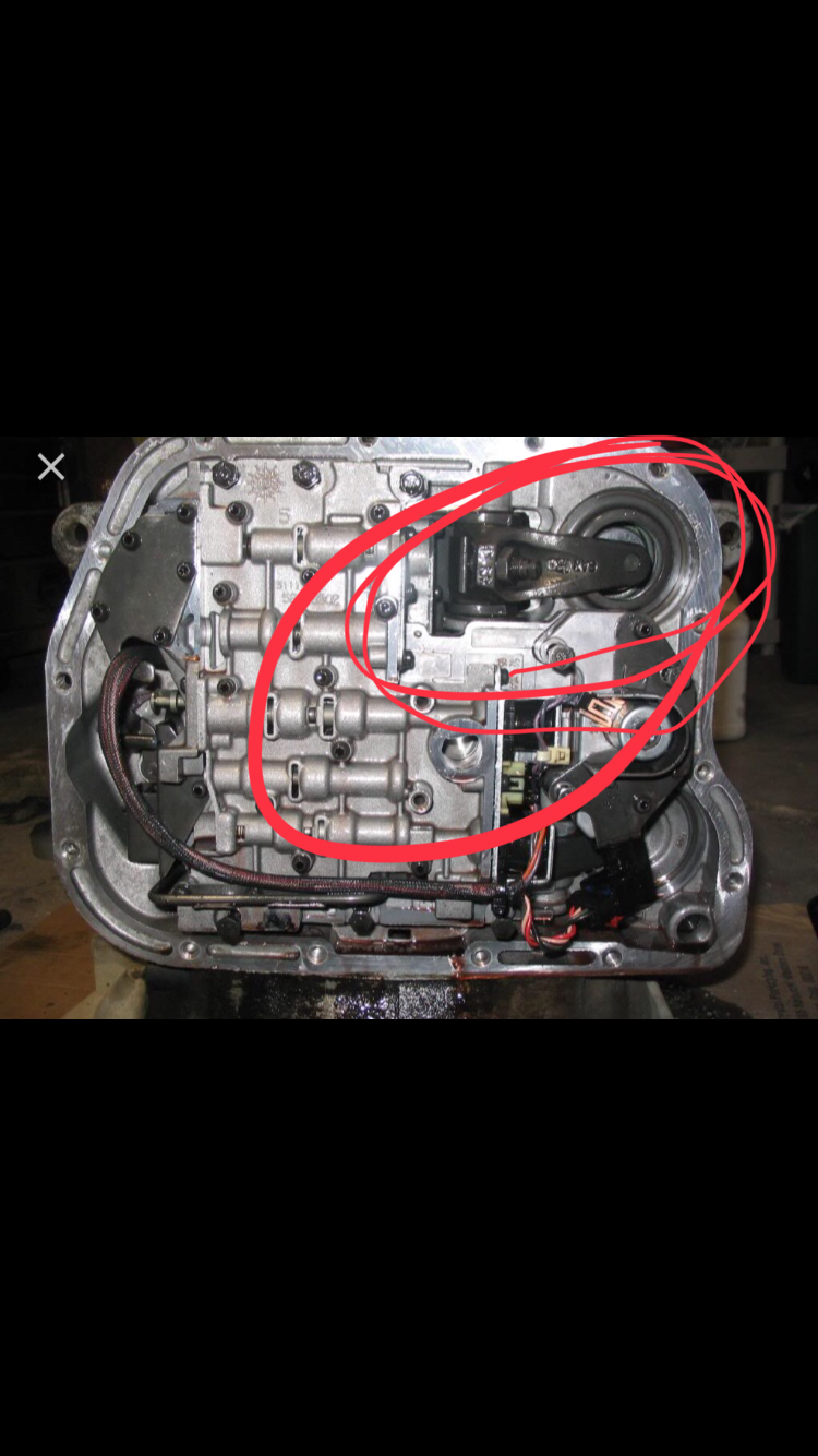

So in March of this year my truck's (1500) transmission started slipping in overdrive. When I dropped the transmission pan down I noticed my front servo had a small crack in it. I changed the fluid and filter and the throttle body sensors and it seemed to help but, it still jumps every once in a while in overdrive. I was wondering if I need to drop the transmission down to replace the servo? Directions would be great! I have rebuilt manual transmissions but I do not know to much about automatic transmissions! Any help would be great! IT has a 46re transmission Thanks!

Usually the servo housing is part of the case. Do you have a picture of what you are looking at?

RYAN177
Yes, just found one on the internet. The housing is not cracked it is the bottom round piece.

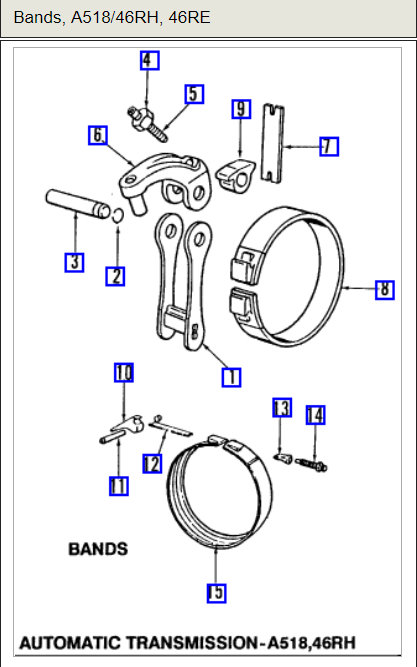

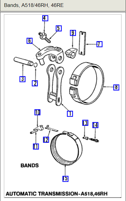

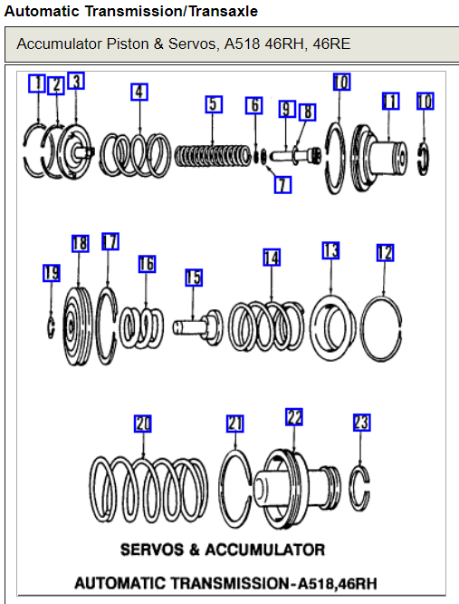

  • 55,264 POSTS
It looks like you can change that out without removing the transmission there is a pin that holds the lever arm in to the case which you will need to remove. Here is a guide on the servo so you can see what you are in for it will be spring loaded so be careful.
