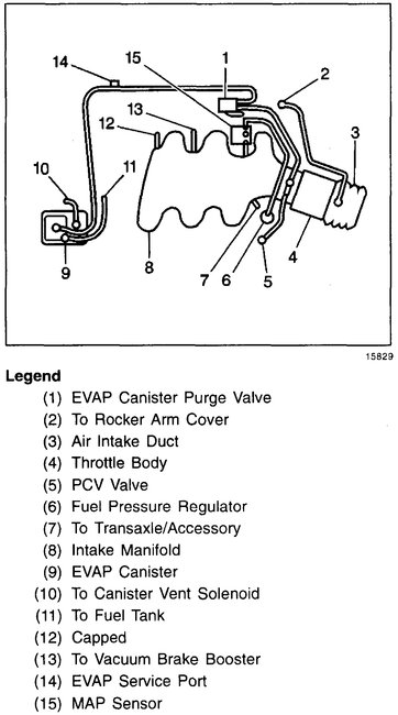

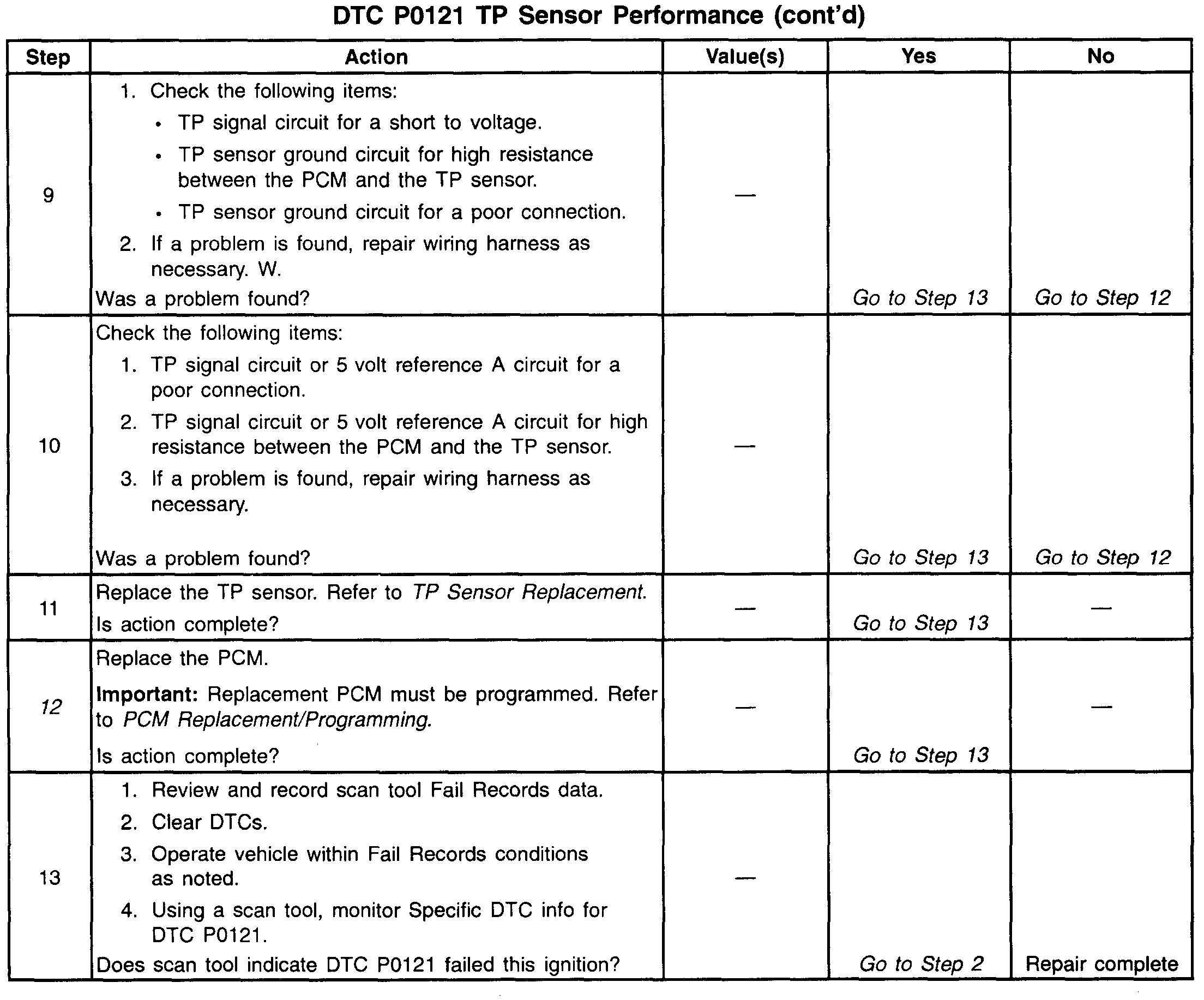

No vacuum diagram anywhere on car shows misfire on number two. cylinder misses bad at idle, but has plenty of power driving. it sounds like vacuum leak. need vacuum specs.

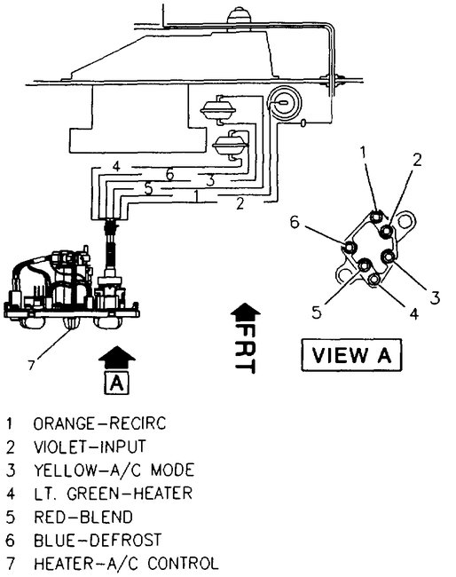

As far as the vacuum schematics, below are two pics. The first is for emissions. The second is related to the HVAC system.

First drove car on freeway about 25 miles then had to drive another 8 miles down a country road about last 2 miles gravel and dirt road with like a washboard for a road. had a bad wind storm for 2 days counting that day , branches acorn 40 MPH winds rattled car pretty good. got to brothers house sound and ran fine before we went inside about 2 hours. went to leave got about half mile made a noise like rock in hubcap keep going about 2 miles was get worried turn around headed back to his house barely made it back 2 hills on way, pedal to floor crawled back. anyway, ran scan on car said EGR valve code pulled air filter box open was full of broke up acorn and dust lots clean out new filter EGR valve new . bought all new coils plug wires plugs ran scan again say #2 cylinder misfire. runs rough idle had enough to baby it back home. wife's car thinks it's a waste of money not sure should i try erasing codes at one time after EGR valve replace. ran scan says problem with TPS but come up #2 cylinder misfire. sorry about rambling on help if can.

P0121, p0401, and p0302. first EGR valve code replaced with new one then p0121. cleaned throttle body with throttle body cleaner , replace spark plugs and wires all OEM parts and all coils that's when TPS code and #2 cylinder code showed up , sprayed MAF sensor with MAF spray sound's like noise under the car , have bought new Innova 340 rs scanner but no WIFI access to record live data or even data to have someone analysis by even Bluetooth.

The two codes, 121 and 401, as you know are related to the MAP and the EGR. For the 121 to set, It indicates there is a skewed Manifold Absolute Pressure (MAP) signal or faulty MAP sensor. This can be tied into the MAP, throttle position sensor (TPS), a wiring problem, or faulty PCM.
I'm going to provide the diagnostics. However, before testing, let me know if there could possibly be an issue with the catalytic being plugged. That will create a difference in the manifold pressure. I remember you mentioning the rattling sound like stones in hubcaps. I'm wondering if the internal portion of the converter is loose. It's just a theory at this time but hang in there. We'll figure it out. Also, there could be an issue with the MAP and not the MAF which you cleaned.

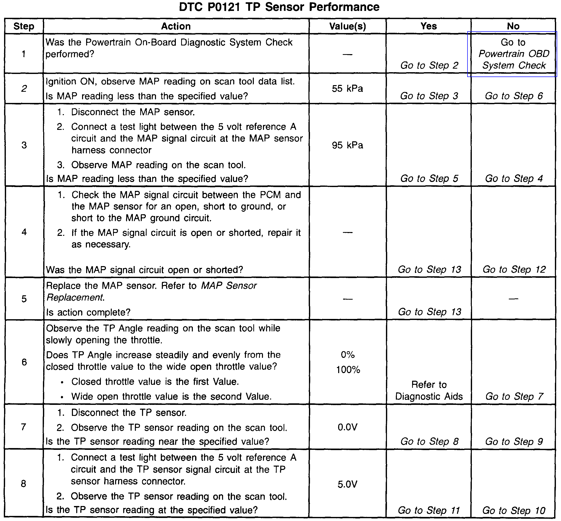

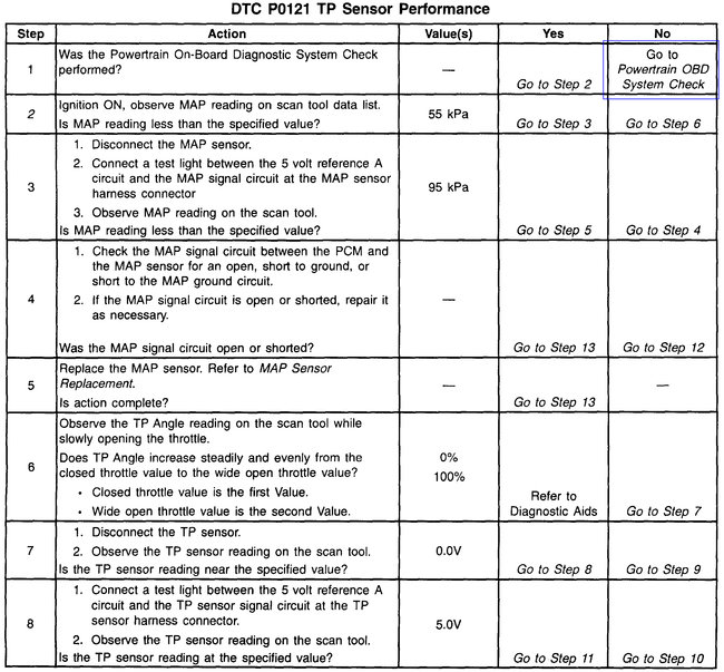

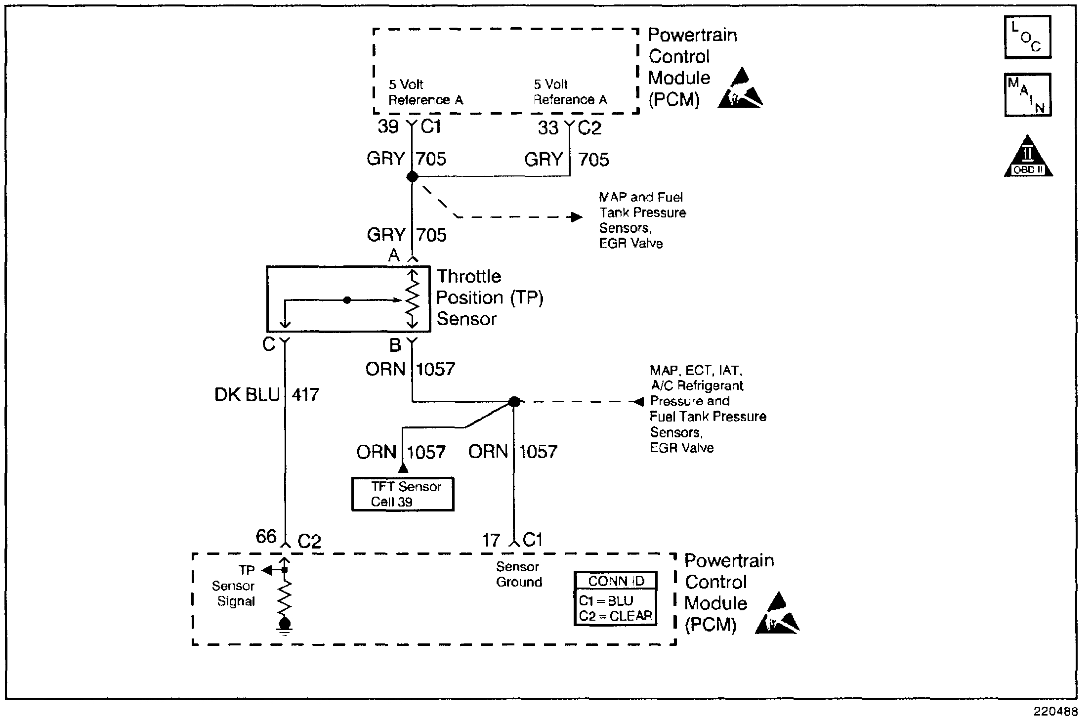

Here are the diagnostics. The attached pics are the actual flow charts. Let me know if this is something you are comfortable doing.

P0121
Vehicle ALL Diagnostic Trouble Codes ( DTC ) Testing and Inspection P Code Charts P0121
P0121
Diagnostic Chart
pic 1
Diagnostic Chart
pic 2
Wiring Diagram
pic 3
CIRCUIT DESCRIPTION
The Throttle Position (TP) sensor circuit provides a voltage signal that changes relative to throttle blade angle. The signal voltage will vary from less than 1 volt at closed throttle to about 4 volts at Wide Open Throttle (WOT).
The TP signal is one of the most important inputs used by the PCM for fuel control and most of the PCM-controlled outputs. The PCM monitors throttle position and compares actual throttle position from the TP sensor to a predicted TP value calculated from engine speed. If the PCM detects an out of range condition, DTC P0121 will be set.
CONDITIONS FOR SETTING THE DTC
^ No active TP sensor or Manifold Absolute Pressure (MAP) sensor DTC.
^ The engine is running.
^ MAP reading is below 55 kPa or above 70 kPa.
^ Predicted throttle angle is not close to actual throttle angle.
ACTION TAKEN WHEN THE DTC SETS
^ The PCM will illuminate the Malfunction Indicator Lamp (MIL) during the first trip in which the diagnostic runs and fails.
^ If equipped with traction control, the PCM will command the Electronic Brake and Traction Control Module (EBTCM) via serial data (CKT 800) to turn OFF traction control and illuminate the TRACTION OFF lamp.
^ The PCM will store conditions which were present when the DTC set as Freeze Frame and Fail Records data.
CONDITIONS FOR CLEARING THE MIL/DTC
^ The PCM will turn the MIL OFF during the third consecutive trip in which the diagnostic has been run and passed.
^ The history DTC will clear after 40 consecutive warm-up cycles have occurred without a malfunction.
^ The DTC can be cleared by using the scan tool Clear Info function or by disconnecting the PCM battery feed.
DIAGNOSTIC AIDS
Check for the following conditions:
^ Skewed Manifold Absolute Pressure (MAP) signal or faulty MAP sensor. An incorrect MAP signal may cause the PCM to incorrectly calculate the predicted TP sensor value during high engine load situations. Check for an unusually low MAP reading. This condition can cause DTC P0121 to be set.
^ Poor connection at PCM. Inspect harness connectors for backed out terminals, improper mating, broken locks, improperly formed or damaged terminals, and poor terminal to wire connection.
^ Damaged harness. Inspect the wiring harness for damage. If the harness appears to be OK, observe the Engine Coolant Temperature (ECT) display on the scan tool while moving connectors and wiring harnesses related to the sensor. A change in the display will indicate the location of the fault.
If DTC P0121 cannot be duplicated, the information included in the Fail Records data can be useful in determining vehicle mileage since the DTC was last set. If it is determined that the DTC occurs intermittently, performing the DTC P1122 and DTC P1121 Diagnostic Charts may isolate the cause of the fault.
See: A L L Diagnostic Trouble Codes ( DTC ) > P Code Charts > P1121
See: A L L Diagnostic Trouble Codes ( DTC ) > P Code Charts > P1122
TEST DESCRIPTION
The numbers below refer to the step numbers on the Diagnostic Table.
2. An incorrect MAP signal may cause the PCM to incorrectly calculate the predicted TP sensor value during high engine load situations. Check for an unusually low MAP reading. This condition can cause DTC P0121 to be set.
12. This vehicle is equipped with a PCM which utilizes an Electrically Erasable Programmable Read Only Memory (EEPROM). When the PCM is being replaced, the new PCM must be programmed. Refer to PCM Replacement/Programming.

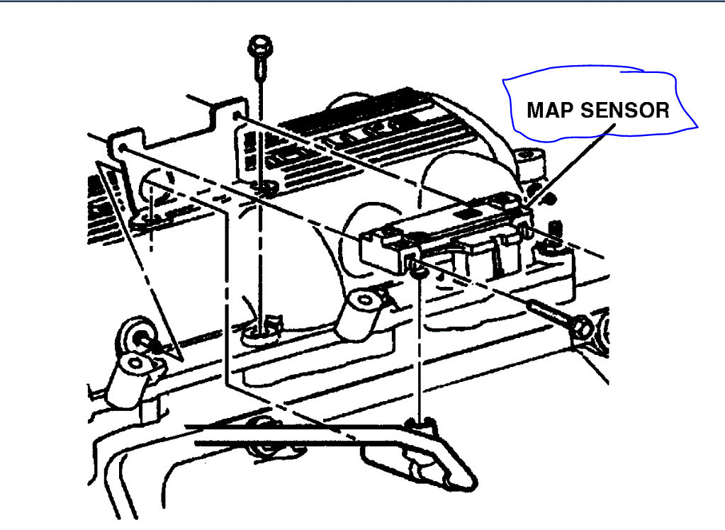

The last pic below shows the MAP sensor. Make sure there is vacuum to it and no leaks.
Let me know what you find.
