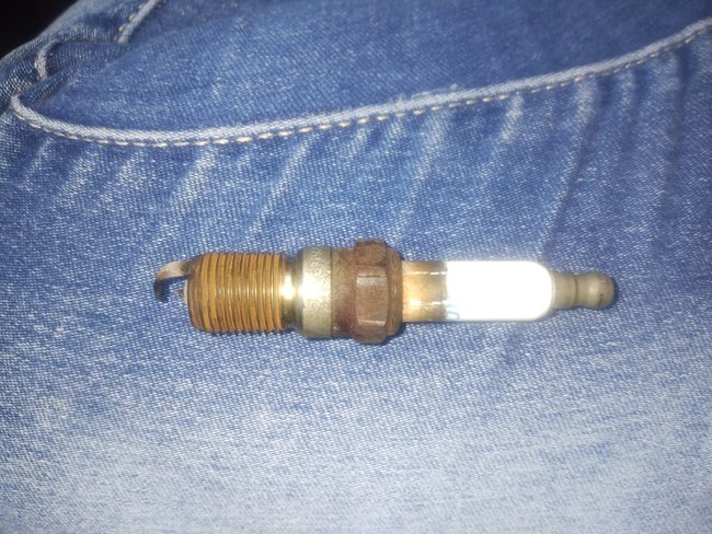

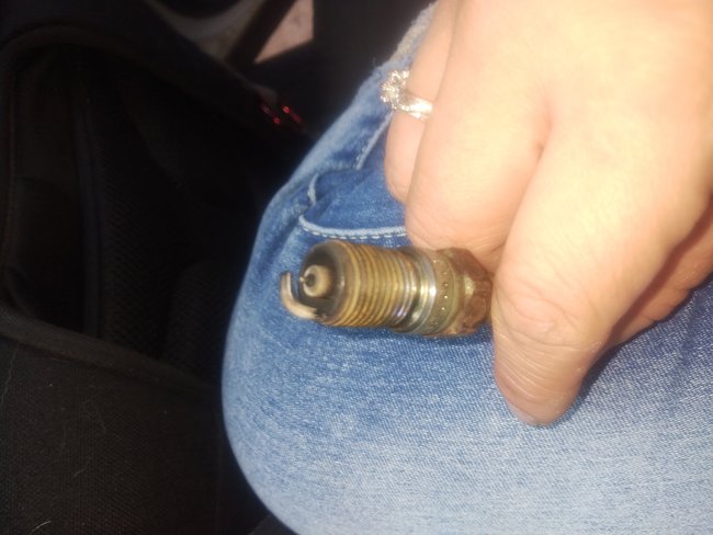

My truck has been acting up; sputtering not wanting to take off right. I went to go get it checked at AutoZone and they ran the codes and it was 303 cylinder 3 misfiring. my check engine lights on, my traction controls on, my stabilizer for tires is on. Airbag light is on. Now it is worse I want to stay running doesn't want to take off. change the spark plug and it was burnt and it's worst. Sprayed the intake. Q

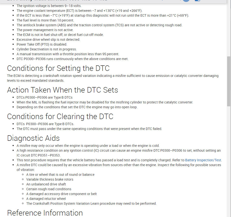

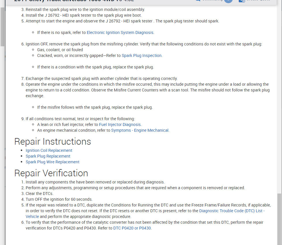

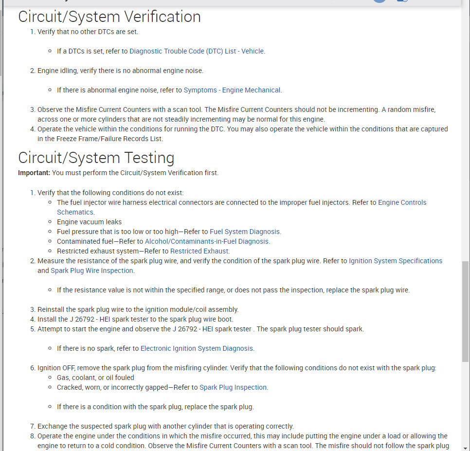

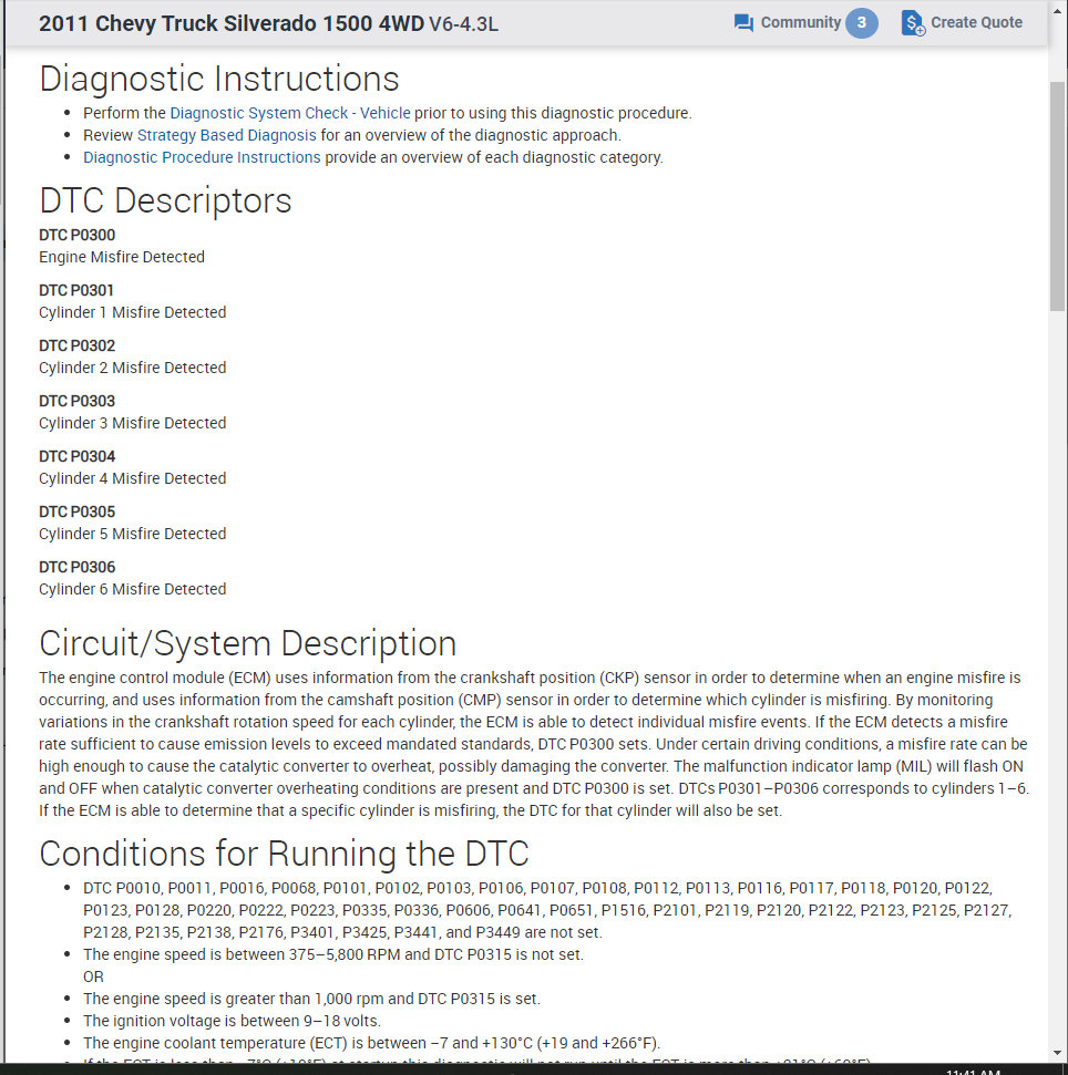

Hello, this is Jeff. Did all the other lights come on when the Check Engine Light came on? And was that Check Engine Light flashing when it was sputtering?

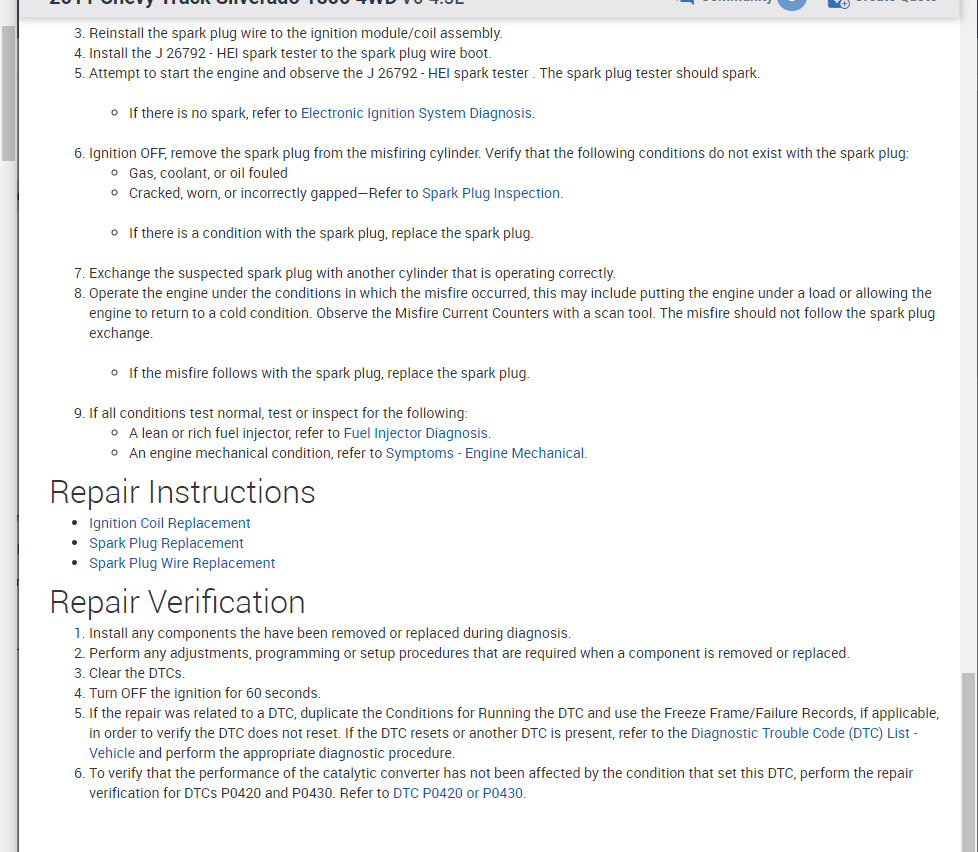

This sounds like you may have more than one issue but we need to start with the misfire code that you have. Two things to start with are replacing that spark plug and checking the fuel pressure.
Here are a couple guides that will help with this:

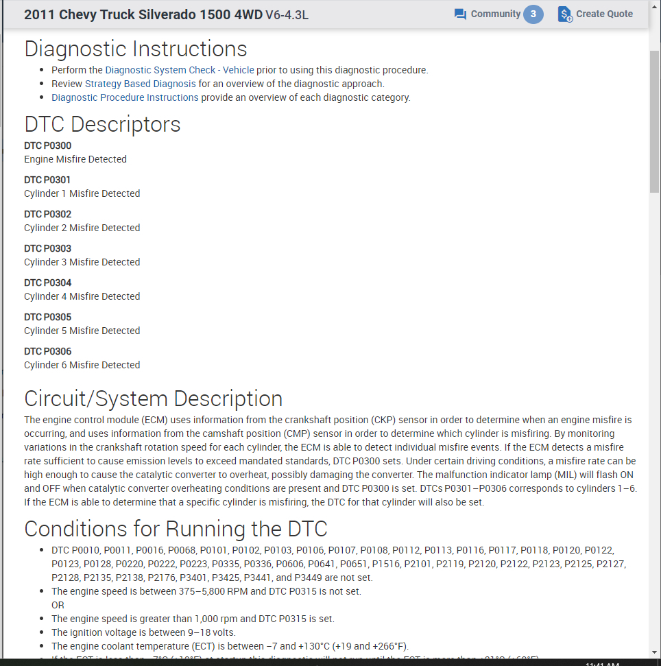

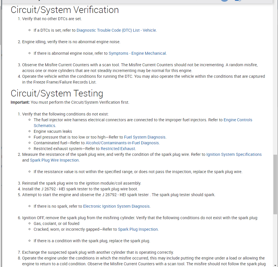

Below is a chart that will help with identifying issues with spark plugs and the process for this cylinder 3 misfire.
However, the sputtering points more to a fuel issue only because you don't have multiple cylinders with misfires. A single cylinder will cause a vibration and slightly less power but if it has considerably less power then that sounds like a fuel issue so we need to eliminate it.
Please let me know what you find. Thanks

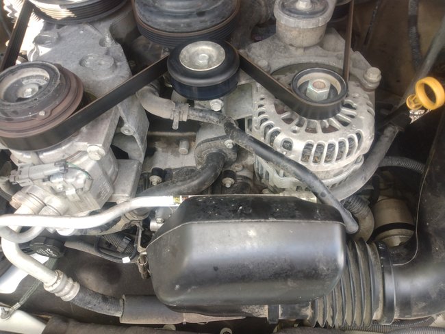

My check engine light came on first then the other ones. Yes it flashes when sputtering.not sure if the pictures help any.

It looks like the spark plugs need replacement. I would service the MAF and throttle bore as well. Here are guides to help us get the services done:
https://www.2carpros.com/articles/how-to-tune-up-a-car-engine
and
https://www.2carpros.com/articles/mass-air-flow-service

So I got my spark plugs replaced all of them, my throttle serviced and my plugs or wiring whatever the ones fixed and now my car is running like a champ. I just need to figure out how to take off my service tire monitor service and also my airbag light came on when all that was coming on. so other than that that's all that I had to do for it to work. thanks you guys.
