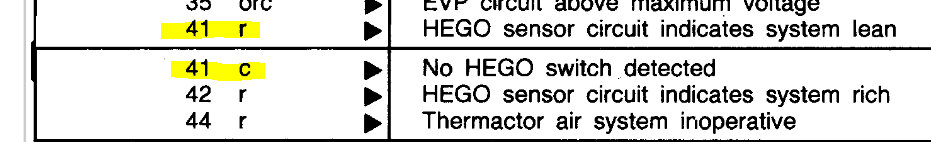

Do the same codes return if they are cleared? Also, code 95 indicates an open circuit to the fuel pump. However, if the fuel pressure remains consistent, that doesn't make sense. See pic 1.

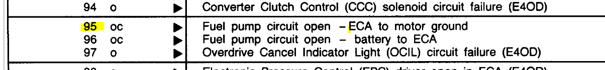

Code 41 could indicate a lean mixture, or the sensor is not responding. Have you also replaced or inspected the HEGO sensor? See pic 2
Let me know. Also, let me know if there are any exhaust leaks pre-catalytic converter.
