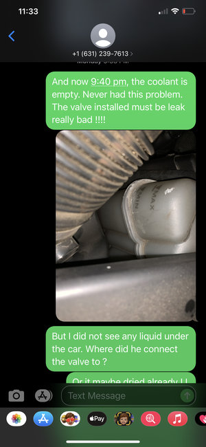

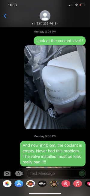

Hi. I brought my vehicle (listed above) in for a check engine light (the
car is still working perfectly fine). The dealer did a diagnose and multi-point
check, found everything okay, but 1 fault N509. So they replaced the valve
(4H0-121-671-D) and coolant (G-A13-774-1G-DSP) for $718.00. After driving
home, I check and found only half of the coolant left in the tank. 1 hour later,
the coolant tank is empty. There's no visible leak anywhere (must be internal
coolant leak). Next morning, the dealer towed my car back, check everything
okay, but there's air pocket in the engine (that's what they said). So they bleed it
out and refill the coolant. I drove home and the engine sounded louder than
usual. Next day while driving, I heard weird engine sounds like water running
and bubbling, then the engine stalled and shut off (the coolant level is okay,
battery and gas is full, no warning light). I tried to restart but it did not work ,
so I have to tow the car home (since the dealer is closed by that time). Next
morning, the car can start but made rattling sound, so I have it towed back to
the dealer. They checked and said the turbo were blown and asked me
$10,000.00 to fix it. They said the problem had nothing to do with their repair.
My car never had a single mechanic problem in 5 years and it has been
serviced timely all the time. Could anyone tell me what the dealer might do
wrong to blow my car turbo or it just happened ? Thanks a lot.

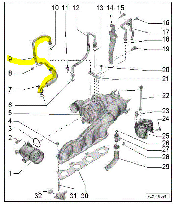

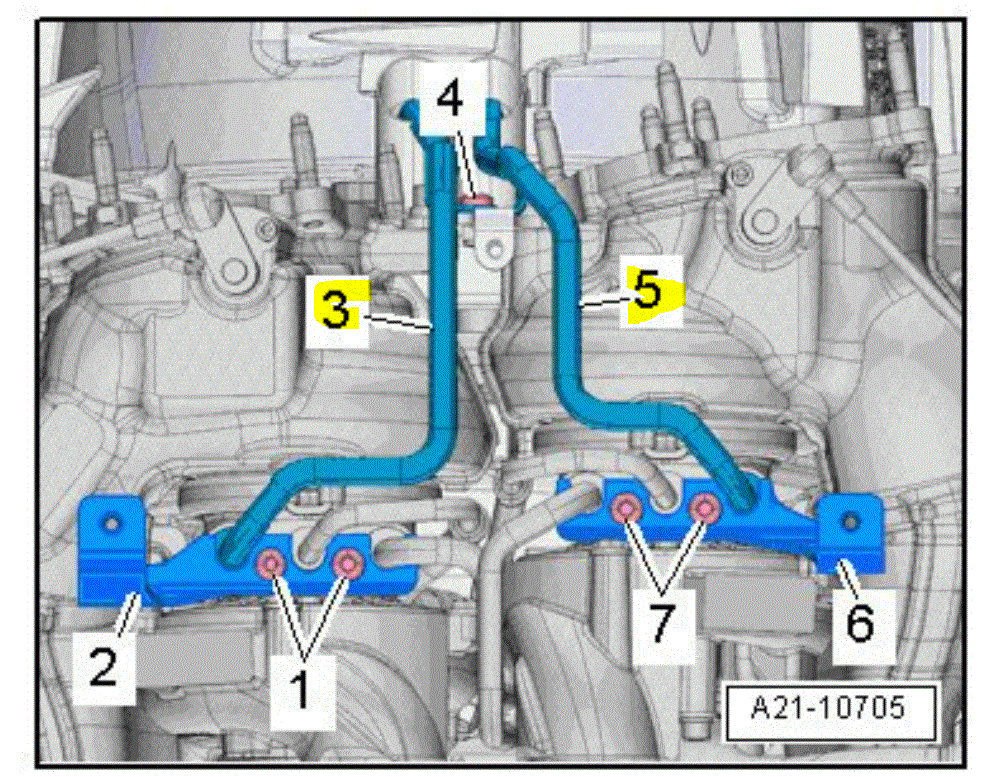

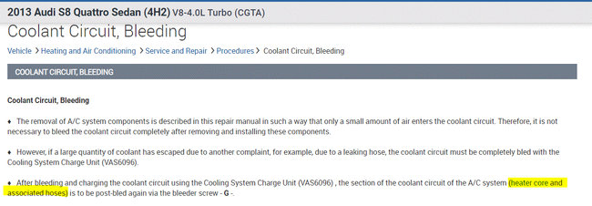

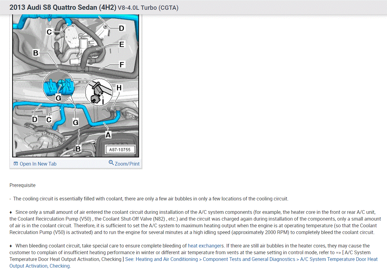

I believe the valve they replaced was the heater control valve. Basically, it diverts coolant to the vehicle's heater core allowing heat to enter the cabin.
That problem really has nothing to do with the turbo. However, what I feel may have caused the problem was a lack of coolant. If there was an air blockage preventing coolant from reaching the turbo, it may have caused damage.
If you look at pic 1, I highlighted a coolant line to one of the turbos. In pic 2, I highlighted the numbers identifying both coolant supply lines to the turbos.
Please understand that I can't guarantee this is the cause, but if it was low on coolant and not properly bled, it certainly could have caused an issue with overheating the turbos and causing damage.
Let me know if you have other questions or if I can help.

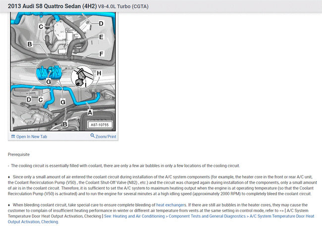

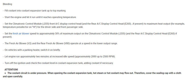

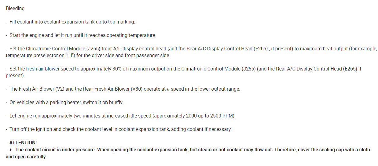

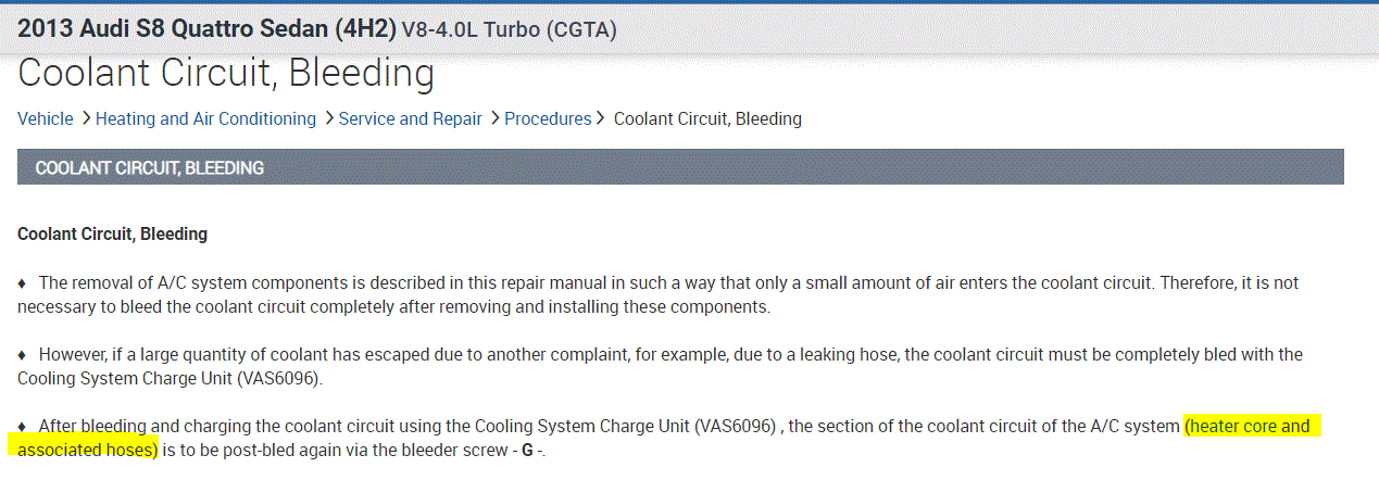

There is a procedure that needs to be completed if large amounts of coolant are lost. Take a look through the attachments below. They explain what needs to be done.
If there wasn't a coolant supply to the coolant-cooled turbo bearings, they would have been damaged.
When you open a cooling system, air enters it. When refilling the system, air can sometimes get trapped. That air can slow or prevent coolant flow. Oftentimes, it affects the heater. In this case, I feel it starved the turbos.
That is my theory at this point. Take a look through the procedure below and see if that was done.
