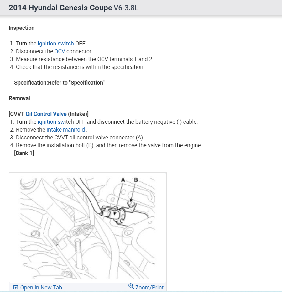

I have a 2014 Genesis Coupe. I got these codes and I’m wondering what needs to be fixed. Thank you
Apr 9, 2023 at 9:53 AM
  • 55,402 POSTS

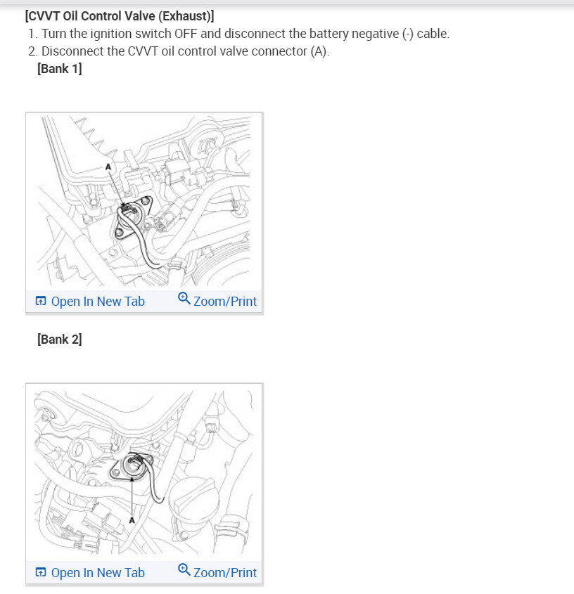

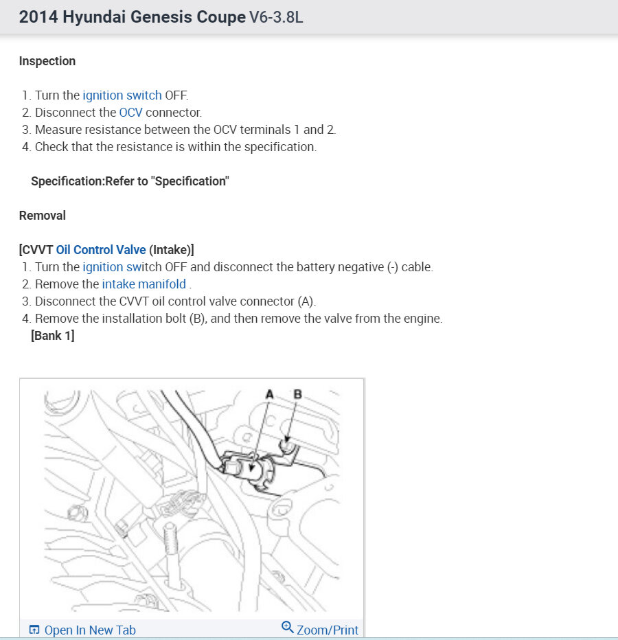

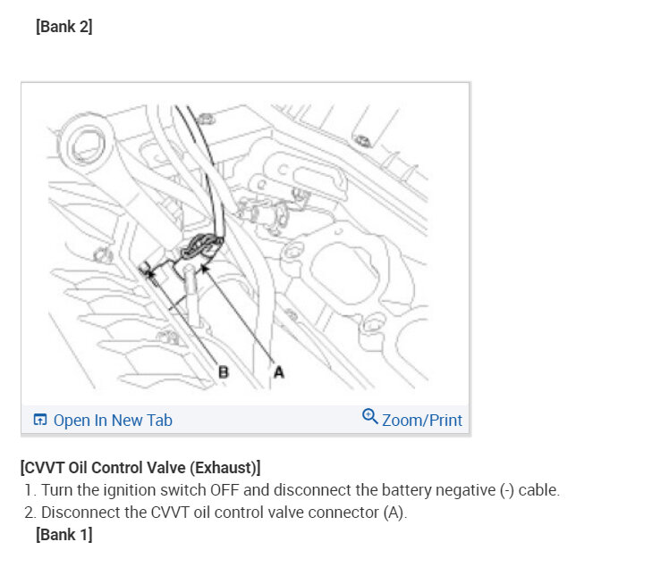

P0019 Crankshaft Position - Camshaft Position Correlation (Bank 2 Sensor B)
P0018 camshaft position sensor A for bank 2 does not correlate to the signal from the crankshaft position sensor.

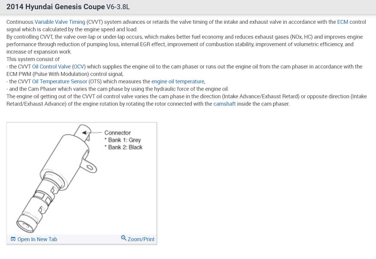

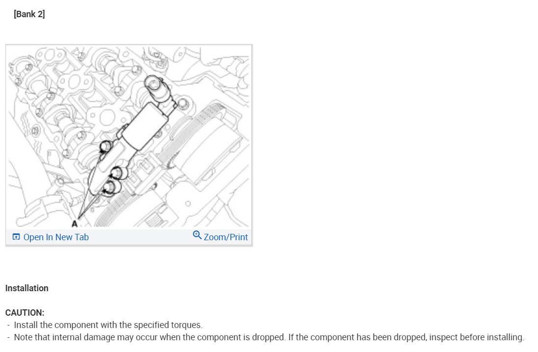

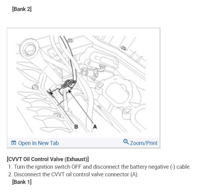

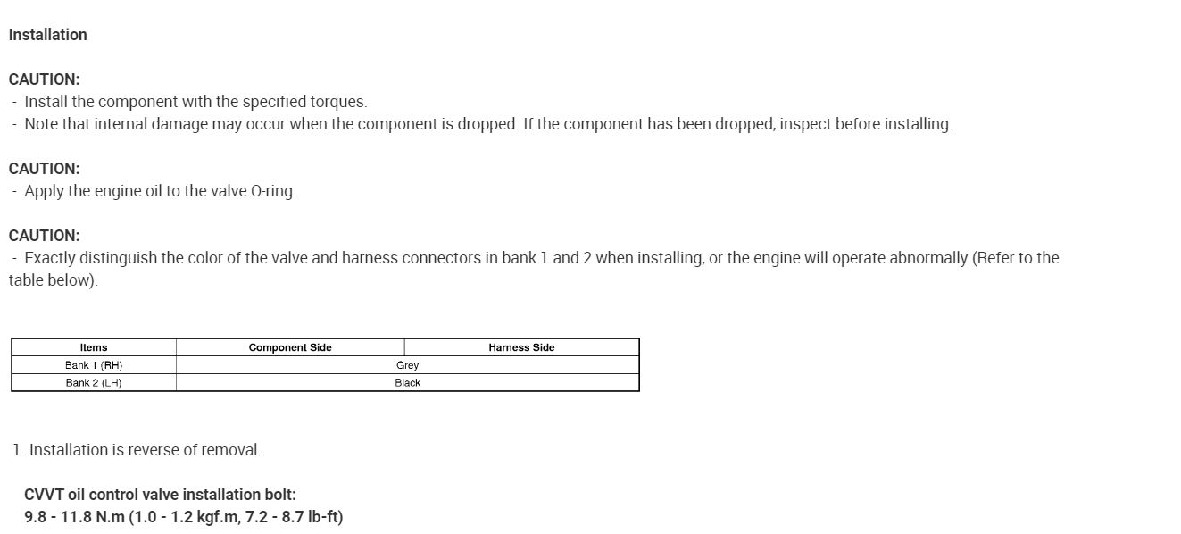

So, this means the camshafts position is not where it should be, 9 times out of ten the problem will be the camshaft actuator control valve is plugged or needs replace net, here is the location so you can remove it and inspect the oil screen at the base of the actuator and clean it. If the screen is clean, I would replace the actuator (bank 2) both banks are shows so make sure you do the correct actuator. Check out the images (below). Let us know what happens and please upload pictures or videos of the problem so we can see what's going on.

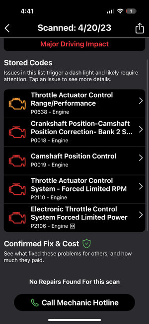

I’m starting to work on it and it’s the bank 2 sensor. Also, could you look at these other codes?
Apr 22, 2023 at 9:19 AM
  • 55,402 POSTS
Yes, this looks like two separate problems, please start a new thread for the throttle body codes. Please post your new question here, you must be logged in.

I removed it and replaced it. Still the same p0018 and p0019 code.

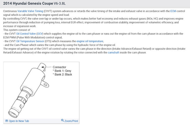

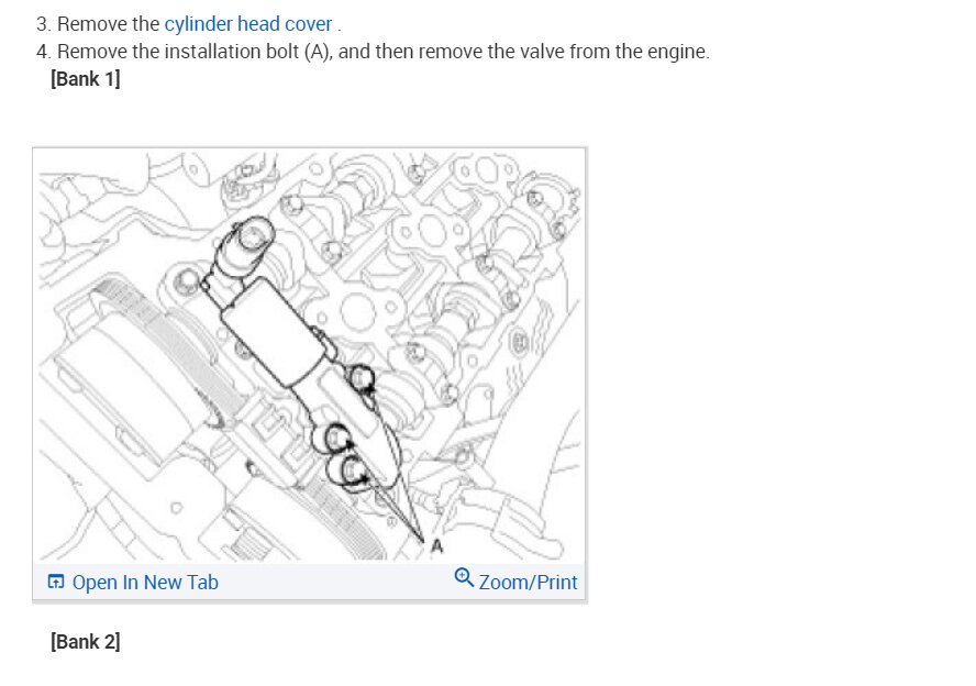

Did you clear the codes once the repair was done? Also, please make sure the engine oil is clean and full. Can I ask how the engine is running? Do you have power and a smooth idle? Let us know what happens and please upload pictures or videos of the problem so we can see what's going on. You may have a timing chain or VVT unit issue. This guide can help you see how the VVT system works:
https://www.2carpros.com/articles/how-camshaft-variable-valve-timing-works
