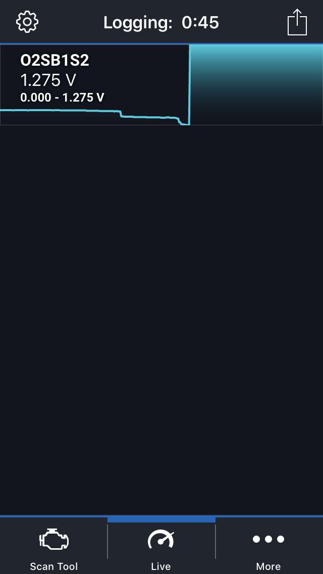

Hi , my car was doing well, but i scan the efficacy of catalytic converter using my own obd scan tool and showed sinusoidal wavy graph of s2 o2 sensor in bank one. so it is bad catalytic converter. i took it to one who assume that he can clean it. i cleaned it, but after one hour of driving check engine light come and a code P2096 appeared. i check it and obd tell it is a converter or o2 sensor problem. i removed the check engine light and i drive it again and the not appeared again. i plugged the live scan obd to see the voltage of o2 sensor S2 , and showed abnormal graph in which at begin low voltage then within seconds reach fixed high voltage? I change it from wavy line to fixed high voltage line, is this danger?
What can i do ? Is it urgent? I attached the new graph. please help what to do?

I forgot to mention that they cleaned it be removing it from car and then reattach it to car after water jet cleaning.

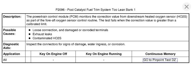

With the efficiency code, the converter cannot be cleaned. It must and I repeat, must be replaced. It is an indication of the precious metals inside are worn out and can no longer process the gasses to clean air.
There is no cleaning or any other service that can be done to the converter.
As far as the 2096, that is referring to the O2 sensor. The tech may have damaged it doing his cleaning especially if he used a wire wheel to clean the end of the sensor.

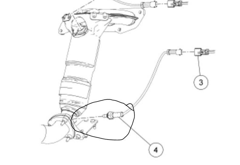

It is the downstream sensor or the one behind the catalytic converter.
Picture attached.

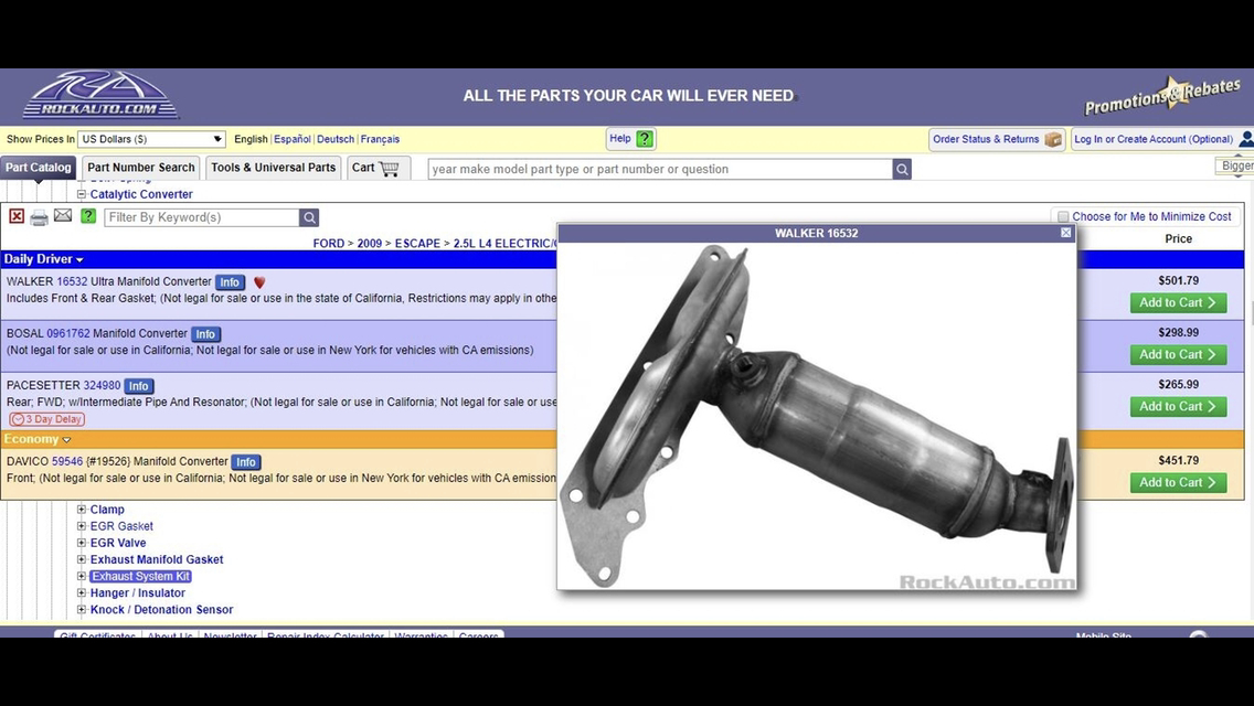

Does 6532 walker catalytic converter fit my car , i paid today 700 dollar as i foole pic u send 2 days ago , some sites told it fit 2008 not 2009 , please help
Oct 24, 2019 at 6:25 AM
BEBOBEBO
  • 116 POSTS
In eBay they said not fit. i followed this picture below to buy new catalytic. please can you tell if (6532 walker) catalytic converter can fit my car? the 2008 car resemble my car from outside but it is 2300 cc not like mine 2500 cc.
Thanks
Oct 24, 2019 at 6:29 AM
16532 is the converter for your car from Walker. Yes, it will fit.
