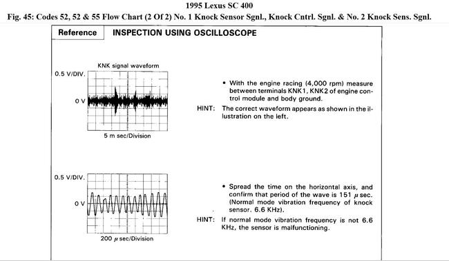

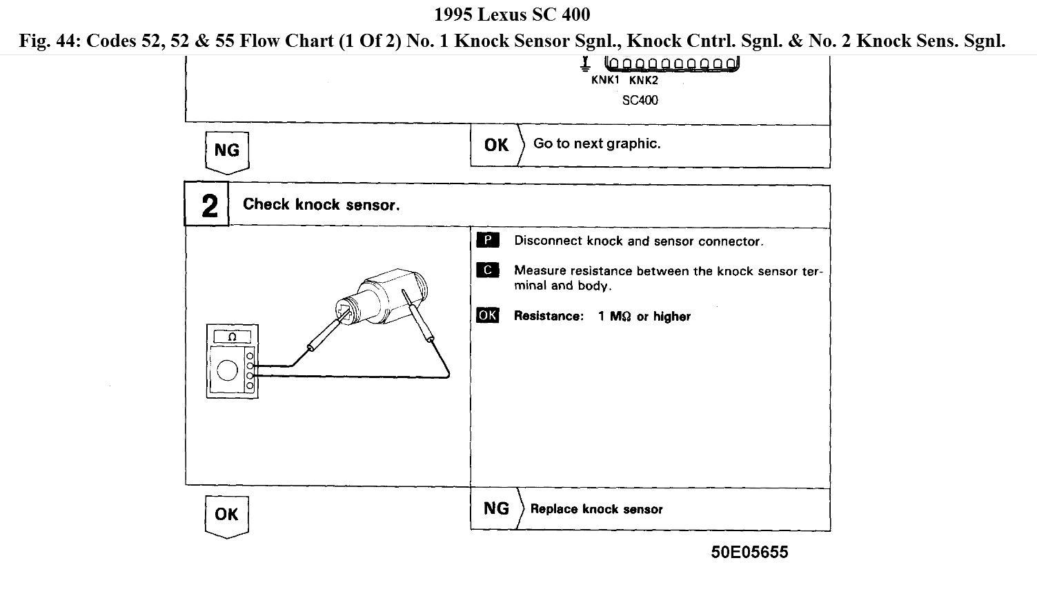

Is there a good way to check the knock sensors on a sc400 ?? they ohm out fine,, Now the car will BUCK and hesitate for a long time before the CEL goes on, I wonder if a little knock is causing the hesitation but it takes a BIG knock to set the light ??

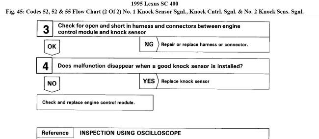

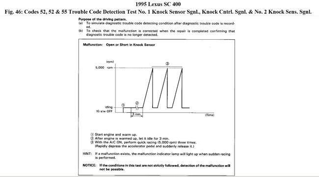

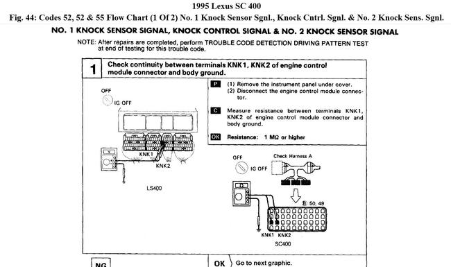

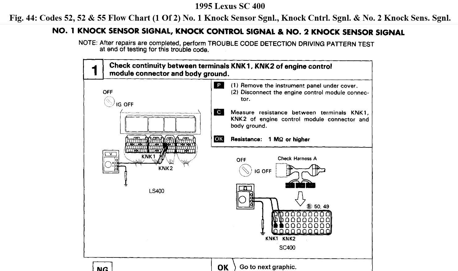

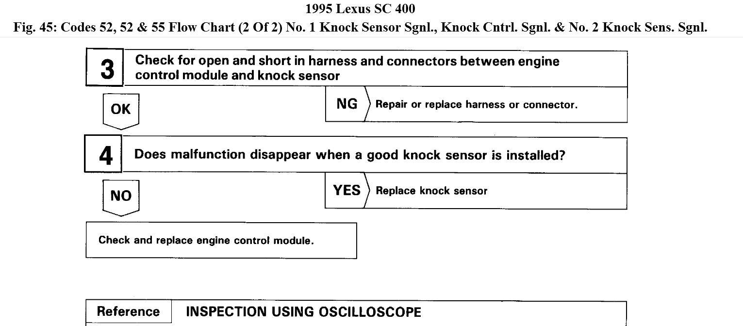

When trouble codes are present, you need to rectify it first. The basic procedure is to start with checking wire continuity between the sensor and ECM. Next is visual inspection of the sensor. If the plastic of the knock sensor has signs of overheating, there is no doubt about it being faulty.
If your vehicle had overheated previously, it would definitely kill the knock sensors.
If you want to fry the ECM, then you can try grounding it.
ECM would ignore signals from the knock sensor if it senses it is faulty and would retard ignition timing. If the code is being triggerred, it is not due to other causes but only the knock sensor and/or its circuit.

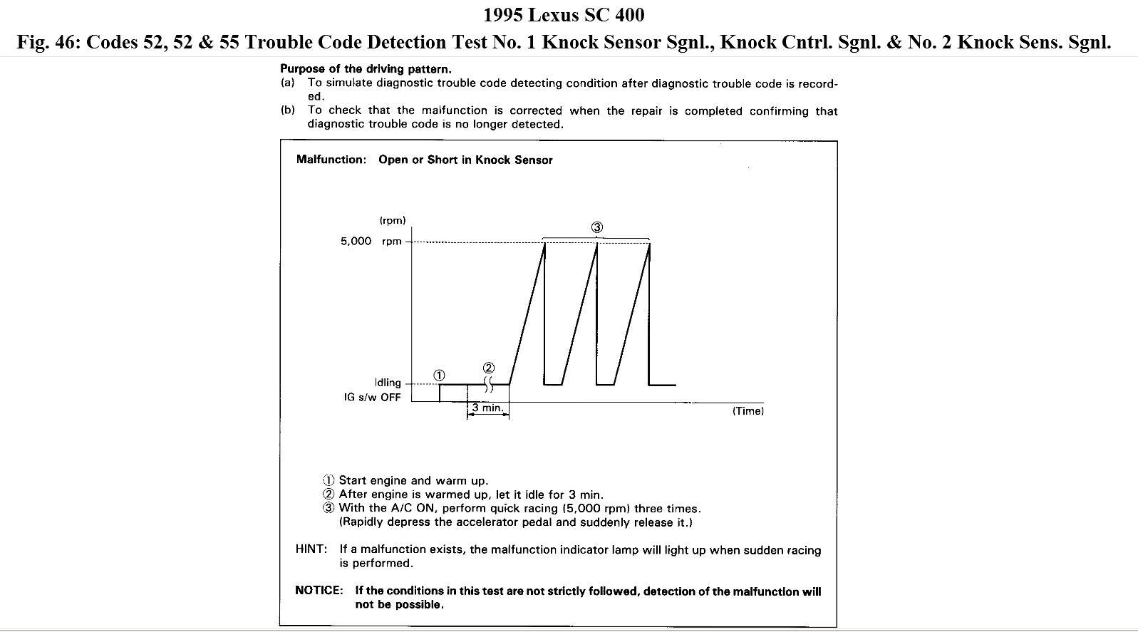

See if the following are of any help.
