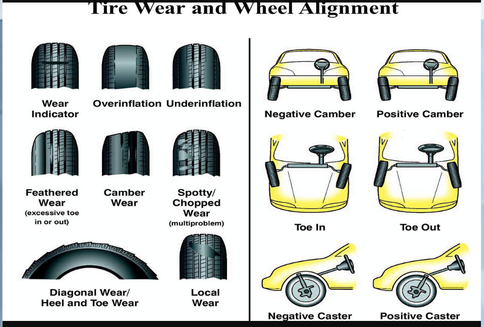

Below is a chart that will help with tire issues.
Let us know what you find with this.
