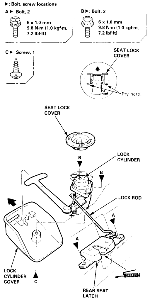

The rear seat is suppose to fold down giving access to trunk. There are two options, one insert key into slot at top of seat and turn clockwise. Two, open trunk and pull latch. I have tried both of these with no results. Do you have any suggestions as to how to get the back seat to fold down?
Thursday, August 27th, 2020 AT 11:42 AM (Merged)
STEVE W.
  • 13,066 POSTS
If the seat has not been folded down before it is possible the pivots have rusted and will not allow it to move. Or the latch is not releasing fully. Does it feel/sound like the latch is releasing when you turn the key? Does it feel any different if you push in on the seat as you turn the key?
The attached shows the latch assembly. The cover in the trunk area comes off with a screw. You could remove the cover and see if the latch rod and the rest of the parts are moving when you actuate the latch. It may just be corroded or possibly disconnected.
If the pivot at the bottom is moving and the lock rod is moving, take a pair of pliers and pull the lock rod a bit, it is possible it has gotten bent enough that it does not release the latch.
Good luck, please reply back with what you find.

You are more than likely right about it being stuck, since I cannot even get the key to turn. The latch in the trunk pulls without any problem. Maybe I need someone to pull on seat while I pull the latch. I am going to remove the screw and take a look inside, I will let you know how things go. Thanks so very much for your help and diagram.

I was able to get the seat to fold down with the help of a friend, My friend pulled it down while I was holding latch in trunk.
STEVE W.
  • 13,066 POSTS
Did you pull the cover and check the linkage? Did it go down easy once you got the latch released?
