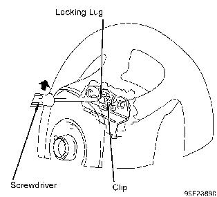

How do I replace the steering wheel

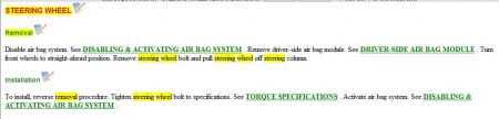

It may be hard to read. Basically using a screwdriver in those spots, remove the air bag assembly with the steering wheel straight ahead(very important) remove he nut in the middle and remove the wheel
