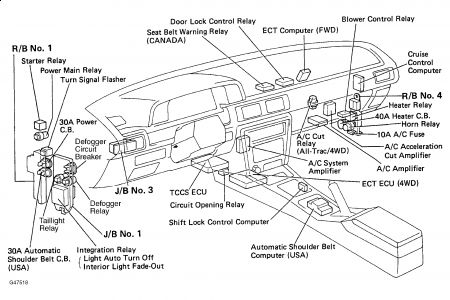

Check and test the power fuse 30amp and power main relay
+1
Friday, February 19th, 2021 AT 7:04 PM (Merged)
LFUL2441
We here is that 30amp fuse an the power rely located at on the car.
+1
  • 75,992 POSTS
Its inside junction block no.1 left side of instrument panel. Also check main ground at master switch white and black wire and ground point G200 left kick panel

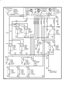

BMRFIXIT
  • 19,053 POSTS
https://www.2carpros.com/forum/automotive_pictures/99387_Graphic1_611.jpg
https://www.2carpros.com/forum/automotive_pictures/99387_Graphic2_291.jpg

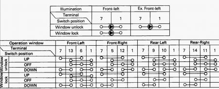

MERLIN2021
  • 17,250 POSTS
A car this old, usually turns out a few wires in the harness that runs from the door to the inside of the car break from bending all these years, if nothing found, if windows work at other switches, switch is probably faulty. Test switch continuity as shown.
https://www.2carpros.com/forum/automotive_pictures/62217_cama_1.jpg
https://www.2carpros.com/forum/automotive_pictures/62217_camb_1.jpg
