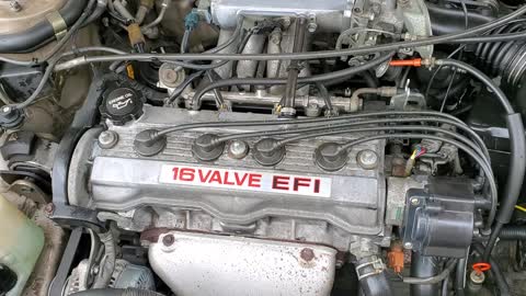

Here are the two videos you requested:
Tuesday, December 15th, 2020 AT 8:33 AM (Merged)
DAVIDSCHAFFER
  • 7 POSTS

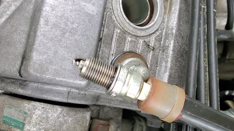

I dont think I had the spark plug grounded well for that video I apologize but it normally is bright and white.
  • 108,517 POSTS
It sound normal cranking except at the very start. By any chance, did you turn the distributor? Does it always act the same way?
At the start of your video, it sounded like there was a timing issue, but it went away. To me, it sounded like it was firing at the wrong time. After that, I didn't hear any firing.
Let me know,

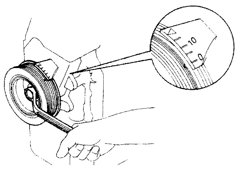

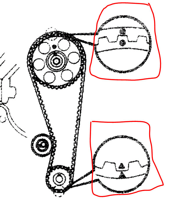

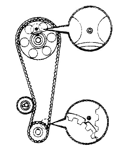

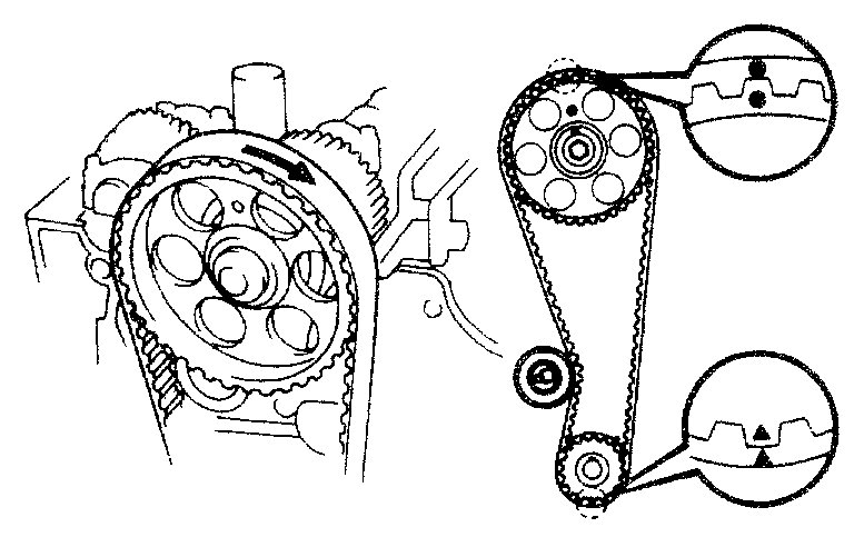

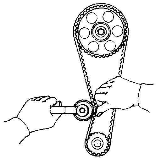

If you look at the first picture below, it shows the timing marks. If you are replacing the belt, here are the directions for removal and replacement. All pics correlate with the directions.
___________________________

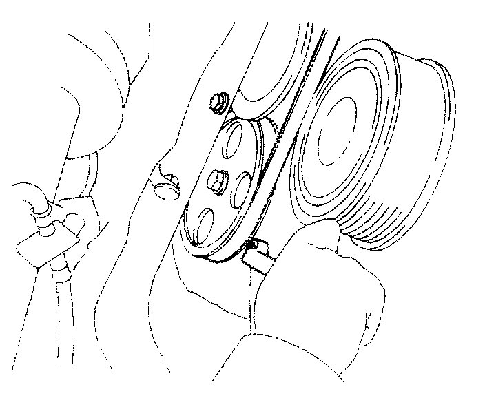

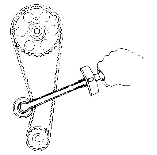

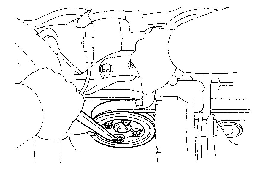

4. Loosen water pump pulley bolts and remove alternator drive belt.
Pic 3
(a)Stretch the belt tight and loosen the water pump pulley bolts.
Pic 4

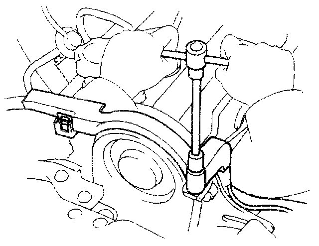

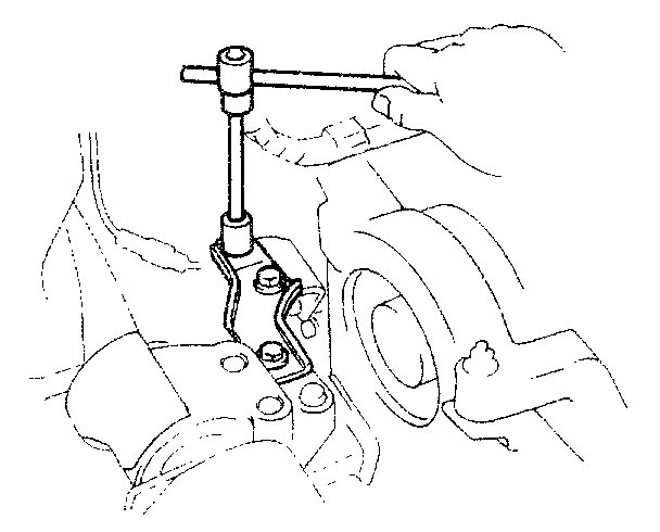

(b)Loosen the pivot nut and adjusting bolt, and remove drive belt.
Pic 5

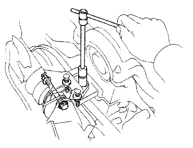

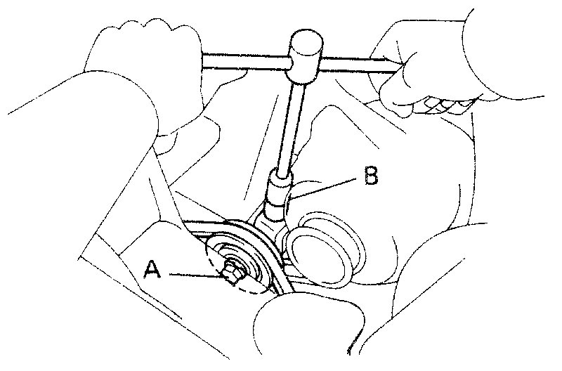

5. On vehicles with A/C, remove A/C compressor drive belt.
(a)Loosen the idler pulley mounting bolt A.
(b)Loosen the adjusting bolt B and remove the drive belt
pic 6

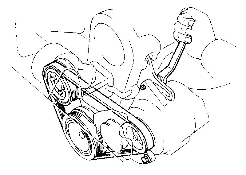

6. On vehicles with PS, remove PS pump drive belt.
(a)Loosen the pivot and lock bolts.
(b)Swing PS pump toward the engine and remove the drive belt.

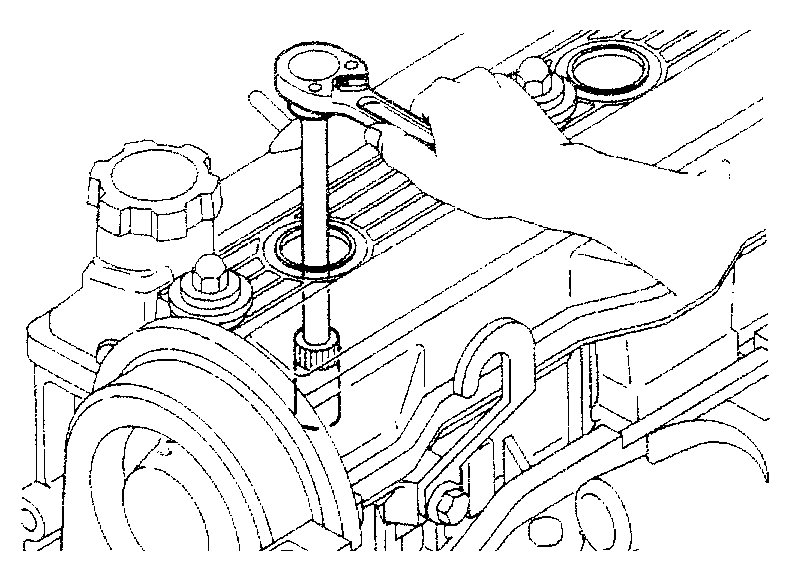

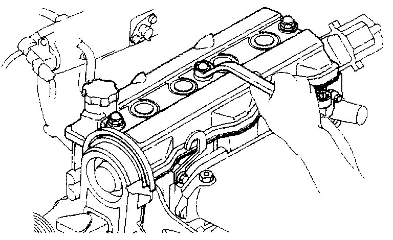

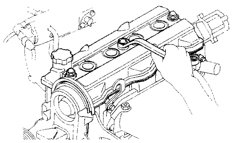

9. Remove cylinder head cover.
(a)Disconnect the PCV hoses from the cylinder head cover.
(b)Remove the three cap nuts, grommet and cylinder head cover with the gasket.

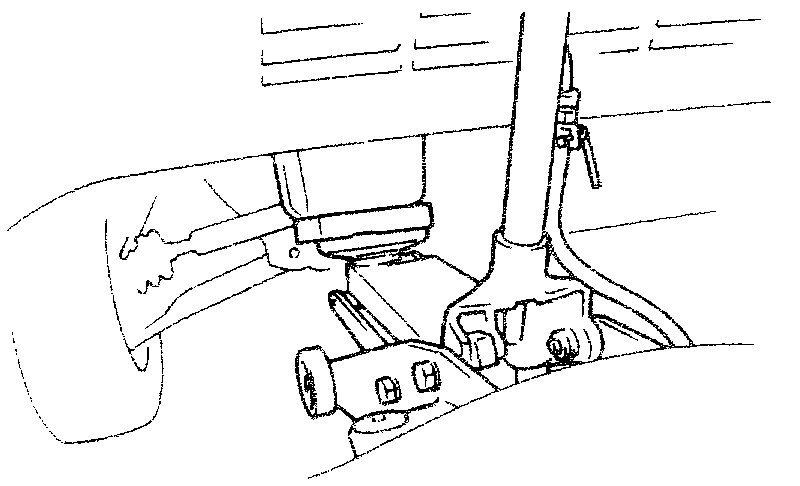

(a)Set the jack to the engine.
HINT: Place a wooden block between the jack and engine.

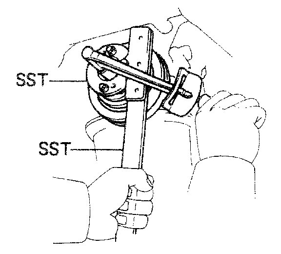

12. Remove water pump pulley.

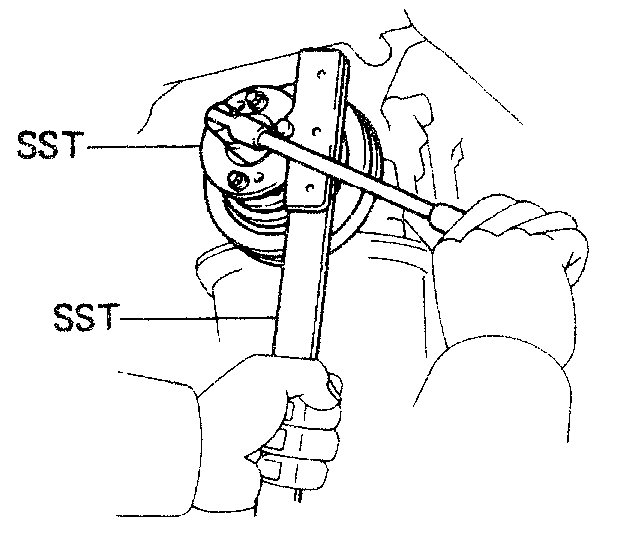

13. Remove crankshaft pulley.
Pic 14

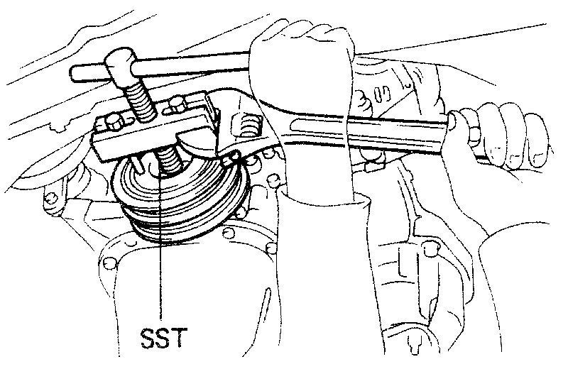

(a)Using SST 09213-14010 and 09330-00021 to hold the crankshaft pulley, remove the pulley bolt.
Pic 15
(b)Using SST 09213-31021, remove the pulley.

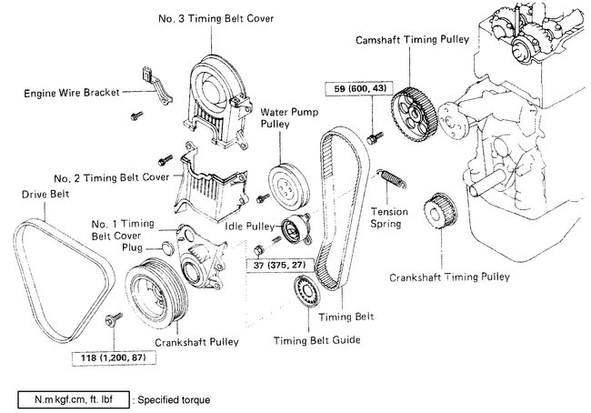

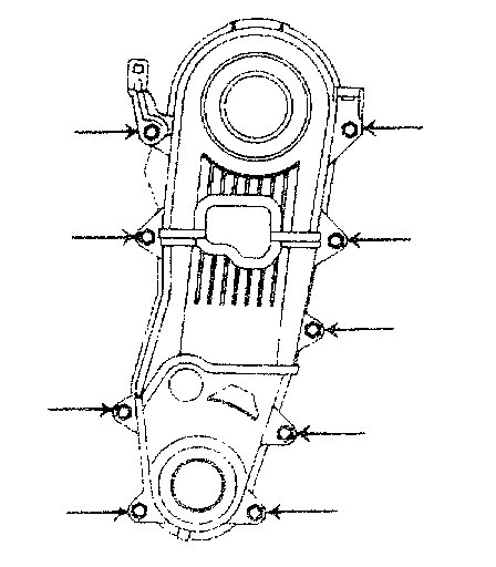

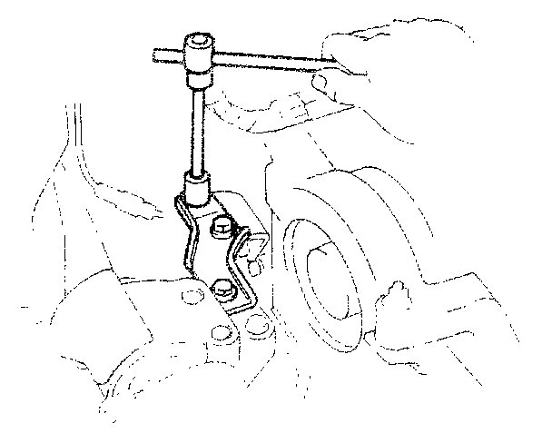

14. Remove timing belt covers.
Remove the nine bolts engine wire bracket and timing belt covers.
15. Remove timing belt guide.
16. Remove timing belt and idler pulley.
Pic 17
HINT: If reusing the timing belt, draw a direction arrow on the belt (in direction of engine revolution), and place matchmarks on the pulleys and belt as shown in the Illustration.
Pic 18

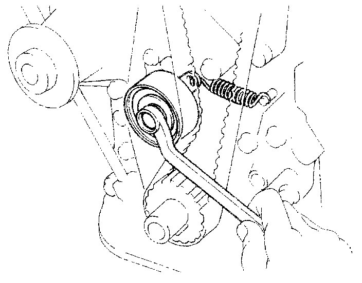

(a)Remove the bolt, idler pulley and tension spring.
(b)Remove the timing belt.

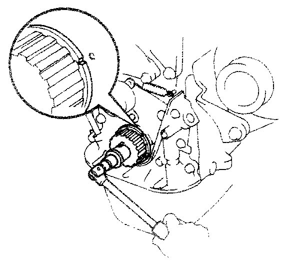

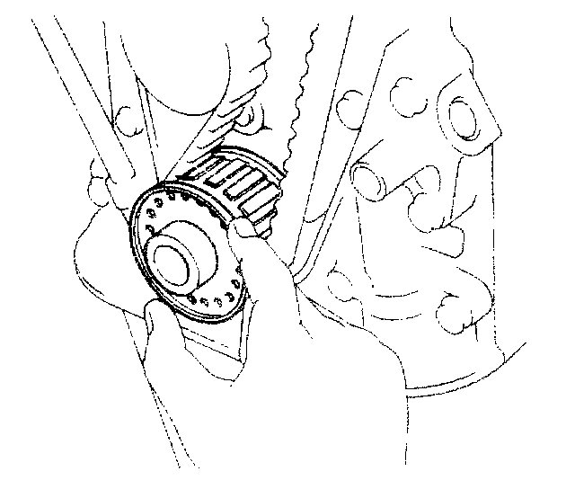

17. Remove crankshaft timing pulley.
Pic 19

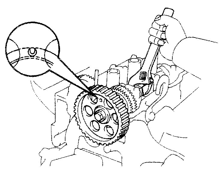

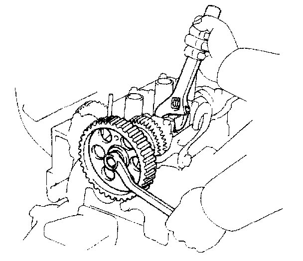

18. Remove camshaft timing pulley.
Hold the hexagonal head wrench portion of the camshaft with a wrench, and remove the bolt and timing pulley.
NOTICE: Be careful not to damage the cylinder head with the wrench.

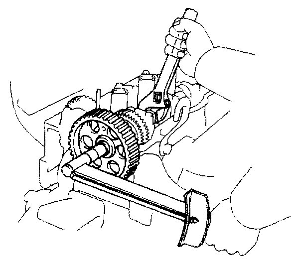

1. Install camshaft timing pulley.
(a)Align the camshaft knock pin with the knock pin groove of the pulley, and slide on the pulley.
(b)Temporarily install the timing pulley bolt.
Pic 21
(c)Hold the hexagonal wrench head portion of the camshaft with a wrench, and tighten the timing pulley bolt.
Torque: 59 N.M (600 kgf. Cm, 43 ft. Lbf)

2. Install crankshaft timing pulley.
(a)Align the pulley set key with the key groove of the pulley.
(b)Slide on the timing pulley, facing the flange side inward.

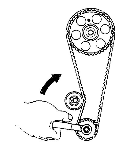

(c)Using the crankshaft pulley bolt, turn the crankshaft and align the timing marks of the crankshaft timing pulley and oil pump body.
Pic 24

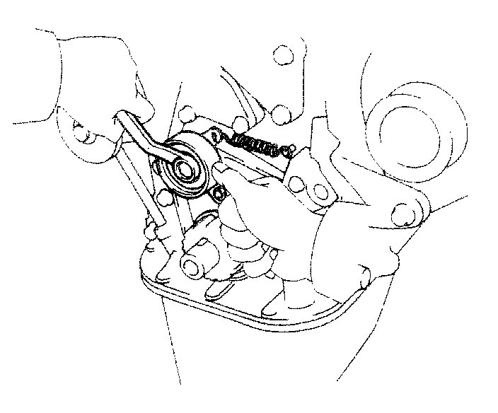

3. Temporarily install idler pulley and tension spring.
(a)Install the idler pulley with the bolt. Do not tighten the bolt yet.
(b)Install the tension spring.
(c)Push the pulley toward the left as far as it will go and tighten the bolt.
4. Install timing belt.
NOTICE: The engine should be cold.
Pic 25

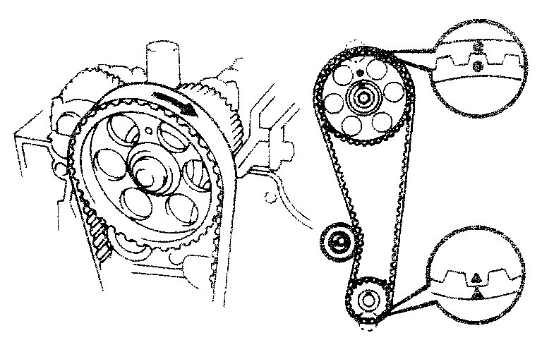

HINT: If reusing the timing belt, align the points marked during removal, and install the belt with the arrow pointing in the direction of engine revolution.
5. Check valve timing and timing belt tension.
Pic 26
(a)Loosen the timing belt idler pulley mounting bolt.
Pic 27
(b)Temporarily install the crank pulley bolt and turn the crankshaft two revolutions from TDC to TDC.
HINT: Always turn the crankshaft clockwise.
Pic 28
(c)Check the valve timing.
Check that each pulley aligns with the marks as shown in the illustration.

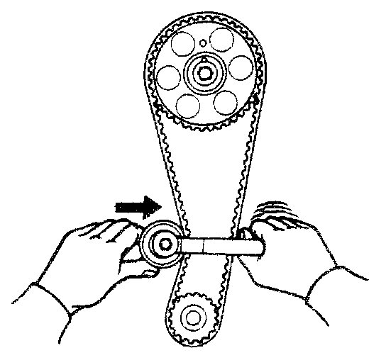

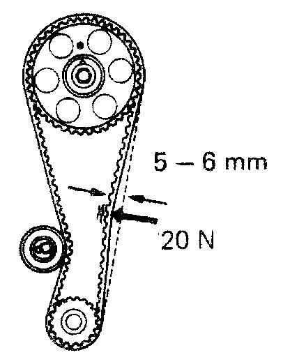

(f)(Reference) Measure the timing belt deflection as shown in the illustration.
Timing belt deflection: 5 - 6 mm (0.20-0.24 in.) At 20 N (2 kgf, 4.4 lbf)
pic 31
(g)If the measured value is not within standard, readjust with the idler pulley.

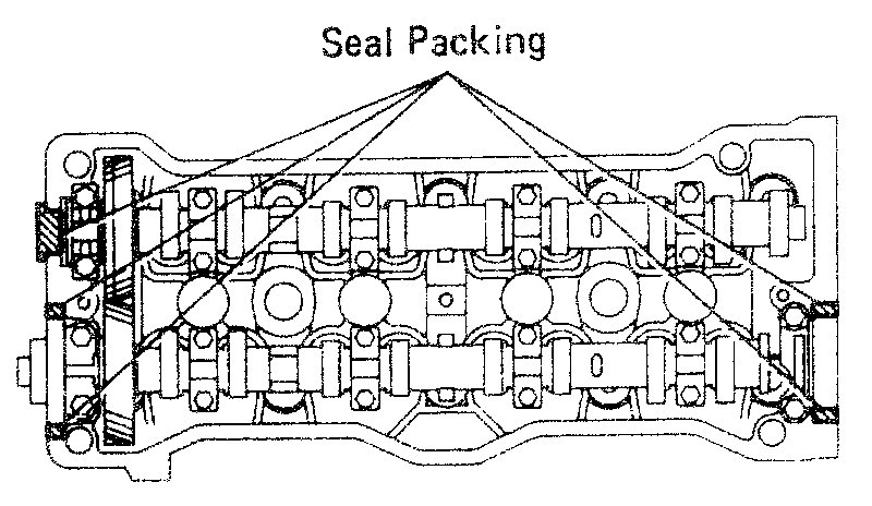

11. Install cylinder head cover.
Pic 37
(a)Apply seal packing as shown in the illustration.
Seal packing: Part No. 08826-00080 or equivalent
HINT: Clean the indicated portions by removing the original sealant before recoating.

18. Tighten water pump pulley bolts.
19. Install washer tank.
20. Install RH engine under cover.
21. Install RH front wheel.
_____________________________________________
I hope this helps. Let me know if you have questions or need help. Also, if you have a chance, let me know how things turn out for you.
DAVIDSCHAFFER
  • 7 POSTS
Thank you very much for your help. We changed out the timing belt yesterday and it started right up. The timing belt ended up jumping almost 5 teeth. Thank you for pointing us in the right direction and checking the alignment of it. We assumed that since it was turning the cam that the belt was good but didn't realize about it jumping teeth. Now it just appears that the alternator is not charging at all so on to the next thing, lol.
