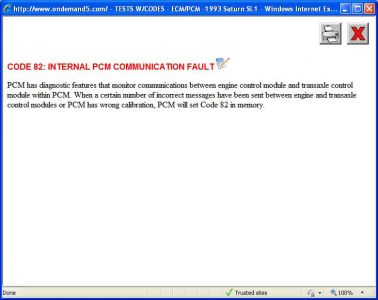

The exact display is;
The code is 82. According to, Chilton's 91-93 repair manual, that is "PCM internal communication fault".
As far as checking the A/C clutch, I haven't yet. Next time I'm out at the car, I'll do that. If the car is off, and the A/C on, there's no rattle. Only rattles in gear, idling, with A/C on.

https://www.2carpros.com/forum/automotive_pictures/416332_1993_sl1_code_82_1.jpg
I'm sorry i must have been spacing out last time i looked for that code and couldn't find it lol.It happens to the best of us.Your right it say's communication between tcm and ecm internal fault.There isn't alot of information on that code it just say's the pcm has wrong calibration.If you haven't had your pcm calibration updated lately then i would say that wouldn't be possible.You could go try to have your pcm calibrated with the lastest software and if that doesn't work then look's like your looking at replacing the pcm.Since it's a internal failure that's really the only thing it could be.

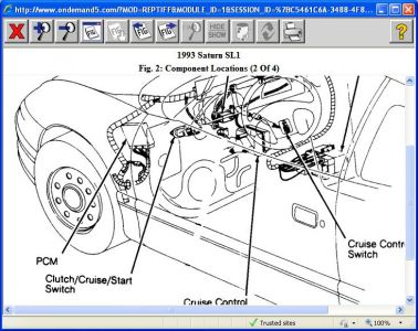

Wow! Thanks for the heads up! I didn't know it was that easy of a fix. For some reason, I was under the impression the PCM was located in or around the engine.
Is it possible for you to link me to an image(s) that show the location of the PCM so I know what I'm looking for?

https://www.2carpros.com/forum/automotive_pictures/416332_1993_SL1_pcm_location_1.jpg
There's a diagram of where it is.Auto zone has it for 216 you would have to order it i don't know if there programed you would have to shop around or you would have to go to a chevy dealer to have it programed.Unless you have a saturn dealer still open by you.Or you could look on ebay for a used one or pick part.
