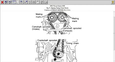

I was wondering if I can get some help on how to change out a timing belt

1.8L or 2.0L engine? BTW you have a timing chain not a belt

I mean chain I am half a sleep it is 1.8L

Put engine no.1 piston on its compression and align all the sprockets as you see below
